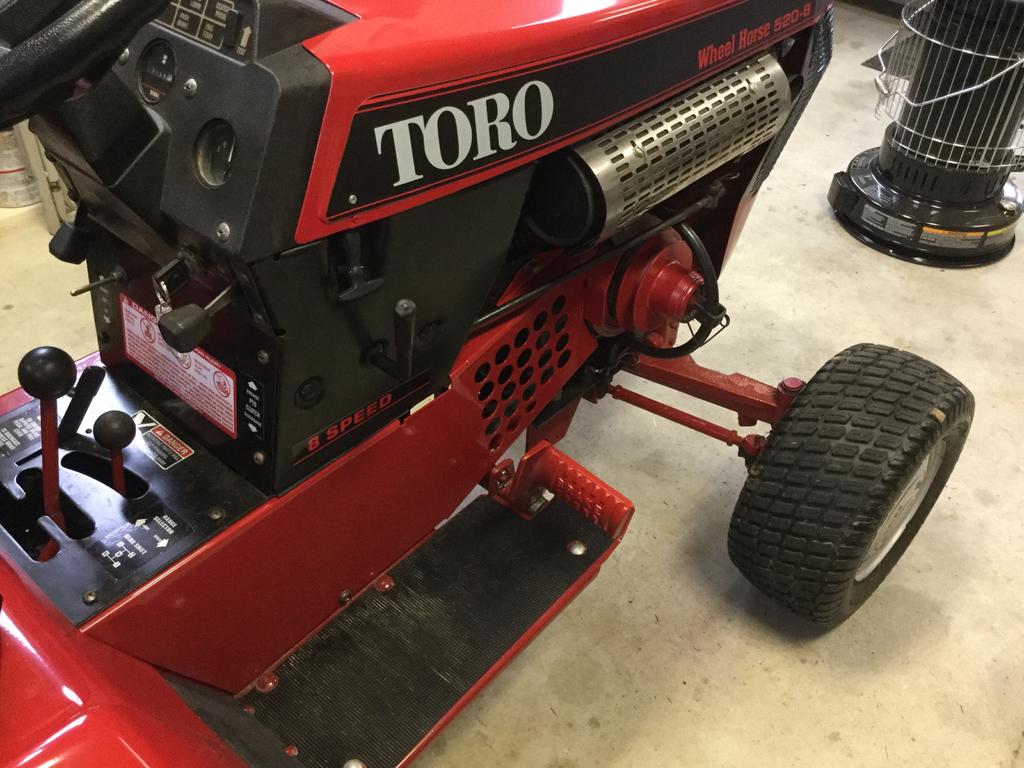

richmondred01 2,392 #1 Posted April 2, 2019 I went with a different design on this 520. I’m not sure which one I like better. What say you? 6 1 Share this post Link to post Share on other sites
AHenry014 128 #2 Posted April 2, 2019 I like the slots better, matches the slots in the exhaust heat shield and looks less out of place. 3 Share this post Link to post Share on other sites
WHX?? 58,052 #3 Posted April 2, 2019 But both look pretty clean. What did you use to punch them? Share this post Link to post Share on other sites
richmondred01 2,392 #4 Posted April 2, 2019 (edited) The pattern is laid out and each hole is drilled with an industrial diamond hole saw. Edited April 2, 2019 by richmondred01 1 Share this post Link to post Share on other sites
dkg520 531 #5 Posted April 2, 2019 Both look great! Share this post Link to post Share on other sites

kasey54 305 #7 Posted April 2, 2019 Id have to toss a coin. I like them both a lot. Share this post Link to post Share on other sites
JAinVA 4,638 #8 Posted April 3, 2019 Both look equally good.I took mine one step further and sawed off the guard mount.This actually decreases blockage more than the solid belt guard because of the deflector under the cylinder. 1 1 1 Share this post Link to post Share on other sites

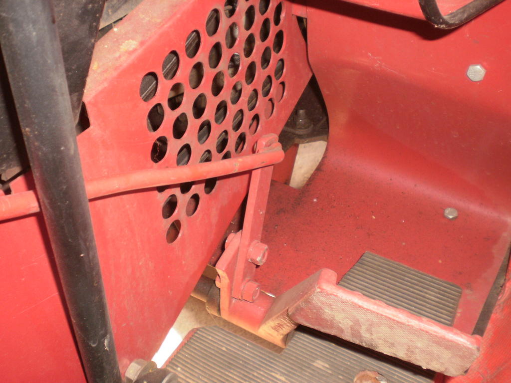

Ed Kennell 47,254 #9 Posted April 3, 2019 I drilled mine. If I had the tools, I would have punched louvers and deflected the heat to the rear. With the holes as they are, the temp in the cab stays 30 degrees warmer than the outside temp. 2 2 Share this post Link to post Share on other sites

richmondred01 2,392 #11 Posted April 3, 2019 I agree. I have at least 8 belt covers. I can always switch back an forth. i may make a few more with different styles and patterns. 3 Share this post Link to post Share on other sites

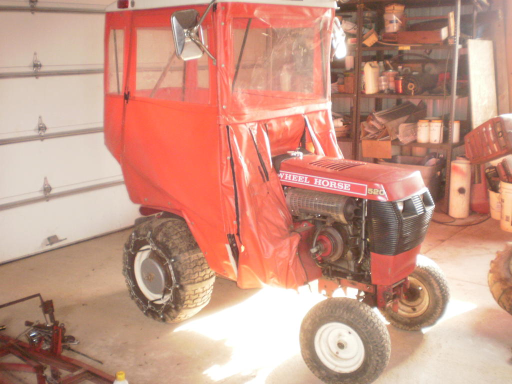

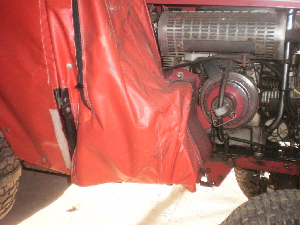

Ed Kennell 47,254 #17 Posted April 4, 2019 Here is a pic of my vented belt guard, the heat collector, and the F/R foot control pedal. All necessities for a snow machine. The cab stays 30 degrees warmer than outside temp. I am removing the blower and installing a 48" blade as I haven't used the blower for 3 years....next winter ????? 1 Share this post Link to post Share on other sites
