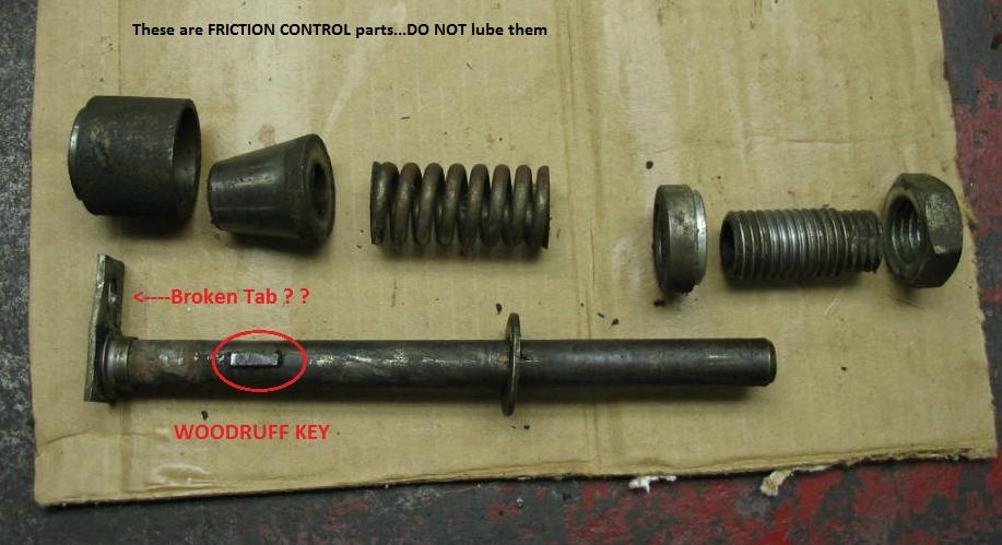

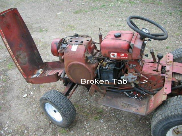

daveoman1966 3,884 #6 Posted April 2, 2019 Did the motion control lever jump around before...? If so, there MAY be an issue of a broken weldment on the shaft that the friction components fit on. Look a the left side of the hoodstand and see if this weld is broken. This pic is a C-160 but the suspect weld is the same as the Charger. Here are the components of the friction motion control system. DO NOT lube anything here...just clean out any old oil / grease or debris. 2 Share this post Link to post Share on other sites

bottjernat1 2,196 #8 Posted April 3, 2019 13 hours ago, daveoman1966 said: Did the motion control lever jump around before...? If so, there MAY be an issue of a broken weldment on the shaft that the friction components fit on. Look a the left side of the hoodstand and see if this weld is broken. This pic is a C-160 but the suspect weld is the same as the Charger. Here are the components of the friction motion control system. DO NOT lube anything here...just clean out any old oil / grease or debris. I will check that out to see. it has been this way ever since my late dad owned it that i know of. Thanks a million for the info! 1 Share this post Link to post Share on other sites

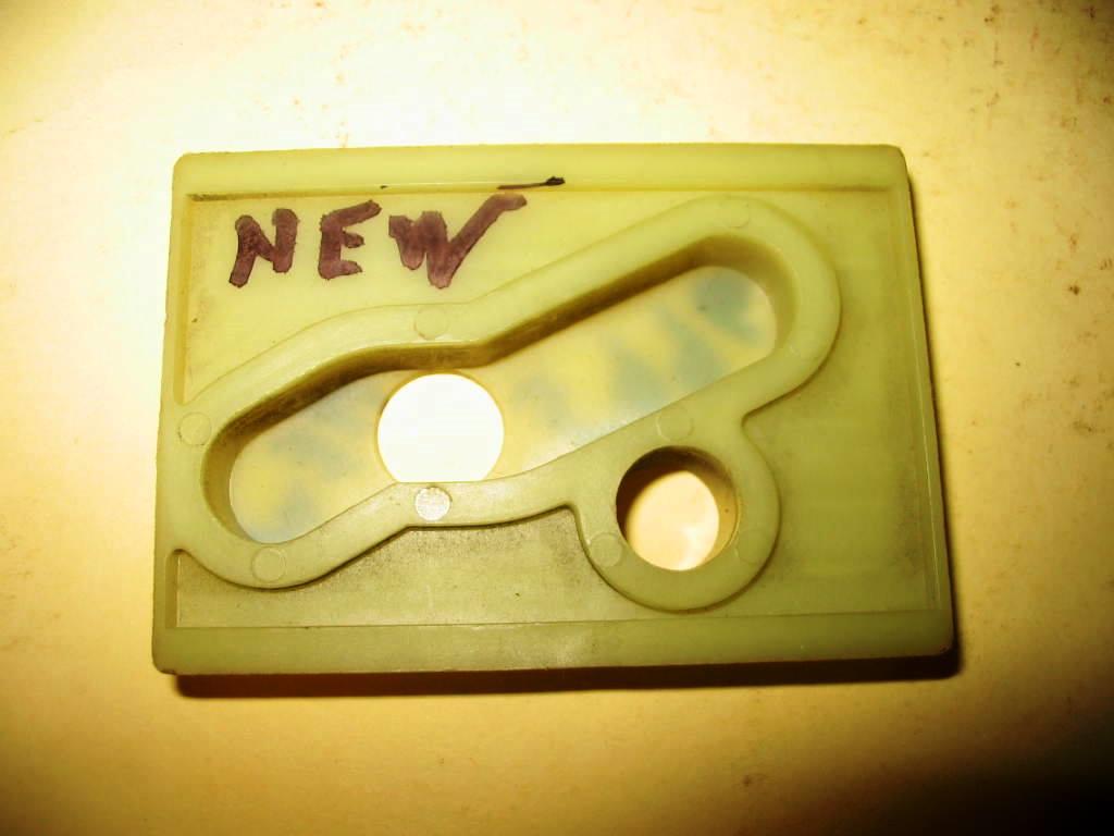

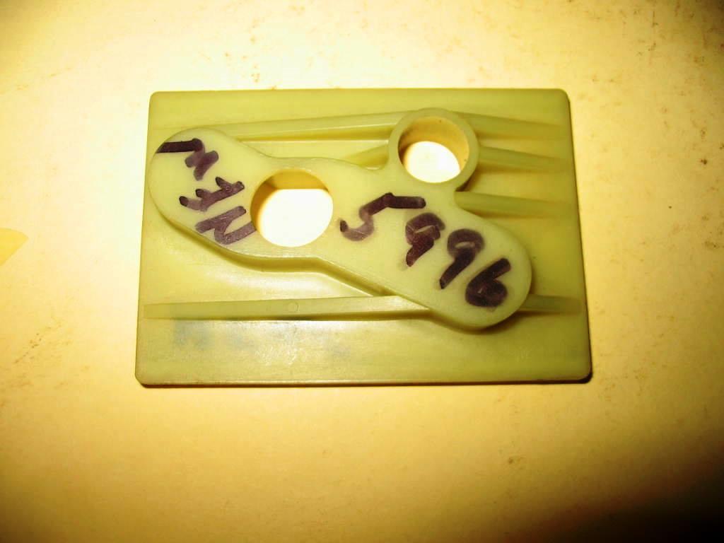

daveoman1966 3,884 #9 Posted April 3, 2019 (edited) The nylon cam MAY also be worn out or broken... I have new one. Part # 5996. It is part of the motion control linkage... Edited April 3, 2019 by daveoman1966 1 1 Share this post Link to post Share on other sites
