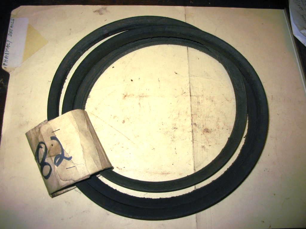

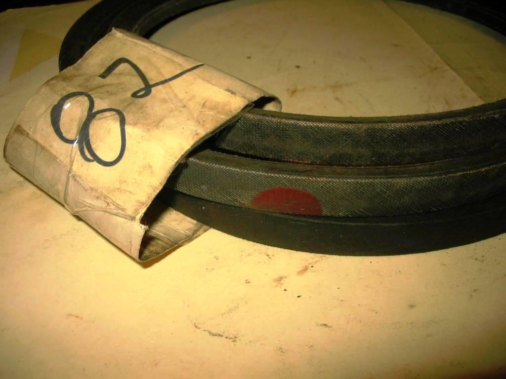

lewis357 2 #1 Posted April 2, 2019 hi i have a 1971 raider 10 kohler engine and i am trying to find the correct length engine to transmission drive belt length , the old one is worn so the nearest replacement i have found is a B80 17 X 2030 LI but it is a little to long a B79 is to tight and there is no adjustment in the motor mount bolt holes , can any one tell me the original size or part no , thank you Share this post Link to post Share on other sites

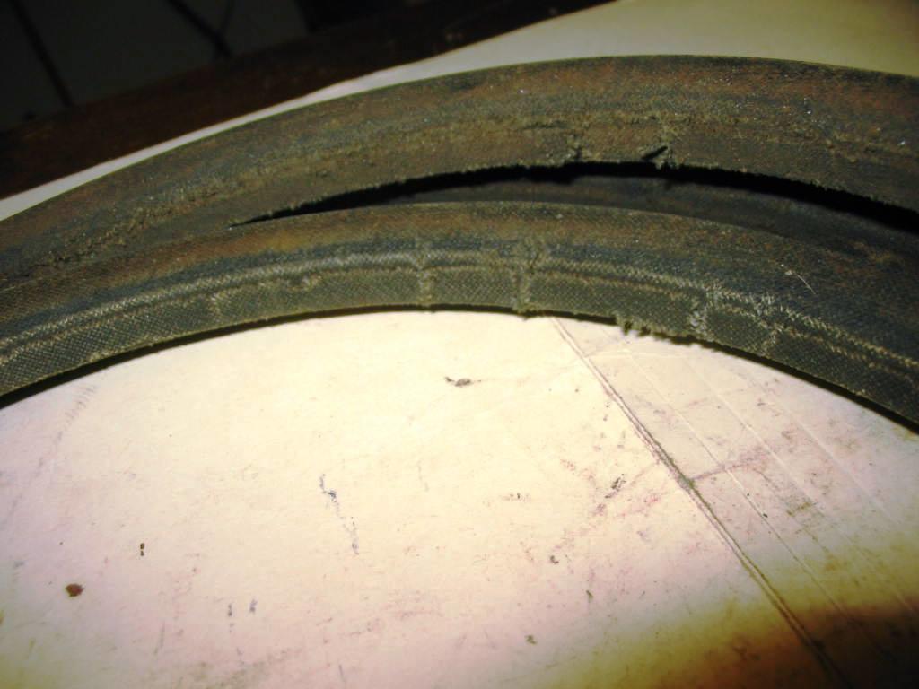

lewis357 2 #4 Posted April 2, 2019 hi i thought the pulley would cope but its either permanent drive or a slight slip under load , with the original belt and marking the pulley position to the frame neither of the belts i have tried are near , the old belt was an original part about 20 years ago it's almost needing a b 79.5 !! unless its the width that's wrong Share this post Link to post Share on other sites

lewis357 2 #6 Posted April 2, 2019 it all worked fine with the old belt which is cracked through age and has worked fine for many years i only wanted to change it as part of a pre season service and with it back on all is ok i am sure its the width thats wrong 1 Share this post Link to post Share on other sites
pfrederi 20,305 #7 Posted April 2, 2019 Drive belt is WH#7473 5/8" wide 82" long 2 Share this post Link to post Share on other sites
daveoman1966 3,882 #8 Posted April 2, 2019 Drive berlt # 7473.. here for about $25 new. https://www.psep1.biz/arinet.asp?aribrand=TO#/Toro_Consumer/1-0301%2c_Raider_10_Tractor%2c_1972/14.000_DRIVE_BELTS%2c_PULLEYS_(PLATE_14.1)/1-0301-520-1972/A-5309-5309009A-00013 I have a good used one for $15...shipped. No cracks and the material is slightly worn. Share this post Link to post Share on other sites
lewis357 2 #9 Posted April 2, 2019 than you the B section belt i have is 17mm wide not the 15 .875 / 5/8 it should be 1 Share this post Link to post Share on other sites
