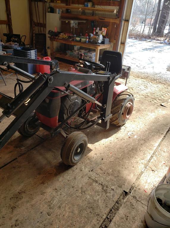

lynnmor 8,845 #2 Posted April 1, 2019 Pin is missing where the upright and sub frame meet. It could get ugly if that pulls apart. Share this post Link to post Share on other sites
Wheelhorse4life 148 #3 Posted April 1, 2019 24 minutes ago, lynnmor said: Pin is missing where the upright and sub frame meet. It could get ugly if that pulls apart. Where is there a pin missing? Share this post Link to post Share on other sites
lynnmor 8,845 #4 Posted April 1, 2019 The left side upright is an oil tank. The bottom of that sits on the sub frame and a long pin secures it in place. Other side is the same. Share this post Link to post Share on other sites

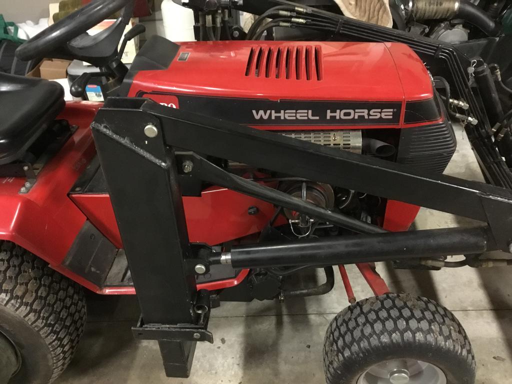

RJC1965 173 #5 Posted April 9, 2019 You should see the pin in mine. Share this post Link to post Share on other sites
