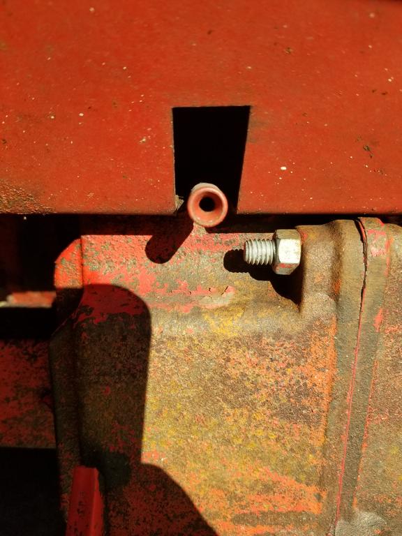

Oberg111 5 #1 Posted March 31, 2019 Can anyone help me out with what this is for? Share this post Link to post Share on other sites
Marv 996 #2 Posted March 31, 2019 30 minutes ago, Oberg111 said: Can anyone help me out with what this is for? It is the guide tube for the rear lift cable. Maev Share this post Link to post Share on other sites

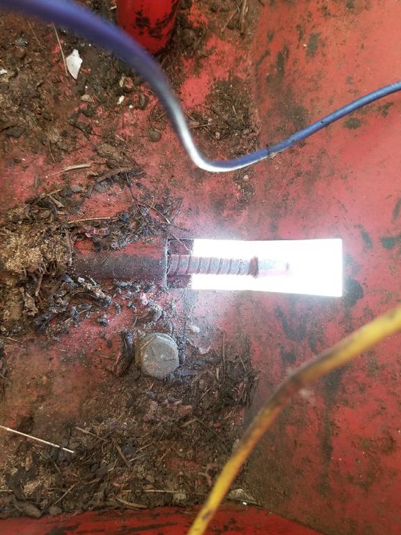

Oberg111 5 #3 Posted March 31, 2019 (edited) Ok thank you can anyone tell me if there is a way to adjust the forward /reverse this one doesn't seem to have a neutral spot that aligns very well Edited March 31, 2019 by Oberg111 Share this post Link to post Share on other sites
pfrederi 21,095 #4 Posted March 31, 2019 That has nothing to do with tractor movement. What model tractor do you have? Something with a sundstrand hydro????. 1 Share this post Link to post Share on other sites
Oberg111 5 #5 Posted March 31, 2019 Yes it's got something to do with the hydro for sure it is a 14 horse automatic 1973 Share this post Link to post Share on other sites
pfrederi 21,095 #6 Posted April 1, 2019 That tube holds the cable for the clevis hitch or rock shaft You need to do neutral adjustment. 1 Share this post Link to post Share on other sites
953 nut 68,787 #7 Posted April 1, 2019 (edited) This manual has a good description of the procedure for setting neutral. The lift cable guide tube has nothing to do with the transmission, it is just held in place there. Edited April 1, 2019 by 953 nut 1 Share this post Link to post Share on other sites
gwest_ca-(File Mod) 12,478 #9 Posted April 1, 2019 Neutral adjustment is explained in the operator manual page 5. Click on the picture Garry Share this post Link to post Share on other sites
