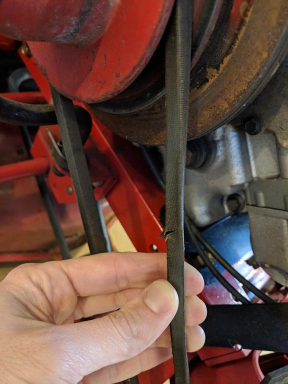

csvt99 173 #1 Posted March 31, 2019 Looks like I need a new belt for my 314-8. I have a dealer about 45 minutes away that was born and raised on wheel horse and knows his stuff. Do you guys have dealer alternatives for basic parts or is it worth the drive to utilize the dealer? Share this post Link to post Share on other sites
peter lena 9,841 #2 Posted March 31, 2019 do you have a T/S thats closer ? the belt looks like it probably has some I/D on it , not looking in terrible shape. if nothing else you could bring it with you and match one up. you might also try a Napa AUTO PARTS store. pete Share this post Link to post Share on other sites
The Tuul Crib 7,353 #3 Posted March 31, 2019 If you can find the length of the belt got your nearest autozone. Best price! 1 Share this post Link to post Share on other sites
pfrederi 20,223 #4 Posted March 31, 2019 (edited) WH 7473 For the gear drives I prefer WH belts. (I use Gates Power rated for everything else. The WH just seem to be a bit smoother engaging. Other have different experiences 82 " 5/8" if you go after market Edited March 31, 2019 by pfrederi 1 Share this post Link to post Share on other sites
ericj 1,579 #5 Posted April 1, 2019 that looks like the pto drive belt, from tractor to deck, The length would depend on the deck Rear discharge , side discharge, those are the 2 main ones. I think that they are around 100" eric j Share this post Link to post Share on other sites
csvt99 173 #6 Posted April 1, 2019 19 hours ago, ericj said: that looks like the pto drive belt, from tractor to deck, The length would depend on the deck Rear discharge , side discharge, those are the 2 main ones. I think that they are around 100" eric j Yes this is the belt. I have a 42 rear discharge. Share this post Link to post Share on other sites
csvt99 173 #7 Posted April 2, 2019 I'm having a hard time reading the belt. I will call the dealer to see if they know the size. Otherwise I could get a few around 100" and give it a try. I would prefer not to have it torn apart for long since the grass is getting greener😁 Share this post Link to post Share on other sites
csvt99 173 #8 Posted April 3, 2019 Part number on belt is 108834. There is a 1 in a circle after the number, not sure what that means but they come up online as 98". I will call around and see what I can find. Share this post Link to post Share on other sites

Dirtdog524 61 #13 Posted April 8, 2019 Not to Nitpick, but the belt (in your picture is on the outside grove of the PTO pulley. It belongs on the inside grove. Long story short, the new belt may not work if you try to install it on the Outside of the pulley. Share this post Link to post Share on other sites
