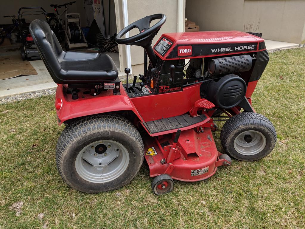

csvt99 173 #1 Posted March 30, 2019 Hey Guys, I picked up 314-8 today with a 42" RD deck. Less than 300 hours, good shape but needs a cleaning. I will be using this for mowing as it was time to return my dad's Kubota and my 877 was smoking me out. Can you offer any maintenance tips or references? Common problems to watch out for? I wasn't sure I would like the gear drive because I love my hydro, but so far I love it. Thanks! 7 3 Share this post Link to post Share on other sites

clueless 3,438 #3 Posted March 30, 2019 314-8 with a 42 inch deck with lees than 300 hr , should get you thru at least another 30 years, with a little maintenance . 5 Share this post Link to post Share on other sites

JAinVA 4,638 #5 Posted March 30, 2019 Looks like you got a keeper.Grease the front end with the front tires off the ground. Change the oil every 20 hours and it should last many years. 2 Share this post Link to post Share on other sites

953 nut 69,131 #10 Posted March 31, 2019 Looks like it has been well taken care of. Keep up he maintenance and you will be driving it forever! 2 Share this post Link to post Share on other sites

classiccat 548 #17 Posted March 31, 2019 (edited) congrats! That machine looks well maintained! Very nice find! Edited March 31, 2019 by classiccat Share this post Link to post Share on other sites
peter lena 10,047 #18 Posted March 31, 2019 CSFT99 , how do the new guys always find the great stuff ? terrific find , doing a baseline service , checking over everything and servicing it will establish what you have, not that is isin,t already like new , let me get my druel cup . you might wipe down those painted surfaces with WD40 , to feed the and enhance the paint. just doing that will make that horse , pop with shine. keep us in the loop , thanks pete Share this post Link to post Share on other sites
