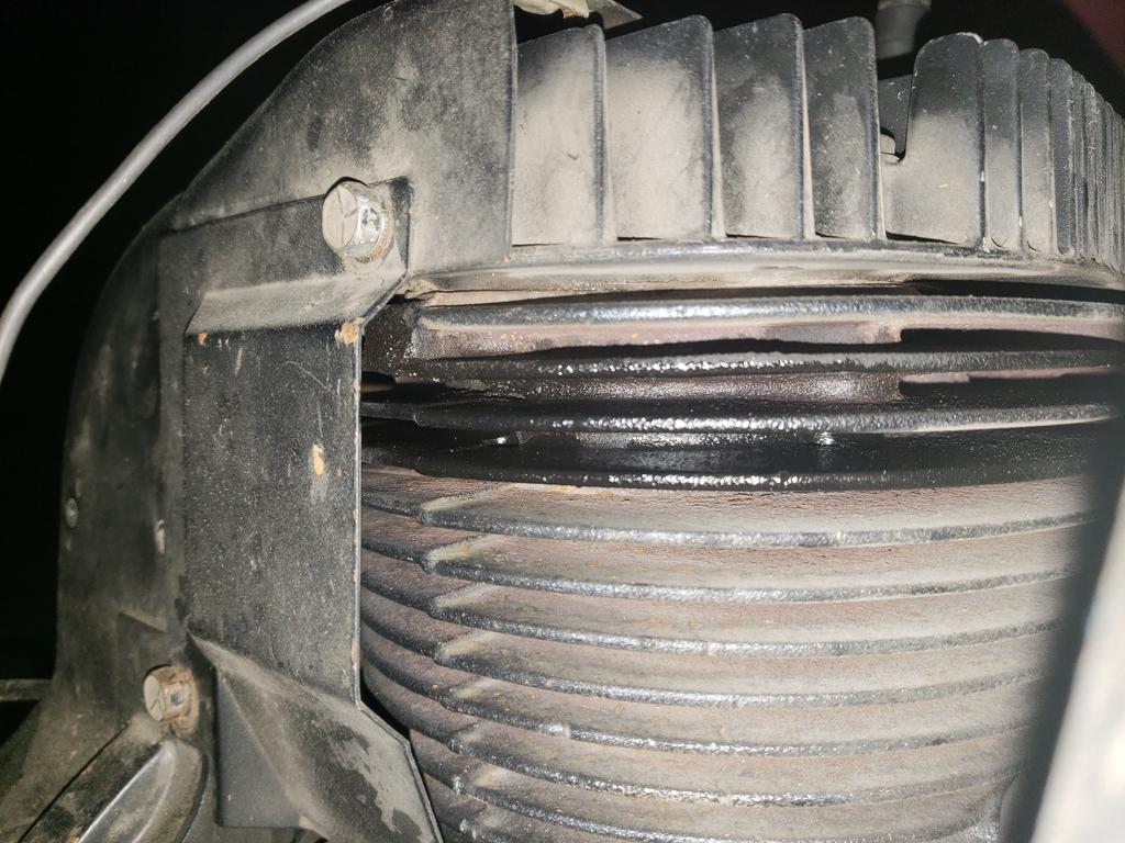

Kody Bob 17 #1 Posted March 30, 2019 Took the blade off of the C-145 the other day and got the mower deck put back on. First time out cutting the grass this season I was able to make about 5 or 6 passes and then the motor quit very suddenly. Not like the kind of peter out if you run it out of gas, but also I did not hear a distinct change in the sound of the engine either. Anyway, I noticed a spot of oil on the side of the block that looks to be just below the head gasket. Is this a blatant head gasket failure? Any ideas as to why it would fail so suddenly? Like i said, I did not notice any issues until the motor cut out. No smoke, no harsh noises. Engine still turns over, but will not start. Not 100% sure, it may be in my head, but it does seem to sound a little different when cranking, and I did see a puff or two of white smoke when I did crank it over. Thanks in advance for any help guys, I really appreciate it. Share this post Link to post Share on other sites
ebinmaine 79,169 #2 Posted March 30, 2019 Certainly looks like a head gasket is needed. My C160 had that same stain when I got it and I ran fine. Have you done any diagnostics on the electrical system? Spark quit? Share this post Link to post Share on other sites
Kody Bob 17 #3 Posted March 30, 2019 12 minutes ago, ebinmaine said: Certainly looks like a head gasket is needed. My C160 had that same stain when I got it and I ran fine. Have you done any diagnostics on the electrical system? Spark quit? Spark is an issue i have not eliminated yet. I did pull the plug and try to get it to arc on the block but was not able to see a spark. The plug looked bad so I replaced it, and it still wouldn't start. It was getting late and I didn't think to test it to see if i could get it to arc to the block. Ill check that out tonight If I get a chance. I did check continuity in a few other parts of the system and didn't find any issues. Share this post Link to post Share on other sites
pacer 3,180 #4 Posted March 30, 2019 The head gasket will need to be replaced, but its very doubtful it caused your problem. My first thought on this type of 'sudden death' is ignition -- points, condenser, coil, switch, etc. Do go ahead and verify whether you are getting spark. Was doing my first grass cutting couple days ago and a similar failure occurred. I raised the hood and almost immediately spotted the coil wire was off at the coil. On examination, over the years the wire/boot cover had became soft and would not grip the coil. Stuck it back in and made it back to shop, made up a new wire and --- its a go! 1 Share this post Link to post Share on other sites
Kody Bob 17 #5 Posted March 30, 2019 5 minutes ago, pacer said: The head gasket will need to be replaced, but its very doubtful it caused your problem. My first thought on this type of 'sudden death' is ignition -- points, condenser, coil, switch, etc. Do go ahead and verify whether you are getting spark. Was doing my first grass cutting couple days ago and a similar failure occurred. I raised the hood and almost immediately spotted the coil wire was off at the coil. On examination, over the years the wire/boot cover had became soft and would not grip the coil. Stuck it back in and made it back to shop, made up a new wire and --- its a go! Will definitely dive into the ignition tonight hopefully. I was thinking the same thing, that the head gasket wouldn't have gone in a fashion that would have suddenly killed the motor. Will get a new head gasket ordered. I have not opened up this engine so it will be good to see the condition of the valves as well. Share this post Link to post Share on other sites
