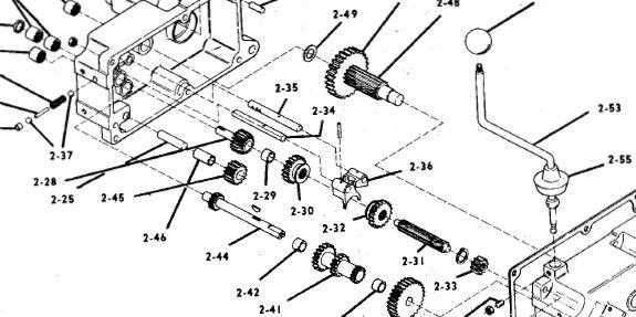

Pullstart 71,520 #39 Posted April 1, 2019 On 3/30/2019 at 1:35 PM, Racinbob said: Along with the 3523 Jim mentioned the input gear/shaft might be suspect. Do this test before you open the transmission. Put the transmission in third. You'll feel the shifter balls slip into the detents on the rails. Then, with it in third gear see if there's any in/out play on the input pulley. There should be none. If there is, determine how much and make note of it. You'll need to get a 3/4" ID arbor shim of that thickness to slip on the input shaft as you reassemble things. That play represents the amount the 3523 gear can and will disengage from the input gear as you're running it. Bob, does this trick apply to all transmissions? I’ve never heard of that! Share this post Link to post Share on other sites
Racinbob 13,286 #40 Posted April 1, 2019 2 hours ago, pullstart said: Bob, does this trick apply to all transmissions? I’ve never heard of that! At least the 3 and 4 speeds. The most recent I needed to do this was on a 5025 from an 854 I picked up at the big show last year. It wasn't popping out of third but it had a little play and I was opening it up for inspection anyway. The thing only had about 2 tablespoons of oil in it when I got it and I feared the worse for the rest of the gears but I got lucky. he first time I noticed this was on a 50103 piece case like @cudakid has. One thought on that one was to use thinner side plate gaskets but that wasn't feasible because I was using extremely thin gaskets already. 1 1 1 Share this post Link to post Share on other sites
Sarge 3,473 #41 Posted April 1, 2019 A restored '67 is a rare thing - I'd get after it. Value isn't there to collectors as with the later years, but that early styling has an attraction all its own. I almost bought an early '68, regretted it ever since as that one was totally rust free. Dad had a '66 Charger in the brushed silver, very unforgettable and quite elegant car - you hardly ever see those at the shows either, which is too bad. Sarge 1 Share this post Link to post Share on other sites
WHX?? 58,347 #42 Posted April 1, 2019 (edited) 4 hours ago, pullstart said: Bob, does this trick apply to all transmissions? I’ve never heard of that! 2 hours ago, Racinbob said: At least the 3 and 4 speeds. The most recent I needed to do this was on a 5025 from an 854 I picked up at the big show last year. It wasn't popping out of third but it had a little play and I was opening it up for inspection anyway. The thing only had about 2 tablespoons of oil in it when I got it and I feared the worse for the rest of the gears but I got lucky. he first time I noticed this was on a 50103 piece case like @cudakid has. One thought on that one was to use thinner side plate gaskets but that wasn't feasible because I was using extremely thin gaskets already. I never have either Bob this last 5049 two piece one I did has about 1/16 to 1/8" play, maybe better never measured it, on the input pulley. Never worried about it as other trannys have the same. So what you are saying is using shim stock shim the input shaft, 2-28, over towards the hi/2nd gear 2-30? Maybe leave a little for end play? Does make sense tho to keep the input gear stuffed in the 3523 as much as possible. Edited April 1, 2019 by WHX22 2 Share this post Link to post Share on other sites
Racinbob 13,286 #43 Posted April 1, 2019 That's what I do Jim. A 3/4" arbor shim slipped on to the input shaft as you install it through the bearings to allow the detent balls to keep the two gears firmly together. I go for zero end play. You don't need any. Grab a 3523 and a 3522 gear/shaft, put them together and give them a little twisting pressure as you slowly start to disengage them. You won't have to go far before the twisting pressure pushes them completely apart. I figure if I can get about half way before they push apart they can be used if they are held together firmly. 1 2 1 Share this post Link to post Share on other sites
Lane Ranger 12,161 #44 Posted April 1, 2019 So Bob you place the arbor shim on the shaft of the input shaft gear and it rides between the gear face and the bearing on the right side casting of the transmission (item # 2-28 ) in Jim's drawing above? And that takes out any slack or play in the input gear linkage? Where can you get those 3/4 arbor shims? Share this post Link to post Share on other sites
WHX?? 58,347 #45 Posted April 1, 2019 Sure it's 3/4 Bob I thought the input shaft was 5/8??? 54 minutes ago, Racinbob said: I go for zero end play. Does this mean you can shift on fly!?!?! 1 1 1 Share this post Link to post Share on other sites
Racinbob 13,286 #46 Posted April 1, 2019 1 hour ago, Lane Ranger said: So Bob you place the arbor shim on the shaft of the input shaft gear and it rides between the gear face and the bearing on the right side casting of the transmission (item # 2-28 ) in Jim's drawing above? And that takes out any slack or play in the input gear linkage? Where can you get those 3/4 arbor shims? Perzackly Lane. The shim rides on the center thingy of the bearing and is smaller in diameter than the OD of the bearing. I got my 3/4" ID (more on that in the @WHX22 quote) shims at WW Grainger. I bought a variety pack of 20 a there. Works like a charm. 49 minutes ago, WHX22 said: Sure it's 3/4 Bob I thought the input shaft was 5/8?? All the one's I did were 3/4" The 5091 on my 1976 is 5/8" but the gear design is different so I didn't need them. I'm not going to say all the 3 and 4 speeds are 3/4" but just the ones I've done. 52 minutes ago, WHX22 said: Does this mean you can shift on fly!?!?! NO YOU IDIOT!! Ignore what the owners manual says...…………..but you knew that...…………. 1 1 2 Share this post Link to post Share on other sites
