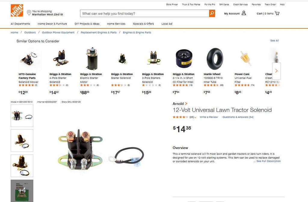

pfrederi 20,541 #13 Posted March 30, 2019 Lowe's HD have garden tractor solenoids. Share this post Link to post Share on other sites

The Tuul Crib 7,354 #16 Posted March 31, 2019 11 hours ago, pfrederi said: Lowe's HD have garden tractor solenoids. I went today and priced selinoids at O’Reillys and was shocked at the price! 40 bucks! They did have one around 20! Im going to the junk yard Share this post Link to post Share on other sites
rjg854 13,046 #17 Posted March 31, 2019 Check on eBay, that's where I got mine, I think about 12 bucks Share this post Link to post Share on other sites
953 nut 66,091 #18 Posted March 31, 2019 Auto Zone has the Ford solenoid in stock for $ 13.99. https://www.autozone.com/batteries-starting-and-charging/solenoid-switch/valucraft-solenoid-switch/966566_27788_7969_1356 1 Share this post Link to post Share on other sites
The Tuul Crib 7,354 #19 Posted March 31, 2019 19 minutes ago, 953 nut said: Auto Zone has the Ford solenoid in stock for $ 13.99. https://www.autozone.com/batteries-starting-and-charging/solenoid-switch/valucraft-solenoid-switch/966566_27788_7969_1356 I’ll have to check that out tomorrow. That sounds a bit more in my price range! 1 Share this post Link to post Share on other sites
