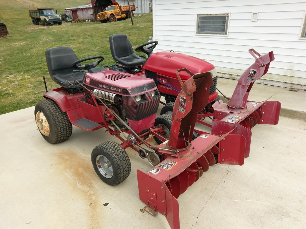

Harvey 0 #1 Posted March 29, 2019 I have a 520h with a front snowblower It needs a new drive belt can't read the numbers on it anyone know what it is? Share this post Link to post Share on other sites
stevasaurus 23,841 #2 Posted March 29, 2019 Look through this manual and see if this is the same blower you have. If not go to the Manuals section on the main page and check through the attachments section. Share this post Link to post Share on other sites
WVHillbilly520H 10,379 #3 Posted March 29, 2019 2 hours ago, Harvey said: I have a 520h with a front snowblower It needs a new drive belt can't read the numbers on it anyone know what it is? Here's a single (no cab) 5/8"x 69" and a 2stage (cab) 5/8"x64.5" 2 Share this post Link to post Share on other sites
