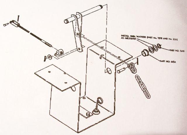

gwest_ca-(File Mod) 12,456 #2 Posted March 29, 2019 It is illustrated in the parts list Garry Share this post Link to post Share on other sites
raven2955 23 #3 Posted March 29, 2019 Where can I get the part that goes under the seat ? is their a part number? Share this post Link to post Share on other sites
gwest_ca-(File Mod) 12,456 #4 Posted March 29, 2019 Page 10 item 66 is part number 105539 called a lever. Bushings washers and retaining ring also required. What model year is your tractor? Garry Share this post Link to post Share on other sites

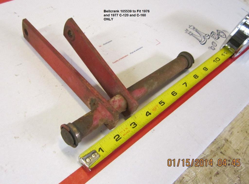

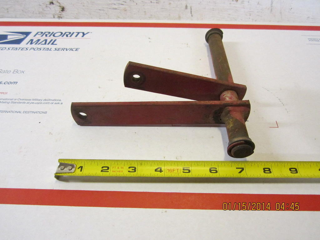

daveoman1966 3,884 #7 Posted March 29, 2019 (edited) This guy has the rockshaft 105539 for sale TODAY...on FB.... Mark DiFrischia <notification@facebookmail.com> He and I were on FB Messenger about 20 minutes ago.... Edited March 29, 2019 by daveoman1966 Share this post Link to post Share on other sites
daveoman1966 3,884 #9 Posted March 29, 2019 10 minutes ago, raven2955 said: How much You'll need to get that answer from MARK DiFrischia. This is his FB contact: Mark DiFrischia <notification@facebookmail.com> 1 Share this post Link to post Share on other sites

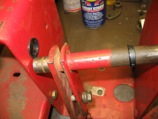

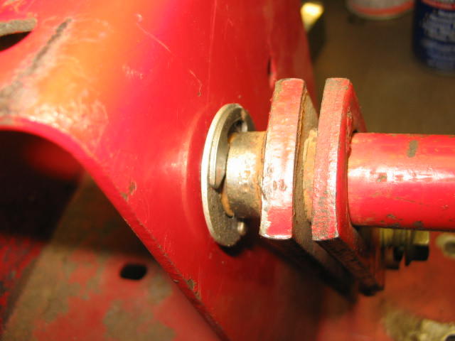

daveoman1966 3,884 #12 Posted March 29, 2019 (edited) You can find the bushings and 'E' clip at an Ace Hardware store....that's what I did. The bushings are black plastic but they hold up VERY WELL...and make a tight fit. You can also pick up the 3/4" thin washers too. $5 bux was all I spent. Edited March 29, 2019 by daveoman1966 Share this post Link to post Share on other sites
raven2955 23 #13 Posted March 29, 2019 what size are the plastic bushing and clips will head to ACE tomorrow Share this post Link to post Share on other sites
daveoman1966 3,884 #14 Posted March 29, 2019 15 minutes ago, raven2955 said: what size are the plastic bushing and clips will head to ACE tomorrow Take a 3/4" round bar with you. The plastic bushing are in boxes ...many sizes to choose from. Select the plastic bushing ID to b3 3/4" and the OD is likely to be for 1". The 'E clip would also be for a 3/4" bar and the washer....3/4" ID 1/16" thick or less. Share this post Link to post Share on other sites
