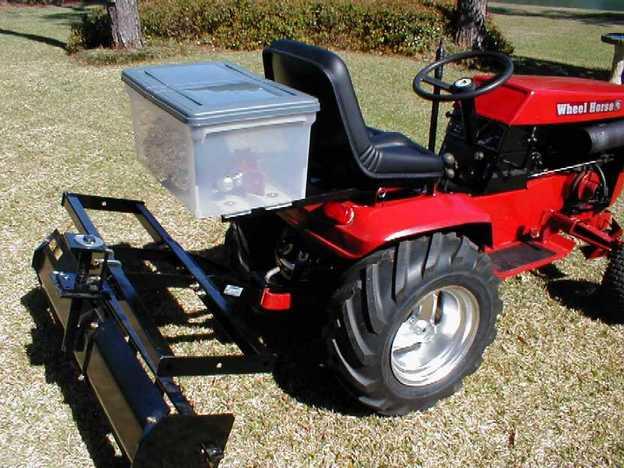

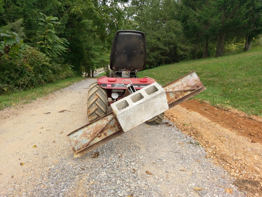

ebinmaine 80,319 #28 Posted March 29, 2019 11 minutes ago, WHX22 said: What keeps it from pushing up on the lift arm EB? Oh I certainly DOES push up on the lift arm..... I AM the down pressure. 4 Share this post Link to post Share on other sites
squonk 47,890 #29 Posted March 29, 2019 Mid graders are easier to control with the manual lift. Eat some spinach or lots of pizza to use human down pressure. I had a homemade blade on my 704. Made it out of a simplicity blade. That blade was heavy and worked much better than the WH blade. But I needed the drool factor on here so I got a good deal on the WH blade and sold the heavy one. 3 Share this post Link to post Share on other sites

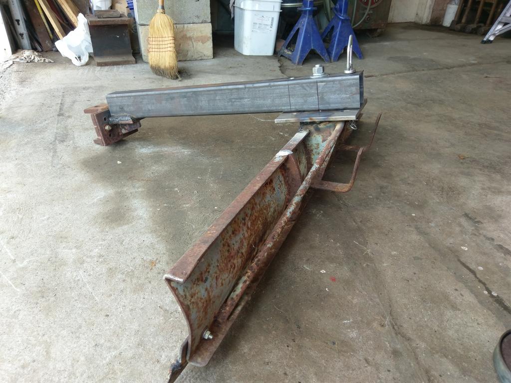

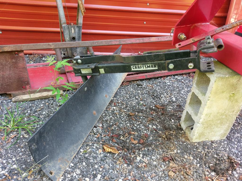

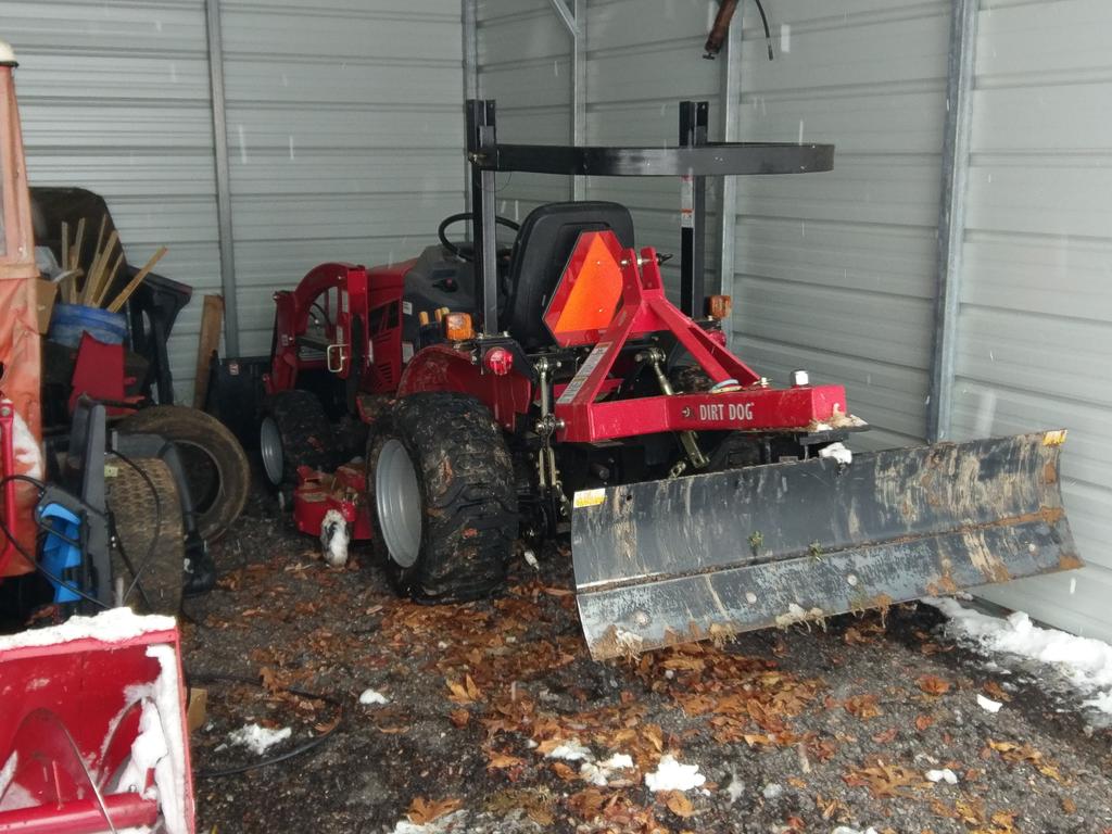

WVHillbilly520H 10,379 #38 Posted March 29, 2019 (edited) 9 hours ago, ebinmaine said: if you're looking for constant down pressure on one side or the other you could attached some weights to that end of the blade, or both ends. Your feet work for that one side or both down pressure (believe it or not that's what my old Dealer said when I was asking about one) 5 hours ago, squonk said: Darn right they do. That blade was extra handy dragging snow away from entrances or in your case sand Brinly or AGRI-FAB (Craftsman) has that covered...my box blade the side caps unbolt to turn into a rear blade or go completely "home built" with tilt feature for pulling side ditches... Maybe I should try making a mid mount like you did to use it both ways...hhhmmm, see pics 6 hours ago, Lee1977 said: I built mine with a 5' grader edge blade I cut down to 4'. It had two mounting hole that center the 4'. They are surface harden I ground all around the blade with a side grinder then saw it off with my cut off saw. The blade is 3/8" thick. like Lee's version here a replacement cutting edge for my 3pt 5' Dirt Dog brand rear scraper blade would make a great one... Edited March 29, 2019 by WVHillbilly520H 1 2 Share this post Link to post Share on other sites

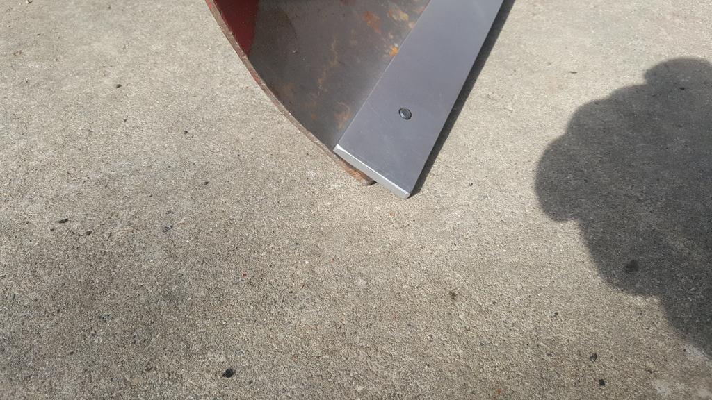

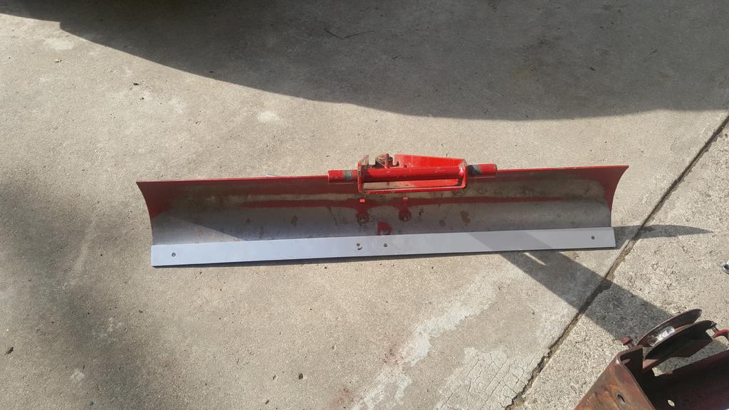

bellevillerod 836 #40 Posted April 2, 2019 Ok got the blade dressed ready to work. Bolted on a 3/16 x 2 x 40" strip of 1055 steel. Really tough steel should hold up real good for a long time. Put the tapped holes on center so I can flip it if need be. 3 1 Share this post Link to post Share on other sites
WVHillbilly520H 10,379 #41 Posted April 2, 2019 7 hours ago, bellevillerod said: Ok got the blade dressed ready to work. Bolted on a 3/16 x 2 x 40" strip of 1055 steel. Really tough steel should hold up real good for a long time. Put the tapped holes on center so I can flip it if need be. Not knocking what you have done there just another perspective...why not drilled through then button heads and nuts? since that 1055 is such tough material and tapping is usually where tough alloys like A6 D2 ect will wear a tap out and break it...again just another perspective from a fellow machinist. 1 Share this post Link to post Share on other sites
bellevillerod 836 #42 Posted April 2, 2019 2 hours ago, WVHillbilly520H said: Not knocking what you have done there just another perspective...why not drilled through then button heads and nuts? since that 1055 is such tough material and tapping is usually where tough alloys like A6 D2 ect will wear a tap out and break it...again just another perspective from a fellow machinist. 1055 carbon steel is right on the border between a medium and a high carbon steel, with a carbon content between 0.50%-0.60% and with manganese between 0.60%-0.90% as the only other component. The carbon content and lean alloy make this a shallow hardening steel with a quenched hardness between Rc 60-64 depending on exact carbon content. These combination of factors make this one of the toughest steels available because, when quenched, it produces a near saturated lathe martensite with no excess carbides, avoiding the brittleness of higher carbon materials. 1055 carbon steel is particularly suited to applications where strength and impact resistance is valued above all other considerations. The likely hood of this steel breaking at the hole are very slim. Also because it was only 3 holes and at 3/16 deep and before I brought it up and quenched it the material is easy on the taps. All that said, ya I could have drilled it for nuts an bolts I was just thinking it would give it a cleaner look. 1 Share this post Link to post Share on other sites
Sarge 3,473 #43 Posted April 2, 2019 Exactly the reason I go to the expense to use the pre-beveled 1055 - the amount of grading work done so far with the big D has shown almost zero wear on the new cutting edge. That 1055 is a great choice for what our machines are capable of doing. The original steel WH used won't last very long at all with the type of work I use my machines for - even routine snow plowing will wear the stock edge out in pretty short order on hard pavement or frozen rock. Sarge 1 1 Share this post Link to post Share on other sites

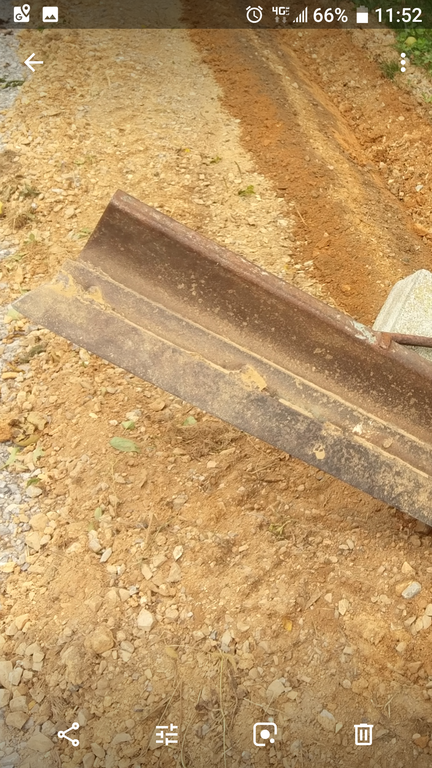

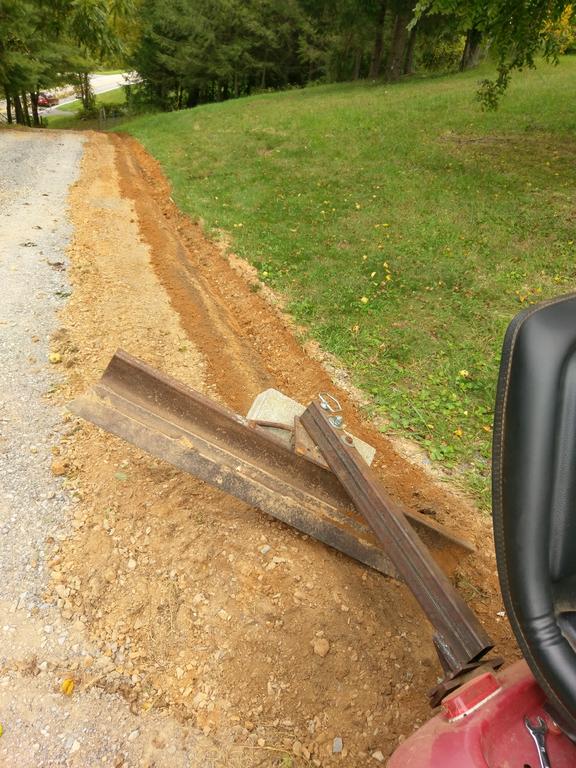

WVHillbilly520H 10,379 #44 Posted April 2, 2019 My father built this rear grader blade about 35 years ago, and then added the welded on cutting edge made from a 50-60s era car/truck leaf springs about 20years ago and every spring and fall would repair our 1/4 mile dirt/gravel/sandstone rock driveway and this is all it has worn in those 20 years, I still use it to pull side ditches and level my BILs driveway. 3 Share this post Link to post Share on other sites
