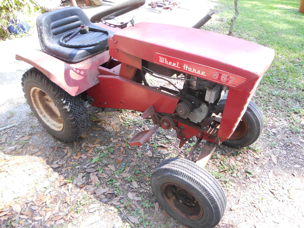

Racinbob 13,119 #8 Posted March 28, 2019 I'm kinda thinking the shifter will work. Here's a 657 that was given to me. The shifter is in neutral. Note how close it is to the rear fender pan. It was impossible to pull it back to 1st or reverse. This tractor is one of two I used to make a good 500 Special. When I tore them both down I noticed that the transmission was older than the tractor and probably a 5025. Somewhere along the way it got swapped out. Going from a later model to a round hood I would say the shifter will probably be fine since there's more clearance. 1 Share this post Link to post Share on other sites
