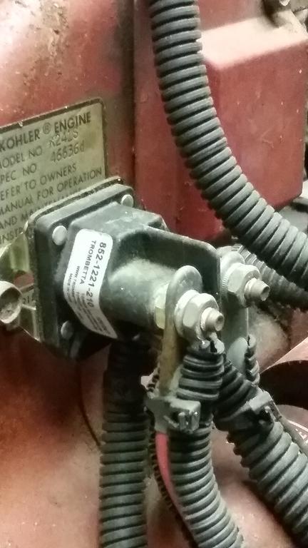

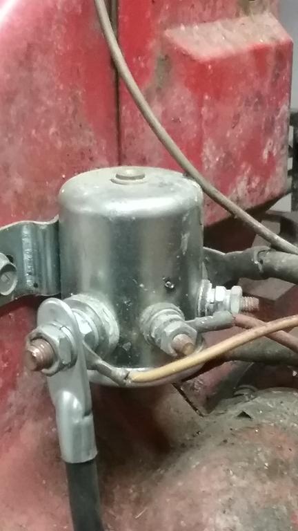

RetroMower 350 #11 Posted March 28, 2019 Didnt have much time to fart around but i did manage to swap the solenoid from the B100 to the C100 as it looked to be much newer and woo hoo key and the starter are now friends again. The silver body one is the faulty one removed from the C100. Black one is a donor from the B100 and works fine. Tomorrow i hope to clean and check the points as 953nut suggested and hopefully it will live again after a near decade nap 3 Share this post Link to post Share on other sites
