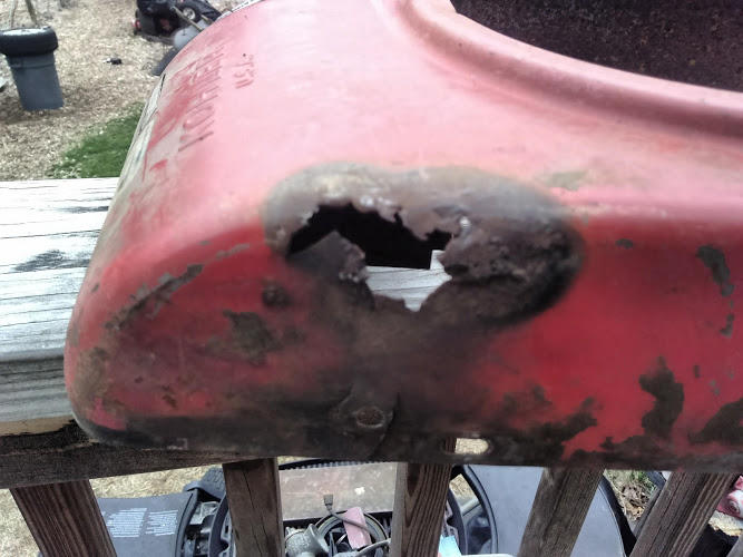

BobbyD218 7 #10 Posted April 12, 2019 Hey Sarge...Thank you for the source. I already have the main engine cover off. I even ordered another on the bay, but it is slightly different. Mine is a K301AS, and the one I received is a K301AQS. The AQS main attachment holes to the engine line up, but there is some difference where the coil, solenoid, and cable attachments connect. Also, my original cover has a large hole and a crack where the coil is that I didn't see before removing it, and it looks like someone had attempted a prior substandard repair. That is also one of the points where it is difficult to put a fastener, and another still in place has been welded over and ineffectual. Share this post Link to post Share on other sites
