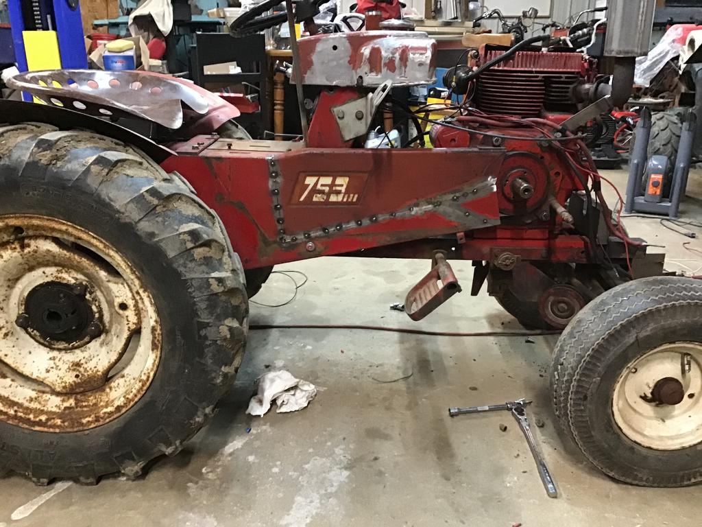

WHX?? 58,052 #26 Posted March 25, 2019 12 minutes ago, wallfish said: There's more than one of us! Guys here have no problem with it and here's some I've done over the years. BUT, even I don't like it when it's a GOOD example of a rare tractor. There are many trashed tractors out there to work with so save the good one's is my opinion Well said 'fish. Share this post Link to post Share on other sites

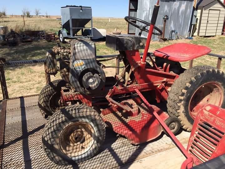

LengerichKA88 1,885 #27 Posted March 25, 2019 2 hours ago, GSRICK said: I don't see any tags anywhere on this WH, either the tractor of the engine. The seller wasn't there and hasn't been much help. He said it was a 50's model, but I didn't think it was that old. > > > Here are a couple of pics of that Craftsman I mentioned. It was a discarded rider with a blown 10 horse engine that was sitting next to a dumpster. I wanted it to have a 50's hot rod flavor and I was very happy with how it turned out. @WHX22, you’re both right 😂😂 2 1 Share this post Link to post Share on other sites

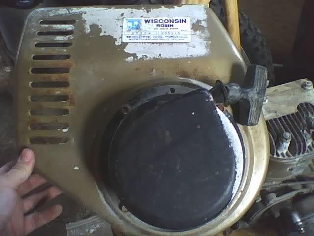

WHX?? 58,052 #28 Posted March 25, 2019 (edited) 37 minutes ago, gwest_ca said: In some ways the engine looks like a Wisconsin-Robin. Garry Bingo on that call Garry... Edited March 25, 2019 by WHX22 2 Share this post Link to post Share on other sites

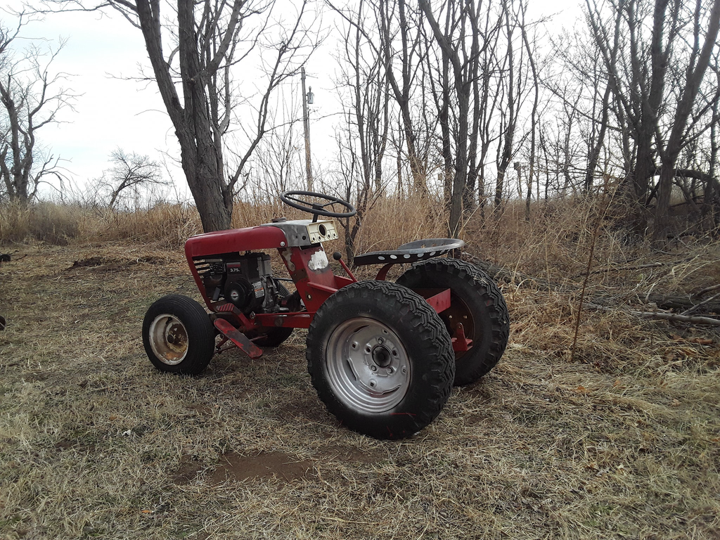

stevasaurus 23,842 #30 Posted March 25, 2019 Ya, Rick, I was refering to what the PO said...thanks. Anyway, that transmission is a Peerless and I think it is the 1400 series. If your horse is or was an A-90 it would be a 1974. A & B series horses used a smaller tire then the C & D series horses...and they do look original. 1 Share this post Link to post Share on other sites

GSRICK 41 #32 Posted March 25, 2019 13 minutes ago, WHX22 said: Bingo on that call Garry... Cool thanks, both of you. Just found this on eBay and it looks just like it. 2 Share this post Link to post Share on other sites

GSRICK 41 #41 Posted March 25, 2019 I got 88 psi on three pulls. I should have bought more than three feet of cord. Even with it being dry and cold that's not bad, is it? I got only 80 psi the first time I tried, but forgot to open the throttle plate. Good news is it shocked the snot out of me, so it's getting good spark. BTW, my electric HF impact didn't work. It barely moved it and all it probably did was tightened the flywheel nut more. I put the spark plug in and gave it a shot of carb cleaner, but I didn't get any action. I think I need a longer cord. 2 Share this post Link to post Share on other sites
