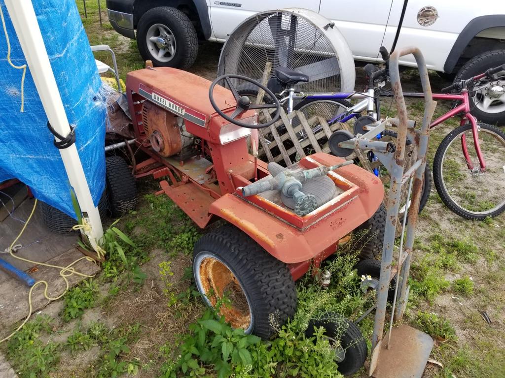

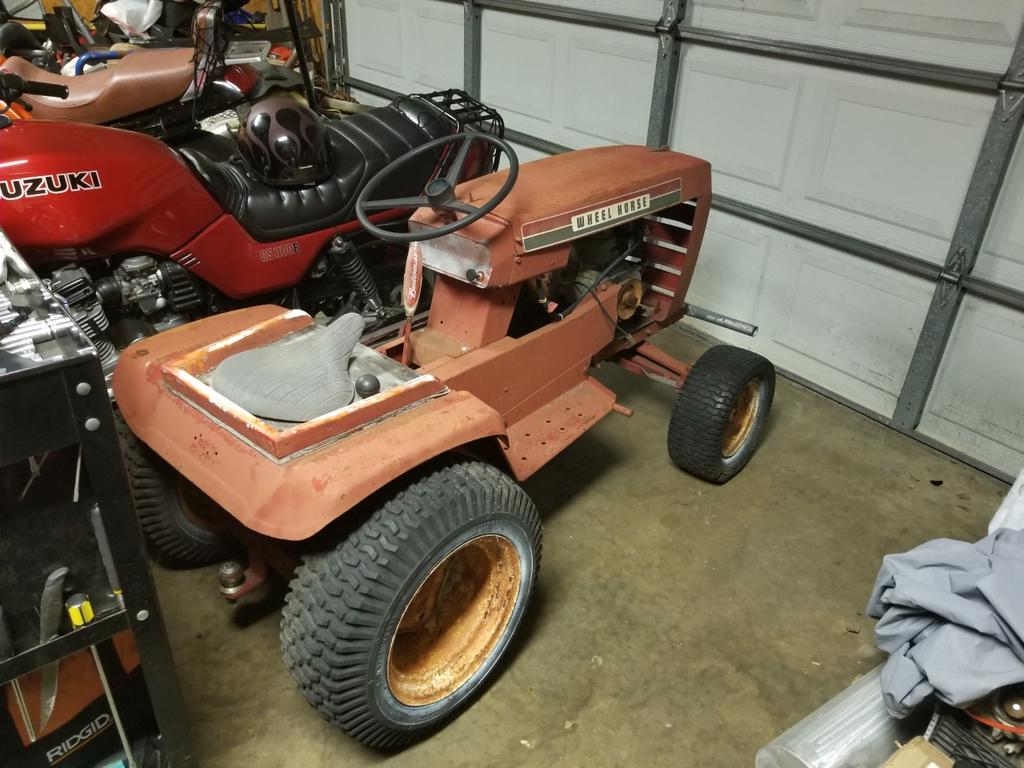

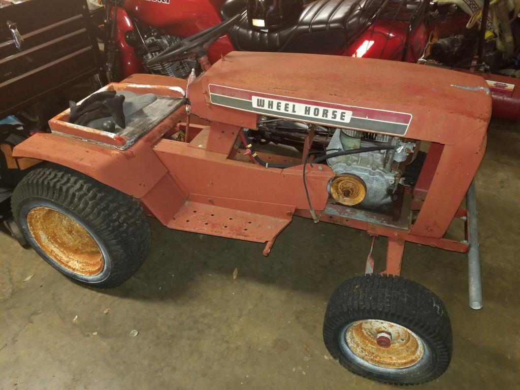

GSRICK 41 #1 Posted March 25, 2019 First a little intro. I'm a M/C mechanic in central FL and found this forum trying to ID a Wheel Horse tractor. Now for the good stuff. I picked up a Wheel Horse tractor today from one of our local flea markets. I think it's an early 70-72 model judging by the hood decals. I'm hoping someone here can fill me in with some more info on what I've got. I'm not quite sure what I'm going to do with it. From some of the gallery pics I looked at, it looks like the engine isn't original, but I'm saying that because I haven't seen another engine like it in the photos available. I could be wrong and hope I am, but either way, it isn't frozen, but is missing some parts. I may restore it, depending on how much is missing and what is available or i might build something custom Hot Rod Rider like I did with a free Craftsman rider about 7 years ago. Well that's all I can say for now, besides thanks in advance, for any information you can share I've got. 4 Share this post Link to post Share on other sites
953 nut 70,344 #2 Posted March 25, 2019 As you have already determined the engine and seating have been altered by previous owners. That isn't a big problem, they can be replaced or you can go custom with your build. Here at Red Square we welcome all trains of thought . When it comes to your it is yours and we want to see your vision for it.5 As for the year and model there was a metal tag fastened below the dash board, but it may be long gone. Some of our eagle eyed members will probably be able to figure out exactly what it was. Share this post Link to post Share on other sites
Achto 32,927 #3 Posted March 25, 2019 I'm not much help on the ID of your tractor but would like to know what kind of engine is in it. Share this post Link to post Share on other sites
Pullstart 71,520 #4 Posted March 25, 2019 to the best Wheel Horse site on the planet! I am no pro, but I think that is a short frame tractor with a long frame hood. The hood looks late 70’s ish to me, based on the grille shape. Either way, I bet it’ll do about whatever you need so long you get it running and the transmission is free! Share this post Link to post Share on other sites

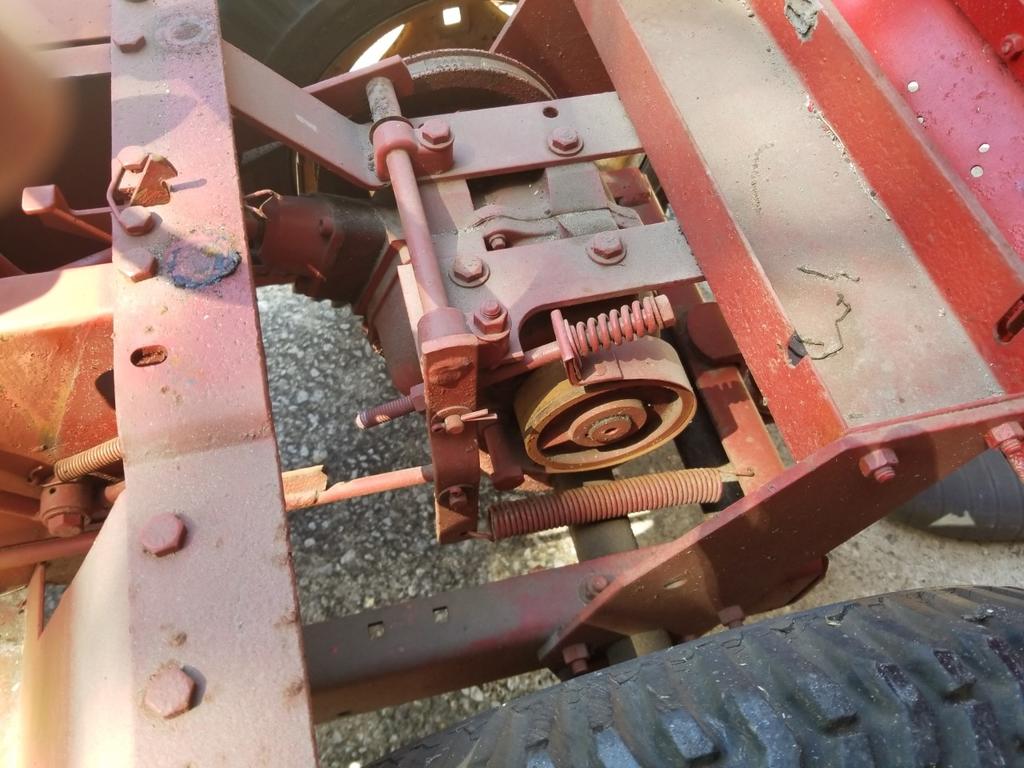

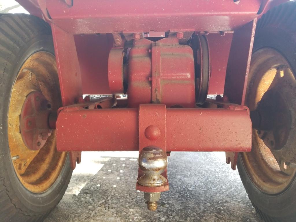

Sparky-(Admin) 26,691 #5 Posted March 25, 2019 The one picture where I can see the rear end makes me thing you have an A90 Special. Early 1970’s I think. Would have had a Briggs Gen-Start 8hp under the hood. The A90 had an oddball Peerless rear axle that Wheel Horse wasn’t know for using except on that unit. Here’s a pic of the back end of an A90. Share this post Link to post Share on other sites

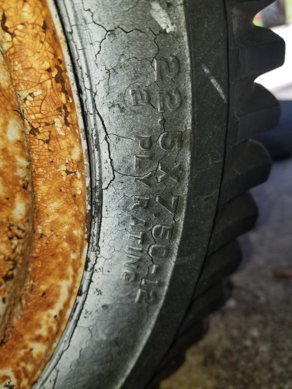

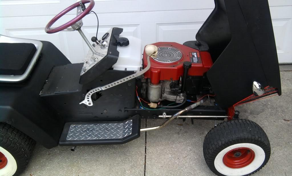

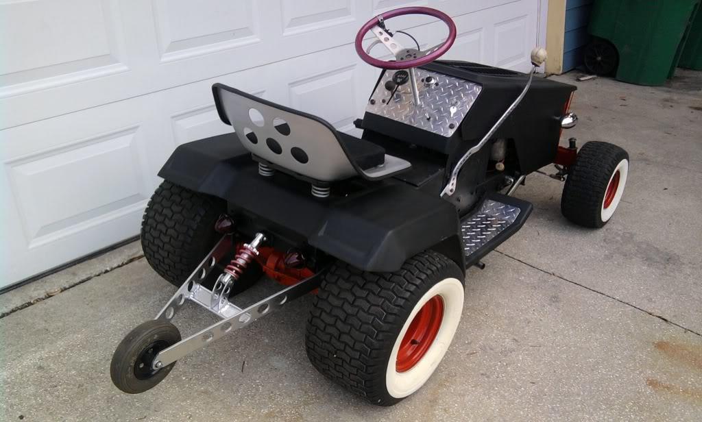

stevasaurus 23,884 #9 Posted March 25, 2019 The Craftsmen is just excellent !! thanks for sharing that...and the story. The way you posted pictures is about the easiest way and it works great that way. Like Sparky said, a picture of the transmission would go a long way to narrowing down the ID of the horse. Also, those rear tires look original...what size are they? That can help eliminate some horses. After seeing the Craftsmen, I am looking forward to seeing what you come up with for the Wheel Horse. Glad you found us. BTW, no way that horse is from the 50's...with the foot rests you have, most likely early 70's. Share this post Link to post Share on other sites
edgro 680 #10 Posted March 25, 2019 The tie rods seem unusial, have not seen them before Share this post Link to post Share on other sites

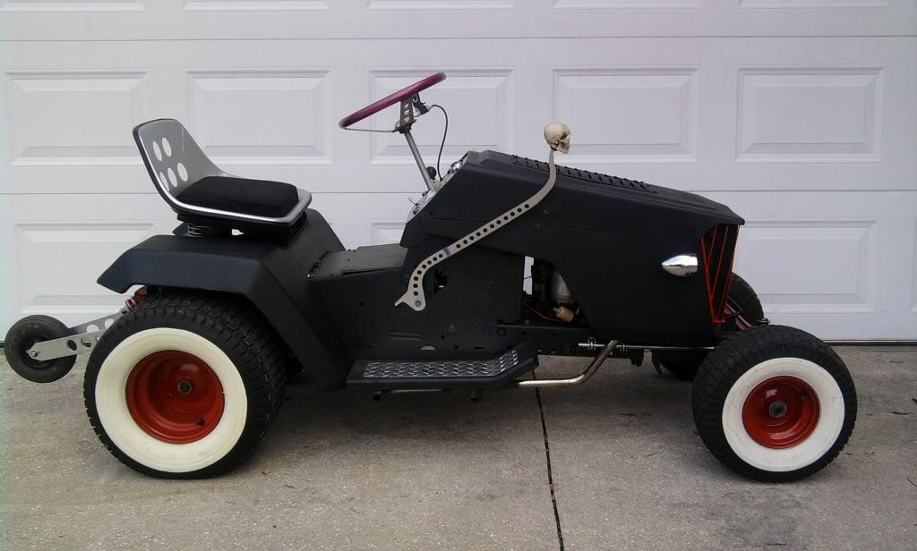

WHX?? 58,347 #11 Posted March 25, 2019 And the guy has got fab skills fer sure... always use a guy like that around here! Ther goes having the market cornered on white walls on red rims Dan @Achto! 2 4 Share this post Link to post Share on other sites
GSRICK 41 #12 Posted March 25, 2019 4 minutes ago, WHX22 said: And the guy has got fab skills fer sure... always use a guy like that around here! Ther goes having the market cornered on white walls on red rims Dan @Achto! Great minds think alike. 1 1 Share this post Link to post Share on other sites

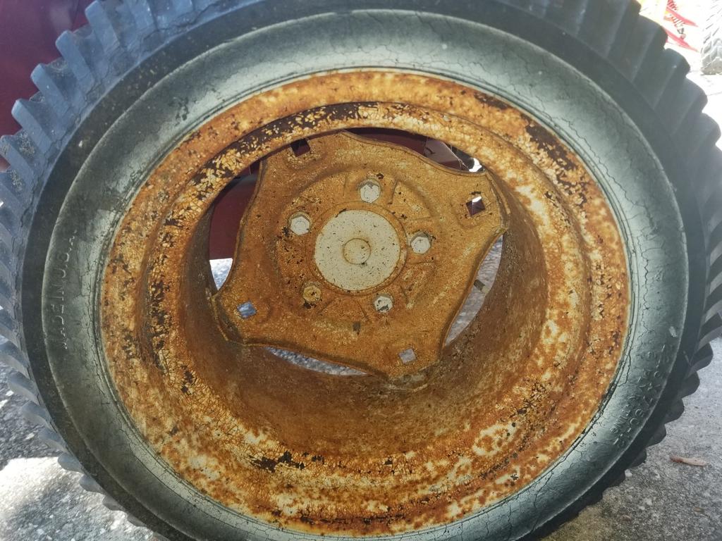

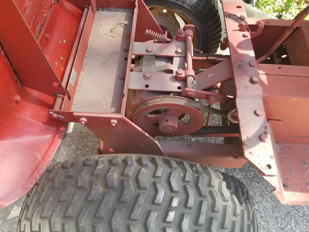

GSRICK 41 #13 Posted March 25, 2019 Here are a couple of pics of the trans and tire size. Does anyone know offhand what wheel pattern that is? I've got a set of two Chevy bolt pattern, vintage American Racing Torque Thrust-D wheels I've been hanging onto for something. Share this post Link to post Share on other sites

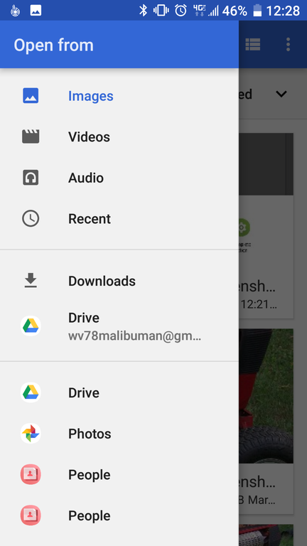

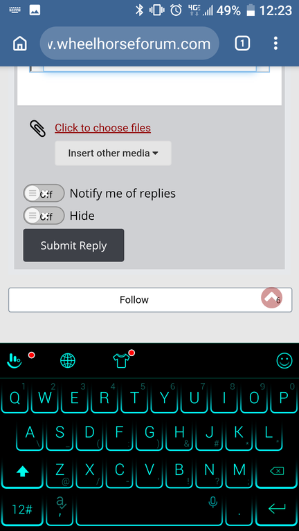

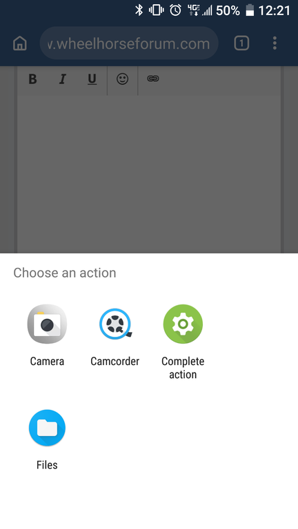

WVHillbilly520H 10,379 #14 Posted March 25, 2019 1 hour ago, GSRICK said: I can take more photos. What would you like to see that will help? I just entered the 21st century last week from my flip phone to a Galaxy 8, but I don't know how to use it to post pics directly. Last night I emailed them from my photo gallery, then saved them to my computer from the email, which I could then grab them and post here with the choose files link. There has to be an easier way? Any help with that would also be appreciated. Ok when you want to add/share pics from your phone just scroll down to the red "click to choose files" click on that then the next pop up is "choose action" whether straight from the camera or the files icon which is where your stored "images" should be just follow along with my pics 1-2-3...welcome aboard and hope this helps, Jeff. 1 Share this post Link to post Share on other sites
WVHillbilly520H 10,379 #15 Posted March 25, 2019 3 minutes ago, GSRICK said: Here are a couple of pics of the trans and tire size. Does anyone know offhand what wheel pattern that is? I've got a set of two Chevy bolt pattern, vintage American Racing Torque Thrust-D wheels I've been hanging onto for something. Ford 4 1/2" on 5... 2 Share this post Link to post Share on other sites

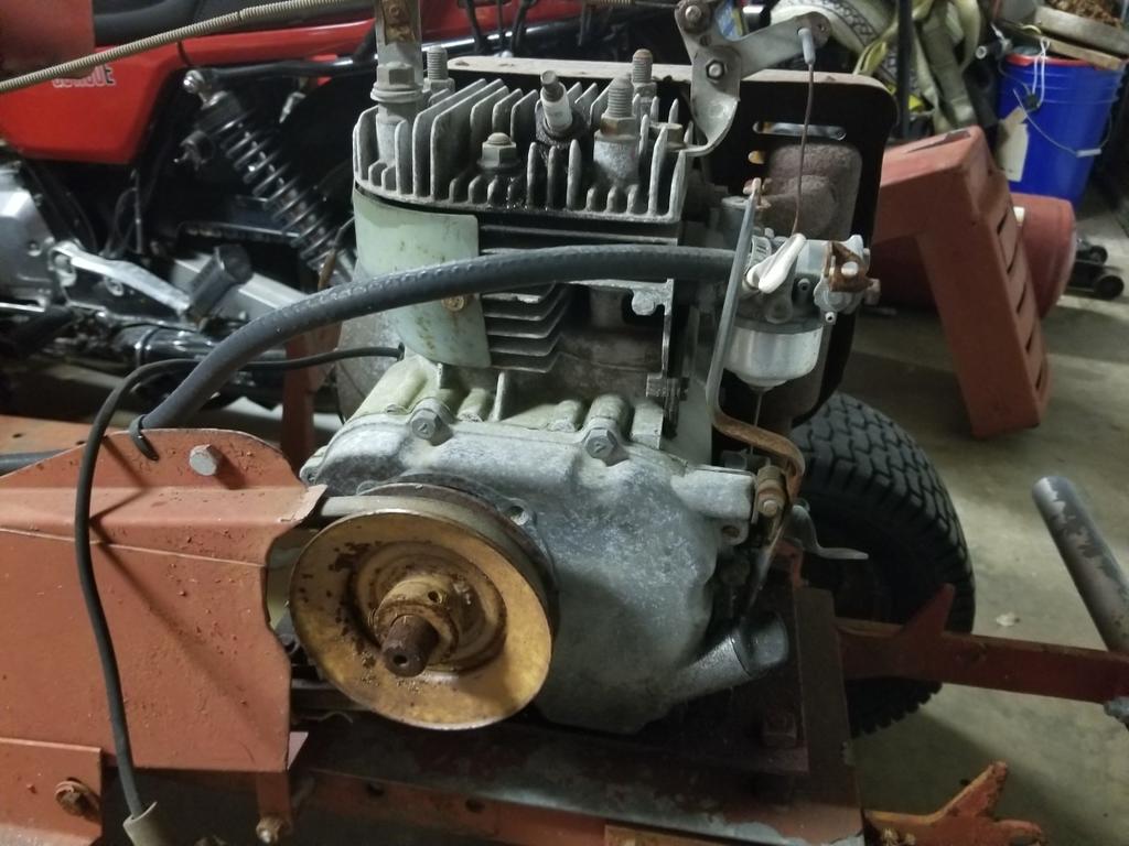

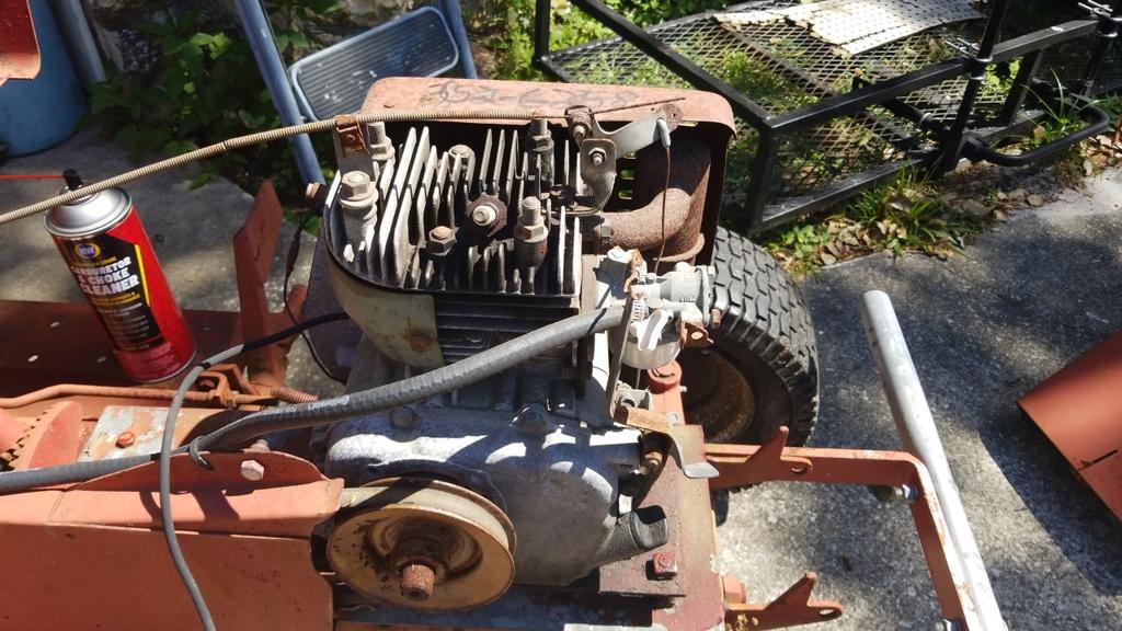

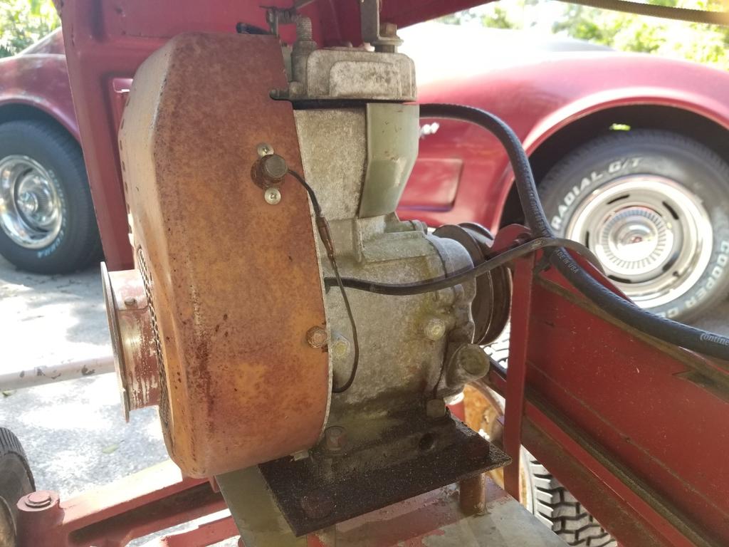

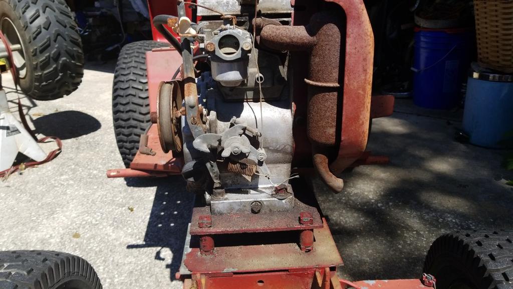

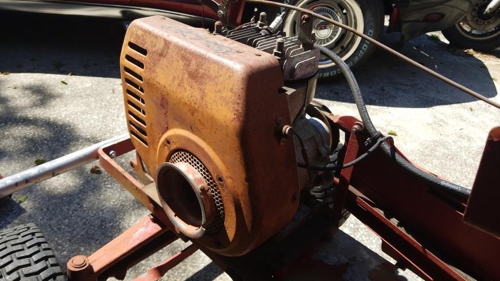

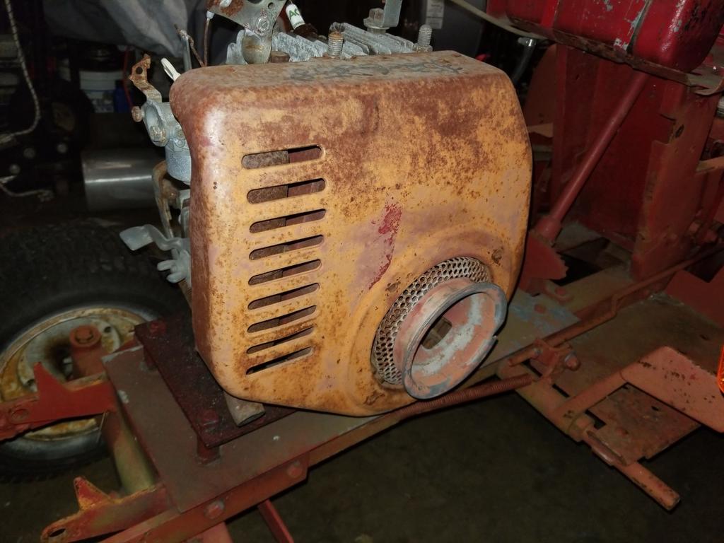

GSRICK 41 #16 Posted March 25, 2019 Some more pics of the engine. Tried looking for some serial numbers but couldn't find anything. Does that look like a string pull start? It seems it would work backwards to me if it is. I have an electric impact that I may try to spin the engine with. The guy said it had good compression, but i like to see for myself. Should I spin it counter clock wise from looking at it on the left like in the fourth pic? 2 Share this post Link to post Share on other sites
Achto 32,927 #17 Posted March 25, 2019 (edited) Looking at the engine from the fly wheel side it should turn clock wise. CCW looking at the PTO side. Yes that would be a rope start. Edited March 25, 2019 by Achto Share this post Link to post Share on other sites
GSRICK 41 #18 Posted March 25, 2019 Thanks, didn't want to screw things up. I may not stick with this engine, but I sure didn't want to mess it up before hand. With a M/C engine I can tell by the CCT which way the engine rotates during operation. Share this post Link to post Share on other sites
GSRICK 41 #19 Posted March 25, 2019 16 minutes ago, WVHillbilly520H said: Ford 4 1/2" on 5... Ford eh? Depending which direction I go with this, some adapters may be in order. The spring Daytona swap meet ended yesterday. 2 Share this post Link to post Share on other sites

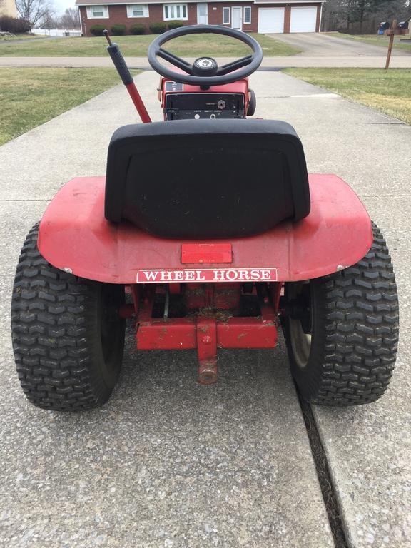

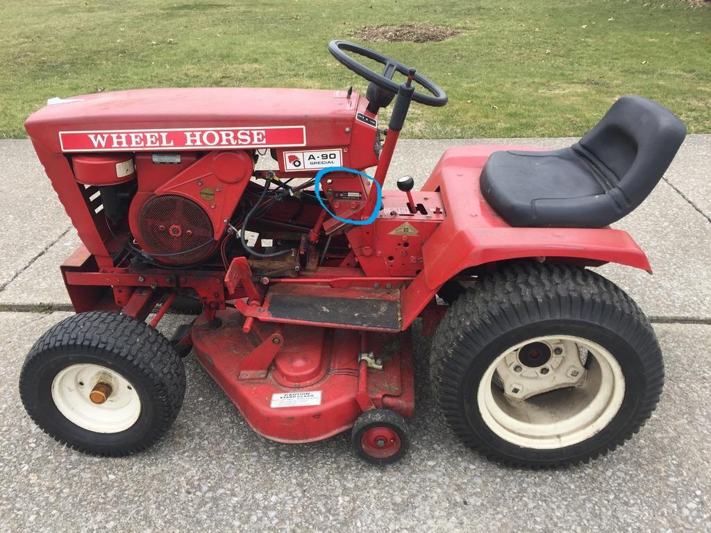

Sparky-(Admin) 26,691 #20 Posted March 25, 2019 If it is or was an A90 the model number tag would have been on the side of the dash tower. Here a pic of an A90 (with the wrong hood) but it shows you in the blue circle where the metal tag should be riveted on. 1 Share this post Link to post Share on other sites

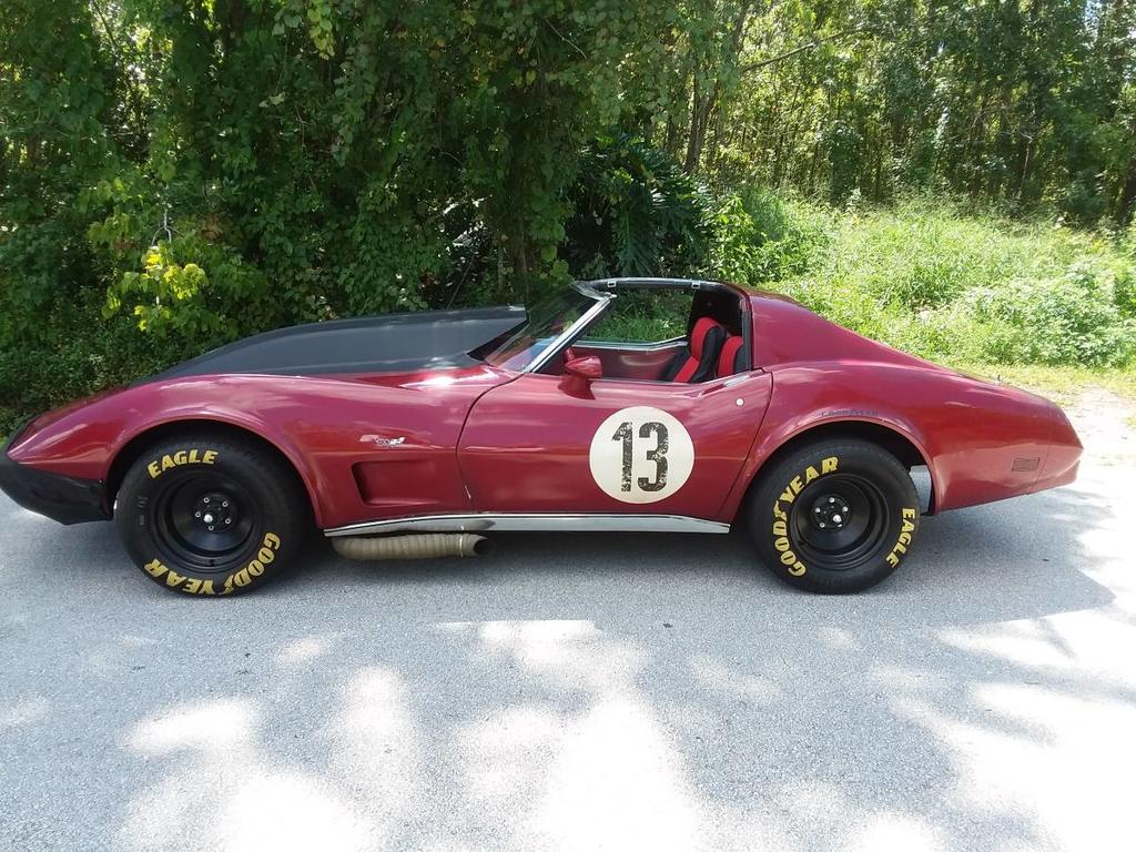

Achto 32,927 #21 Posted March 25, 2019 (edited) The notch for the rope starter looks to be set up correctly. Most if not all of these small engines will turn CW while looking at the flywheel side. I'm kinda bummed that there is no info to ID that engine, I can't say that I have ever seen a fan shroud like that one. BTW Nice Vett in the back ground Edited March 25, 2019 by Achto 2 Share this post Link to post Share on other sites
gwest_ca-(File Mod) 12,535 #22 Posted March 25, 2019 In some ways the engine looks like a Wisconsin-Robin. Garry Share this post Link to post Share on other sites
GSRICK 41 #23 Posted March 25, 2019 17 minutes ago, Achto said: The notch for the rope starter looks to be set up correctly. Most if not all of these small engines will turn CW while looking at the flywheel side. I'm kinda bummed that there is no info to ID that engine, I can't say that I have ever seen a fan shroud like that one. BTW Nice Vett in the back ground Thanks, another recent project purchase. It's a '77. The PO was turning it into an autocross car and I'm making it street legal again. Had to mount some light in the grill since the the top of the front clip has an aftermarket piece grafted in place with molded in headlight doors. I have a very understanding wife. 5 3 Share this post Link to post Share on other sites

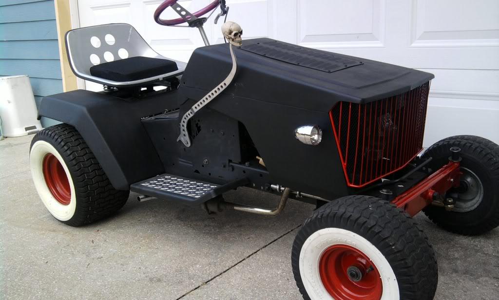

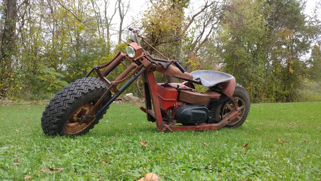

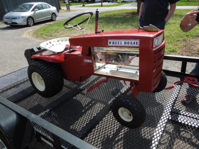

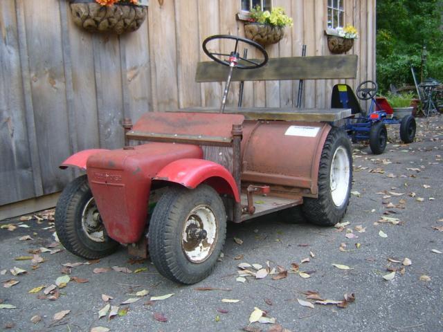

wallfish 20,733 #24 Posted March 25, 2019 2 hours ago, GSRICK said: I'm glad to see there is at least one guy here that is accepting of them. On GSR, there are some guys that can be very opinionated whenever someone wants to build a GS into a custom bike. I can see that if it is a pristine example, but if it is being brought back from the dead and isn't an ultra rare model, I say, "do what makes you happy, it's yours". I have stock bikes and modified bikes, it's all good to me. There's more than one of us! Guys here have no problem with it and here's some I've done over the years. BUT, even I don't like it when it's a GOOD example of a rare tractor. There are many trashed tractors out there to work with so save the good one's is my opinion. Little 2 seat cruiser Dozer frame bike build Fish tanked electric powered for a friend of mine daughter There's a hot rod one around to but can't find the pics. So Have Fun with it! 6 3 Share this post Link to post Share on other sites
