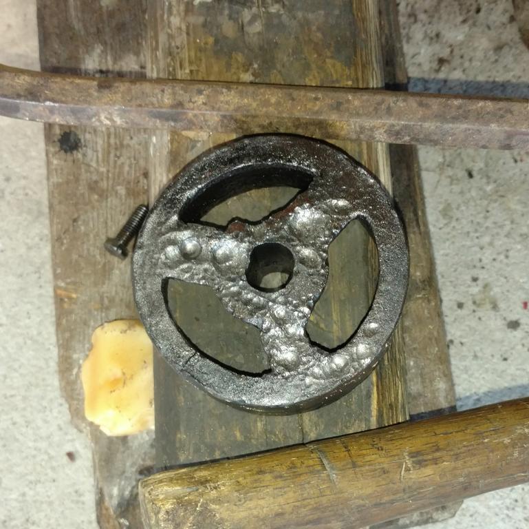

troutbum70 858 #12 Posted March 28, 2019 Well finally got this bugger off, but as you can see I really beat the tar out of it and cracked it as well. I have another 417 but it sits way out in the back and no way easy to move it so not sure if I can get the drum off it. Any one have any idea if new ones are available or if only finding a used one. 1 Share this post Link to post Share on other sites
JoeM 10,246 #13 Posted March 28, 2019 I would give that used on a try. I know this one was tough but I have seen them when I thought they would not come off, they slide right off. Used in good condition is good too. I would take that old one and drive a nail through it into the shop walk............kind of like a trophy! 3 1 Share this post Link to post Share on other sites
ebinmaine 80,600 #14 Posted March 28, 2019 Yeah like Joe said... A good used one is perfectly fine. Post an in the wanted section of the classifieds or just call Lincoln at A to Z. He'll have one. Share this post Link to post Share on other sites
troutbum70 858 #15 Posted March 28, 2019 Well I have to check the other 417 as it is a hydro tractor so not sure if it is the same drum as the 8 speed, I know the brake bands themselves are different as how they mount. I have a fellow about 25 miles away that used to be a wheel horse dealer and he has a few things around along with some old tractors. Share this post Link to post Share on other sites
stevasaurus 23,841 #16 Posted March 29, 2019 That is one heck of a paper weight !! That could be a calendar shot. Go to A-Z and get a used one. Troutbum.....1 Brake drum..0 Share this post Link to post Share on other sites
troutbum70 858 #17 Posted March 29, 2019 I have a chassis out back and went back there today with a 6 foot pry bar and the one on that tractor after fourth try with pry bar it slid right off, as you can see from the picture the one on my running tractor put up a true fight. Fer sure when the replacement goes on it will a good coating of rust preventive. 1 Share this post Link to post Share on other sites
