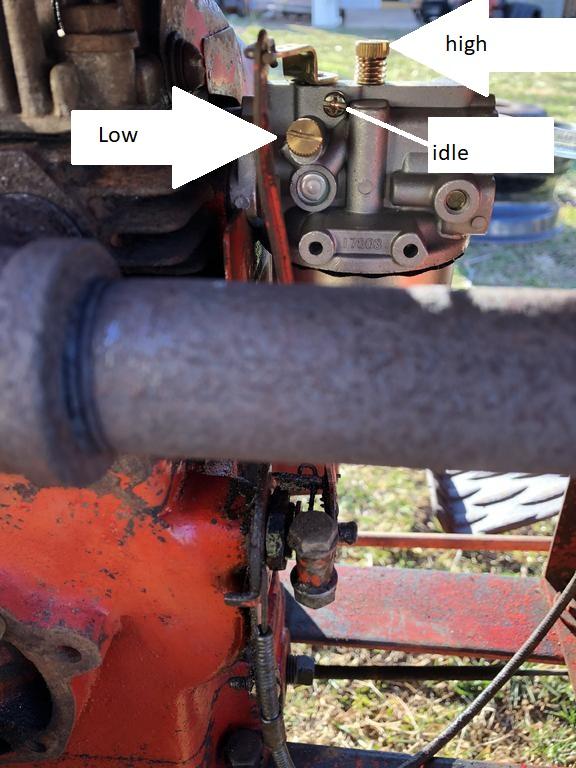

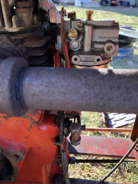

BHunter 1,701 #1 Posted March 23, 2019 I put a new carb on my 4hp . It runs but I don’t know how to adjust it or what screw does what. The picture in the k91 manual shows a different carb. Can someone tell me what the top , middle and lower screws do? Thanks, Bob Share this post Link to post Share on other sites
pfrederi 20,665 #2 Posted March 23, 2019 Based on other carbs I would "Guess" top is high speed angled towards camera idle mixture small Phillips idle speed 6 1 Share this post Link to post Share on other sites
wallfish 20,034 #3 Posted March 23, 2019 (edited) The Kohler manual has an excellent description on how to adjust each Edited March 23, 2019 by wallfish 5 4 Share this post Link to post Share on other sites
BHunter 1,701 #4 Posted March 23, 2019 6 minutes ago, wallfish said: he Kohler manual has an excellent description on how to adjust each Thank you. Your arrows help a lot. Now I can follow the manual. 2 Share this post Link to post Share on other sites
