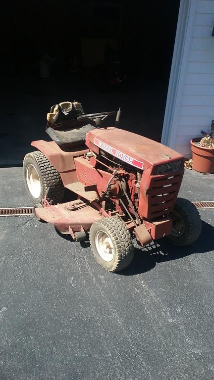

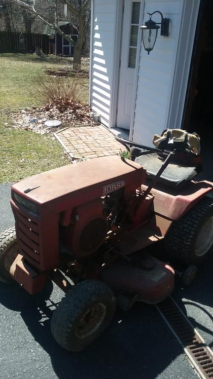

RetroMower 350 #53 Posted March 27, 2019 Well after a little fiddling, draining what used to be gasoline from the system and replacing the battery cables and hooking them to a freshly charged battery.... nothing. . Hooked up the lil multi meter and i have 12v at the key and the solenoid shows 12 on the small terminals when key is moved to start. I jumped 12v straight to the starter and she spins fine but not with the key. Previous owner looks to have jumped the seat safety switch. I have speculations but id like to hear the opinions of you wheel horse pros Share this post Link to post Share on other sites
Sparky-(Admin) 26,690 #54 Posted March 27, 2019 There are safety switches on the PTO as well. Prevents the operator from starting the tractor with the mower deck engaged. In your pics both of your PTO levers are in the engaged position. Try pulling the levers back toward the seat to disengage. 1 1 Share this post Link to post Share on other sites
953 nut 70,344 #55 Posted March 27, 2019 Mike @Sparky, he said he is getting 12 volts to the small terminal of the solenoid with key in start, wouldn't be a safety switch then. I have already answered on his other post on this same problem. Share this post Link to post Share on other sites
