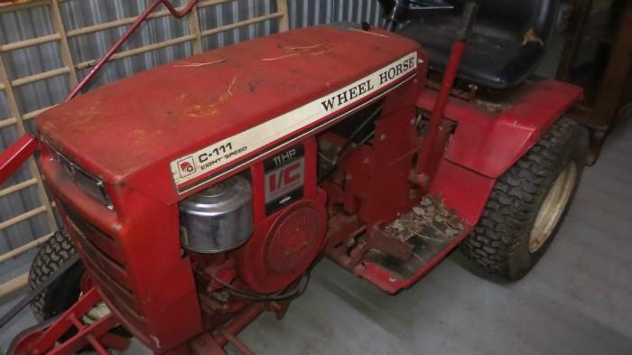

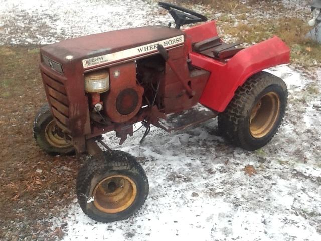

Sparky-(Admin) 26,690 #22 Posted March 23, 2019 11 minutes ago, JimmyJam said: @Sparky I own a 1979 C-111 with a 12hp Kohler. I believe that either Kohler or Briggs and Strattons were options or whatever was factory surplus at time of manufacture. Wouldn’t a Kohler 12 under the hood make is a C-121 ? I think when there was a Briggs single under the hood that Wheel Horse had to cut a small notch in the hood to clear the Briggs air cleaner. I’ve had a couple GT-2500’s and they both had the notch in the hood. You can see it in this pic..... 1 Share this post Link to post Share on other sites
T-Mo-(Moderator) 5,003 #23 Posted March 23, 2019 The C-111 was made only one year, 1979, and had a 11 hp Briggs engine and a 8 speed transmission. Ironically it doesn't appear in my 1979 brochure. Share this post Link to post Share on other sites
clueless 3,440 #24 Posted March 23, 2019 I had a 79, C-111, Briggs and the notch. Also the C-111 has the shaker plate. Share this post Link to post Share on other sites
Ed Kennell 47,821 #25 Posted March 23, 2019 12 minutes ago, clueless said: . Also the C-111 has the shaker plate. Yes, and IMO, that is a negative. I never felt the shaker plate reduced the engine vibration. If anything ,I believe allowing the engine to move increased the vibration and put excess cycling loads on the drive belt . It was a bad idea that increased the cost and never had a benefit. 4 Share this post Link to post Share on other sites
