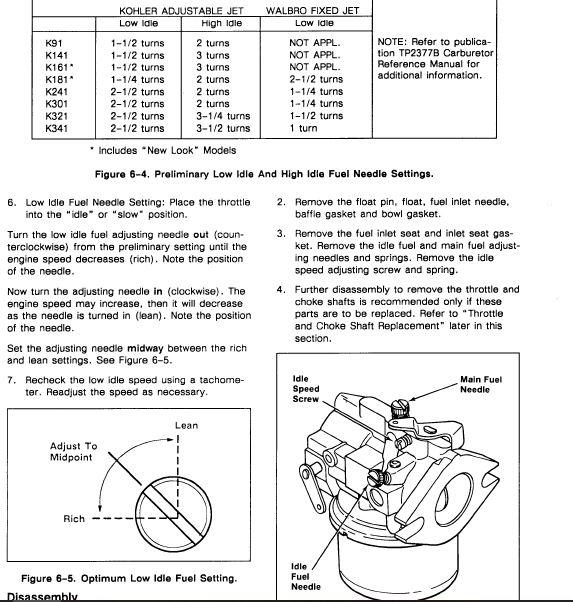

pfrederi 21,300 #2 Posted March 20, 2019 Not sure what you mean by "SAW" If the engine surges (speeds up, then slows down then speeds up, slows down etc) try adjusting the idle mixture needle. Back it out a bit see if things improve. 1 Share this post Link to post Share on other sites

pfrederi 21,300 #4 Posted March 20, 2019 Try adjusting the idle fuel needle turn counter clock wise. 1 Share this post Link to post Share on other sites

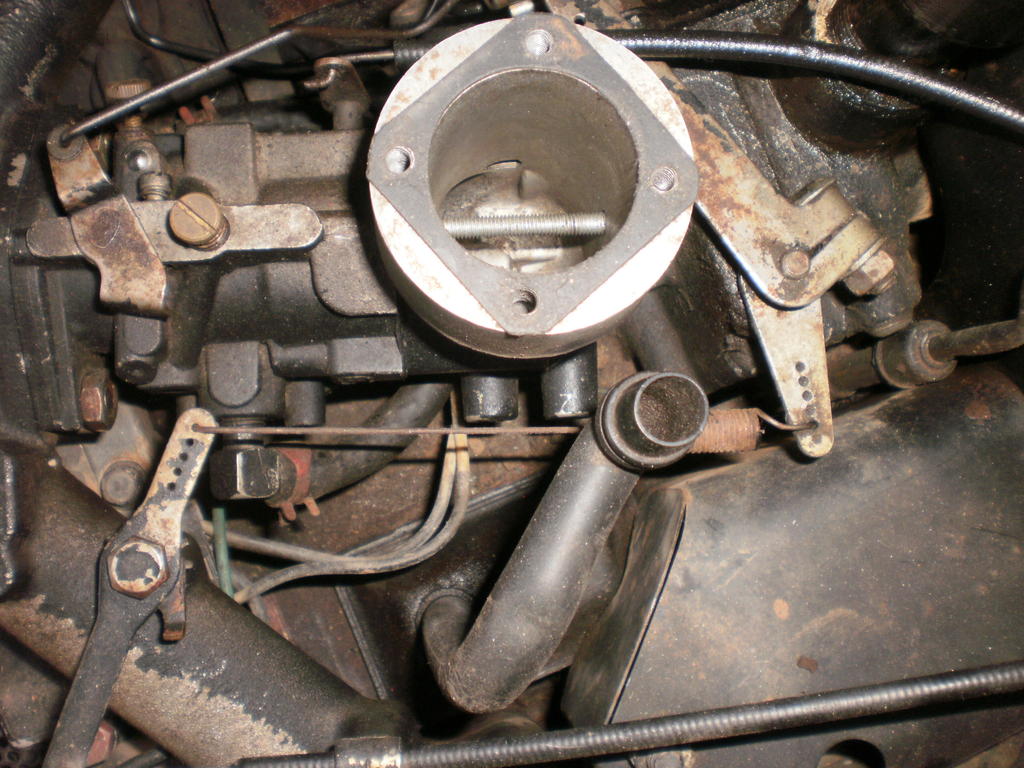

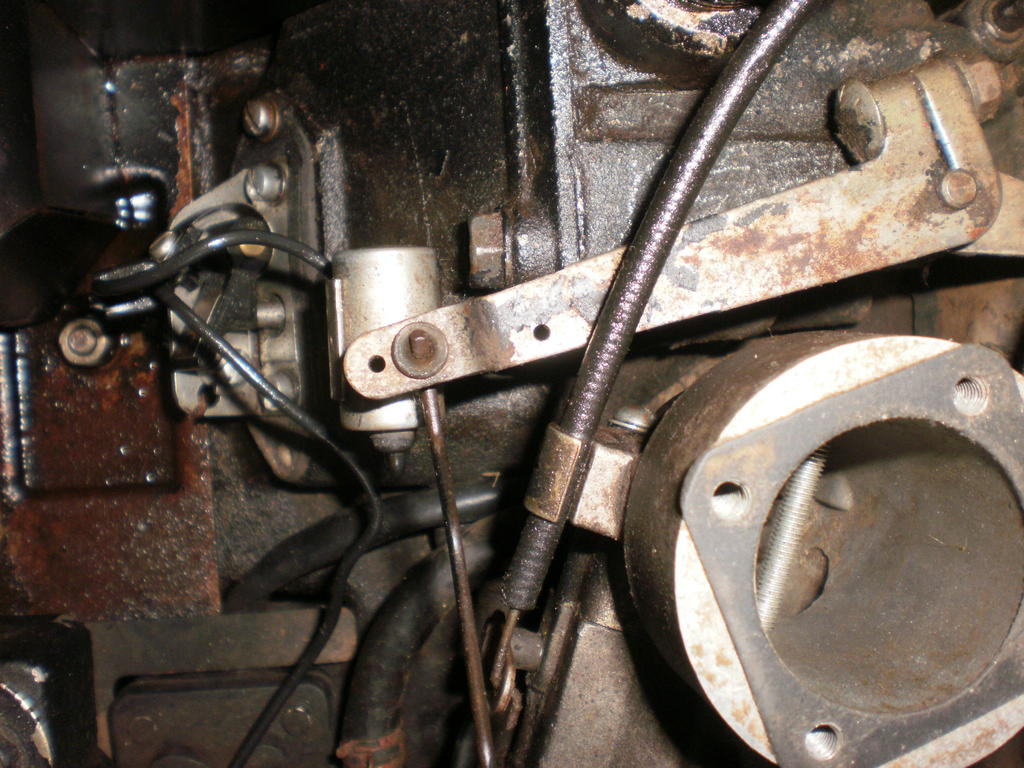

The Gman 476 #8 Posted March 20, 2019 It's possible the govenor is off. There should be no spring tension on the arm connecting the arm to the cross shaft of the govenor. If there is then the govenor might be tying to compensate it's position. Also look at the throttle arm that connects the the govenor to see that it is not distorted or hung up some how. It does have a series of bends as it works it way from the govenor arm to the throttle arm. Share this post Link to post Share on other sites

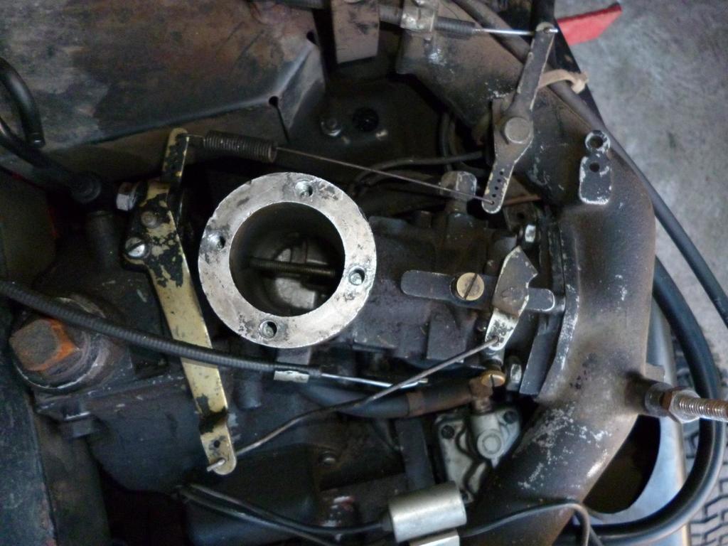

wheeliepower 141 #12 Posted March 21, 2019 hm it is a serie one kt17 carburetor cleaned the engine works great, turns up clean , except at low engine speed, the automatic readjustment I made a photo of the carburettor, maybe someone will notice something unusual. Share this post Link to post Share on other sites
pfrederi 21,300 #13 Posted March 21, 2019 The surging may be due to it running to lean at idle. The engine is starved for fuel slows the governor kicks into speed it up then it backs off and the cycle continues. Did you try backing out the idle fuel mixture a bit to richen the idle mixture? 1 Share this post Link to post Share on other sites
wheeliepower 141 #14 Posted March 21, 2019 yes I tried it (but even out to 2 turns, but no difference in the run) Maybe I have to do a new basic setting, but it works the engine great otherwise Share this post Link to post Share on other sites
pfrederi 21,300 #15 Posted March 21, 2019 Idle mixture changes take a few seconds to happen. Turn a wait a bit then turn some more. Other thoughts. The idle circuit has some very tiny hole/passages. The carb may look clean and the main circuit may be clean and work OK but the idle circuit could be plugged up. it would not really affect full throttle operation. One more thought. idle speed is 1250 that is faster than you might think. to low an idle speed is hard to maintain smoothly. 1 1 Share this post Link to post Share on other sites

Ed Kennell 47,809 #18 Posted March 21, 2019 I just checked the linkage on one of my KT 17s. I see the throttle link is is a different hole in my gov. arm. I don't think this would make any difference, but you could try the inner hole. Is your choke cable hooked up and could it be rubbing on the linkage rod? 1 Share this post Link to post Share on other sites
wheeliepower 141 #19 Posted March 22, 2019 no, choke cable is free 1 Share this post Link to post Share on other sites
