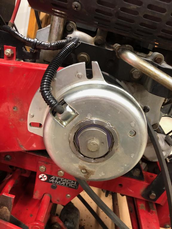

WHwest8597 85 #1 Posted March 20, 2019 I bought a 315-8 last June and the PTO had been recently replaced. I was given the old PTO with the purchase as well. I have had the tractor in storage at a friends. He went to take of the deck and noticed no quick connection on the new PTO wiring. Any suggestions on how to address the issue? Share this post Link to post Share on other sites
WVHillbilly520H 10,379 #2 Posted March 20, 2019 6 hours ago, WHwest8597 said: I bought a 315-8 last June and the PTO had been recently replaced. I was given the old PTO with the purchase as well. I have had the tractor in storage at a friends. He went to take of the deck and noticed no quick connection on the new PTO wiring. Any suggestions on how to address the issue? It would be easy enough to cut the wires and add "bullet" or "spade" crimp on or solder terminals to allow for a disconnection point, I would probably locate this near the drive belt guard so the rest of the harness is attached securely. 2 Share this post Link to post Share on other sites
JoeM 10,309 #3 Posted March 20, 2019 Can you take the center bolt out and slide the PTO off the shaft and remove the belt? Share this post Link to post Share on other sites

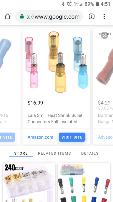

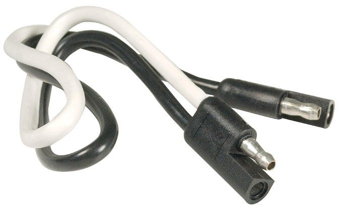

gwest_ca-(File Mod) 12,489 #4 Posted March 20, 2019 One of these polarized connectors would work. Install it so the hot wire from the switch is connected the the insulated female side. No chance of a short when disconnected. There are lighter ones but this one has 10ga wires. Garry 1 2 Share this post Link to post Share on other sites
