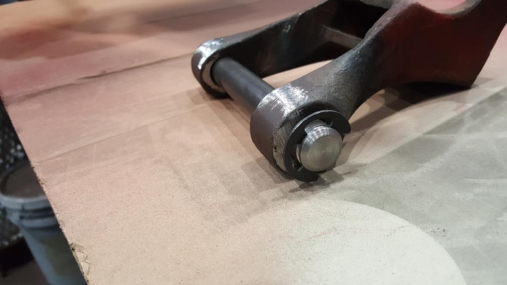

bellevillerod 835 #27 Posted March 22, 2019 Well got the hitch and pin issue taken care off tonight. One down and many more to go. Forgot to bring in the axle key to start on a brass one for welding up the keyways. For the longest time I was a round hood fan, these short hood horses are starting to really grow on me. 4 2 Share this post Link to post Share on other sites

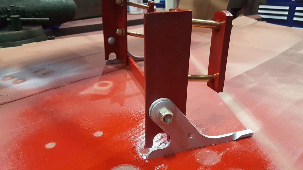

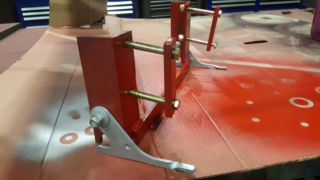

bellevillerod 835 #30 Posted March 22, 2019 Was also able to hurry up an knock off the plow bracket before I got off work. This thing was bent three ways to Sunday, used hard by the looks of it. I took a torch to it and was able to straighten out the latch arms and the angle iron. Sand blasted it all real good and a couple coats of paint. I was pleased with the way it turned out. When I took it off it did not look like it had been installed right. But I will have to look for pics to see how the old style brackets are supposed to be installed before it goes back on. 2 1 Share this post Link to post Share on other sites
bellevillerod 835 #31 Posted March 22, 2019 I just went to WHP&M and looked at the pic's. I see the arms are on backwards, something didn't look right...lol 2 Share this post Link to post Share on other sites

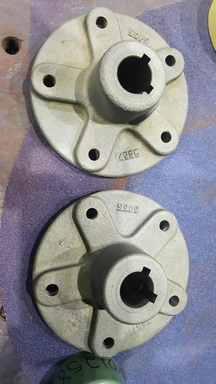

bellevillerod 835 #32 Posted March 23, 2019 (edited) Ok some talk of the broach to cut a keyway in the hub. Here are a couple of pics of the process. Edited March 23, 2019 by bellevillerod 2 Share this post Link to post Share on other sites
Howie 900 #33 Posted March 24, 2019 Yep, bought myself one of those to have around. Not hard to do! Share this post Link to post Share on other sites
pfrederi 20,226 #34 Posted March 24, 2019 On 3/22/2019 at 11:46 PM, bellevillerod said: Ok some talk of the broach to cut a keyway in the hub. Here are a couple of pics of the process. How do you work this. Use a press of some kind? How many passes to get the keyway deep enough??? Share this post Link to post Share on other sites
bellevillerod 835 #35 Posted March 24, 2019 Ya I used a hyd press, and it took 3 passes to get it cut to depth. After the first pass you slide a shim, top pic, behind the broach and go again. If you need it to be deeper you put another shim behind and go again. Most keys are are two shims deep. 1 1 Share this post Link to post Share on other sites
