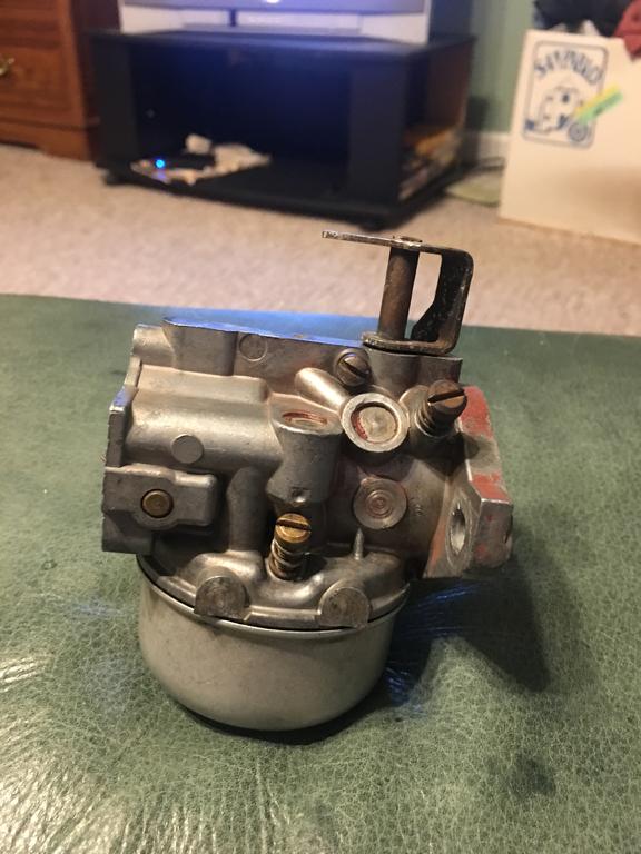

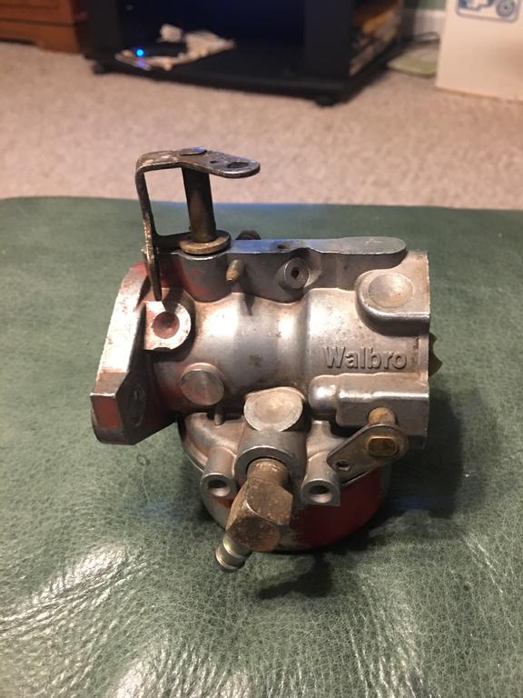

The Tuul Crib 7,354 #5 Posted March 20, 2019 Here’s a couple of pics of the carb and it seems to be in great shape Share this post Link to post Share on other sites
