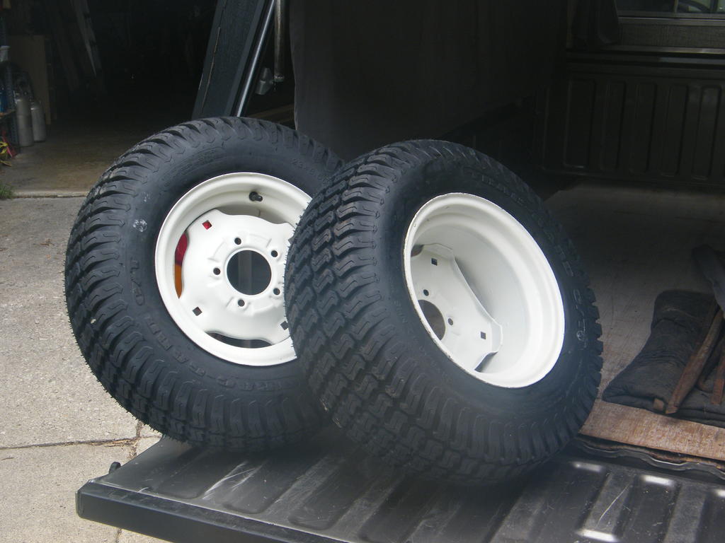

stevasaurus 23,834 #27 Posted March 18, 2019 If you take some soft copper tubing and hammer it flat, you can use it behind any holes and then weld on the rim. The weld will not stick to the copper...save a lot of grinding. Helps if you have a daughter that welds. Did electrolysisto get rid of rust. 5 Share this post Link to post Share on other sites

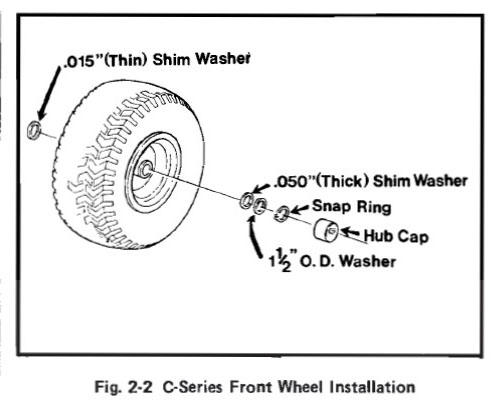

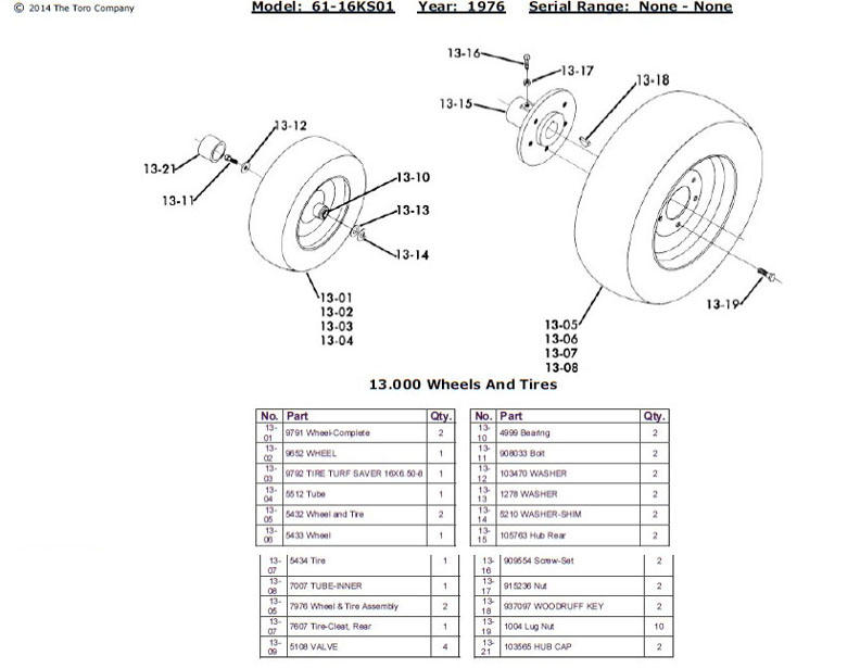

HappyHillbilly 86 #31 Posted March 19, 2019 5 hours ago, pullstart said: I’m not sure what shims you are talking about, the wheel is usually right on the hub. By by the way, many people grab a handful of fine thread 7/16” bolts and run those into the hub from behind, then run standard lug nuts. Yeah, the front ones. Haha! No problem. Been there, done that. Plus - I didn't specify for what tractor. It's a '76 C160 Automatic. The '76 Parts List varies a tad from the '78 Service Manual. The first photo below is from the '76 Parts Manual & the 2nd photo is from the '78 Service Manual. I can sort out the discrepancies between the two. Also - one wheel has a cotter pin holding it in place while the other front wheel has a bolt. I find it odd but think that's the way it was made & not altered. 3 hours ago, stevasaurus said: If you take some soft copper tubing and hammer it flat, you can use it behind any holes and then weld on the rim. The weld will not stick to the copper...save a lot of grinding. Helps if you have a daughter that welds. Did electrolysisto get rid of rust. The copper sounds like a good tip. Those wheels look really nice. Good work!Tell your daughter I said; "Kudos." 1 hour ago, 953 nut said: Ace Hardware has a huge selection of thin thrust washers. I have gotten 18 Gauge (0.050") and 14 Gauge (0.078") 3/4"thrust washers there, they were about a buck each. Thanks! I'll take a look at the Ace I found the throttle shaft thrust bearings at. I thought some of the listed parts suppliers would have them but I've searched quite a few of them & eBay to no avail. I'll find what I need or hand-file a washer into a shim. Haha! 1 Share this post Link to post Share on other sites

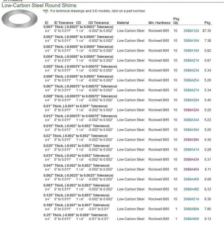

pfrederi 21,141 #33 Posted March 19, 2019 Shims. I keep .01 .02 1 1 Share this post Link to post Share on other sites
HappyHillbilly 86 #34 Posted March 19, 2019 10 hours ago, pfrederi said: Shims. I keep .01 .02 You're the man! Thankfully - and surprisingly - I remembered you posting info about a thrust bearing in my very first thread here. So I Google "low-carbon round shims" and scroll down a few lines & recognize the company name. They have a warehouse 2hrs south (Atlanta) and I got the assorted set and it will be here tomorrow for the cost of ground shipping. Oh, yeah! 1 Share this post Link to post Share on other sites
