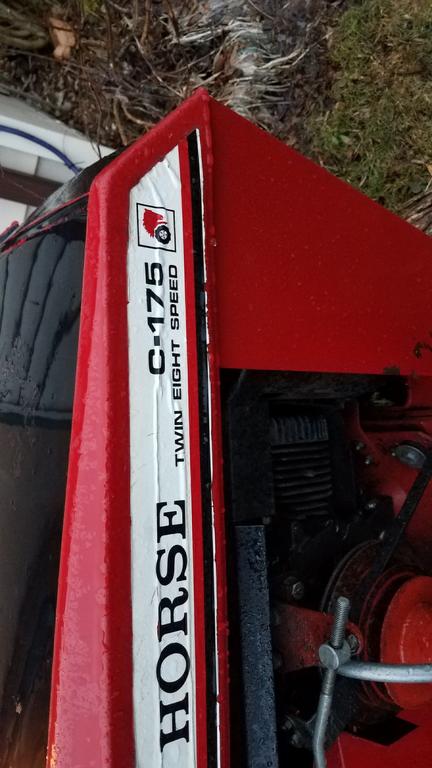

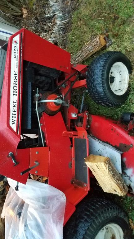

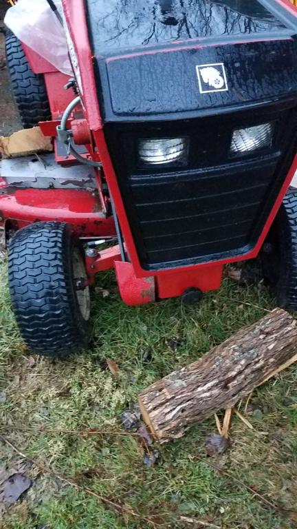

Chris G 3,369 #1 Posted March 16, 2019 So I am looking for opinions on this particular machine. Any pros or cons and anything specific to watch out for. The photos are of the one i will be looking at. The owner says deck is solid, just primed were paint peeled and started to rust. Has a extra set of new spindles, pulleys, and belts. Also comes with a snowblade, tire chains and weights. It runs and drives and no smoke or leaks he says. 5 Share this post Link to post Share on other sites
Mikey the Monkey 701 #2 Posted March 16, 2019 chris this is not a round hood, but you better save it and get it out of the rain. people are gonna wanna know what series engine it has 5 Share this post Link to post Share on other sites
SylvanLakeWH 30,574 #3 Posted March 16, 2019 Love the Black Hoods! 5 Share this post Link to post Share on other sites
Skipper 1,790 #4 Posted March 16, 2019 Doubt you be disappointed, if price is right. I would prefer a hydro, but that's just me. Besides that, the 1x5 blackhoods are the best they ever made, if you ask me. Simple, rugged, dependable. 4 Share this post Link to post Share on other sites
AMC RULES 37,254 #5 Posted March 16, 2019 I'm not askeered of no series one... a beast of a machine they are. 11 Share this post Link to post Share on other sites

pfrederi 19,869 #14 Posted March 16, 2019 Check the Spec number on the engine. If it is 24300 or higher it is the better Series II. A lower spec number is a Series I. The less than stellar track record of that engine would be grounds for negotiating a lower price. If it it were me I would buy it with either engine as long as it ran OK but hey if I could get him to knock a couple bucks on a a Series I why not.... 2 1 Share this post Link to post Share on other sites

ebinmaine 77,305 #16 Posted March 17, 2019 I know you have the skills to repair the deck anyhow but if you can, bring a scraper of some sort. Screwdriver, whatever... That deck doesn't look amazing. I'm not a fan of leaving exposed primer. 2 Share this post Link to post Share on other sites

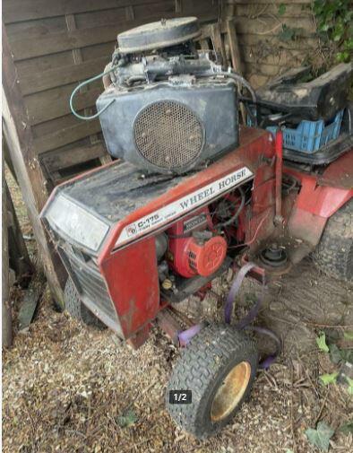

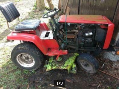

Maxwell-8 4,370 #20 Posted February 23, 2022 (edited) You don't see them so often. those C175 8-speeds One popup today on the local secondhands btw: in Belgium this one is considered to be in nicer shape then average Edited February 23, 2022 by Maxwell-8 6 1 Share this post Link to post Share on other sites
sjoemie himself 3,106 #21 Posted February 23, 2022 Looks pretty good compared to what's in my shed 2 Share this post Link to post Share on other sites
Maxwell-8 4,370 #22 Posted February 23, 2022 (edited) 30 minutes ago, sjoemie himself said: Looks pretty good compared to what's in my shed I am messaging the owner, to maybe get a deal. Don't have room nor time to get this project. But if we can get the price right why not. He is asking €350 currently Picked up this manual Jacobsen 1250 past weekend. . EDIT: I guess things move fast, Going to pick it up tomorrow Edited February 23, 2022 by Maxwell-8 4 2 Share this post Link to post Share on other sites
kpinnc 17,144 #23 Posted February 23, 2022 (edited) 2 hours ago, Maxwell-8 said: guess things move fast, Going to pick it up tomorrow You're getting more horses across the pond than most of us here! Outstanding! That pic with the Kohler twin set on top of the hood certainly proves the black hoods can support some weight! I would expect that to crush most other hoods! Edited February 23, 2022 by kpinnc 1 1 1 Share this post Link to post Share on other sites
