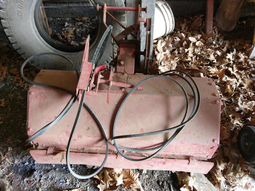

Daron1965 644 #1 Posted March 15, 2019 Hello all. I've decided to try and find a tiller for my 312 8. I know there are a few different models and mounts. Can someone please tell me what mount and model of the tiller I need? Even pictures would be helpful, because a few I have seen do not have any model numbers on them. Thank you, Daron Share this post Link to post Share on other sites

Racinbob 13,111 #4 Posted March 15, 2019 The newer style like the 77-36TL01 had the idler mounted on the tiller bracket and used the same axle bracket as the snow blade. You have to remove the slot hitch to mount the tiller. The older style like the 7-1211 had a different axle bracket and the idler was mounted on it. It also used a two belt drive with another idler set up mounted to the frame just in front of the transmission. It was a pain because you had to move the foot rest out and a second belt guard was used. An advantage was that you didn't have to remove the slot hitch. A bar was inserted in the hitch and lifted the tiller. I used the older style and utilized the newer single belt drive and had the best of both. 1 Share this post Link to post Share on other sites
WVHillbilly520H 10,379 #5 Posted March 15, 2019 I use this one on my 520s, you do need the rear axle bracket/hitch for a snow plow/blade and of course the rear rockshaft and cable for lifting... Share this post Link to post Share on other sites
gwest_ca-(File Mod) 12,456 #6 Posted March 15, 2019 The 312-8 was built 1985-2001. This list of tillers is in they order they were produced. Looking at the illustrated parts lists for each will show all the necessary pieces. Tiller DNA in the order they were produced 1966 tiller model RT-366 [Driven by hydro transmission pulley. Drive belt 1586 replaced by 9714 (HA x 76" or 1/2" x 76")] 1967 tiller model RT-367 [Front drive belt 1586 replaced by 9714 (HA x 76" or 1/2" x 76") Rear drive belt 7358 (4L x 65.95" or 1/2" x 65.95")] 1968-1973 tiller model 7-1211 [Front drive belt for short frame models 867, 875, 876, 87 and 1075 #1576 replaced by 9691 (HA x 70" or 1/2" x 70") Front drive belt for long frame models #1586 replaced by 9714 (HA x 76" or 1/2" x 76") Rear drive belt for all #7358 (4L x 65.95" or 1/2" x 65.95")] 1973-1974 tiller model 7-1251 [Drive belt # 1599 (HA x 139.00in 1/2" x 139") If used on later twin-cylinder models use belt # 103635 which has been replaced by # 110265 (1/2" x 141.00")] 1975 tiller model 7-1252 [Drive belt # 1599 (HA x 139.00in 1/2" x 139") If used on later twin-cylinder models use belt # 103635 which has been replaced by # 110265 (1/2" x 141.00")] 1976 tiller model 67-36TL01 [Drive belt # 1599 (HA x 139.00in 1/2" x 139") If used on later twin-cylinder models use belt # 103635 which has been replaced by # 110265 (1/2" x 141.00")] 1977 tiller model 77-36TL01 [Drive belt # 1599 (HA x 139.00in 1/2" x 139") If used on later twin-cylinder models use belt # 103635 which has been replaced by # 110265 (1/2" x 141.00")] 1977 tiller model 77-36TL02 [Drive belt # 1599 (HA x 139.00in 1/2" x 139") If used on later twin-cylinder models use belt # 103635 which has been replaced by # 110265 (1/2" x 141.00")] 1978 tiller model 87-36TL01 [Drive belt # 1599 (HA x 139.00in 1/2" x 139") If used on later twin-cylinder models use belt # 103635 which has been replaced by # 110265 (1/2" x 141.00")] 1979 tiller model 97-36TL01 [Drive belt # 1599 (HA x 139.00in 1/2" x 139") If used on later twin-cylinder models use belt # 103635 which has been replaced by # 110265 (1/2" x 141.00")] 1980-1982 tiller model 07-36TL01 [Drive belt # 1599 (HA x 139.00in 1/2" x 139") If used on later twin-cylinder models use belt # 103635 which has been replaced by # 110265 (1/2" x 141.00")] 1983-1985 tiller model 07-36TL02 [Drive belt # 1599 (HA x 139.00in 1/2" x 139") If used on later twin-cylinder models use belt # 103635 which has been replaced by # 110265 (1/2" x 141.00")] 1986-1989 tiller model 07-36TL03 [Drive belt # 1599 (HA x 139.00in 1/2" x 139") If used on later twin-cylinder models use belt # 103635 which has been replaced by # 110265 (1/2" x 141.00")] 1990-1991 tiller model 07-36TL04 [Drive belt # 103635 which has been replaced by # 110265 (1/2" x 141.00")] 1992 tiller model 07-36TL05 [Drive belt # 103635 which has been replaced by # 110265 (1/2" x 141.00")] 1993-2001 2003-2007 tiller model 79370 [Drive belt # 103635 which has been replaced by # 110265 (1/2" x 141.00")] The hardware to lift the tiller was the biggest difference 1973-1977 Garry Share this post Link to post Share on other sites
