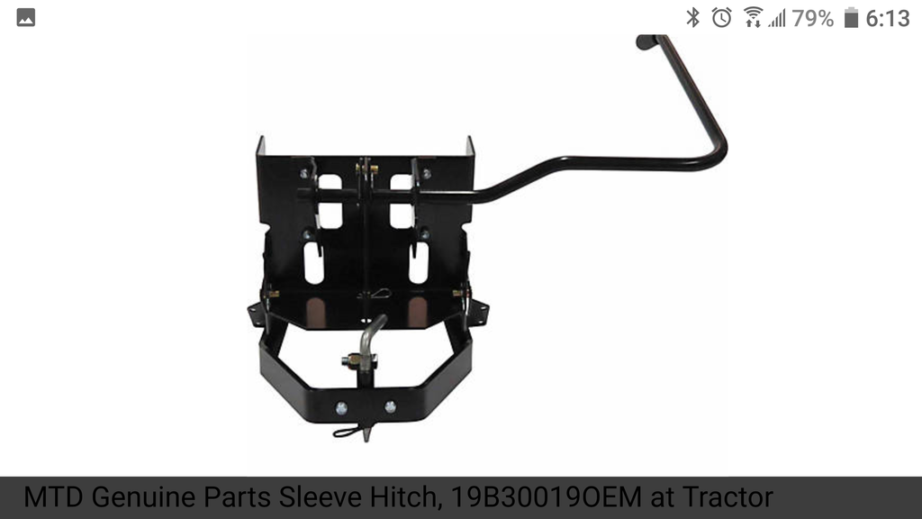

DiscoveryFarm 0 #1 Posted March 15, 2019 I have a bucket on my 310-8 which uses the lift handle. I also have a sleeve hitch installed that I need to use. I am trying to figure out a good lift handle fabrication idea. It is my understand that I can use the built in lift handle either/or front or rear. So leaving the bucket operational does anyone have any suggestions on how to fabricate a manual lift handle? maybe with diagram or photo? Share this post Link to post Share on other sites
953 nut 69,829 #2 Posted March 15, 2019 You may want to convert the front bucket to a winch lift like @Justy37 has done, then the sleeve hitch can be used independently. 2 Share this post Link to post Share on other sites
Lee1977 7,805 #3 Posted March 15, 2019 (edited) Or you can put the winch on the back. I used a receiver hitch to mount the winch. and modified the sleeve hitch. Edited March 15, 2019 by Lee1977 2 Share this post Link to post Share on other sites
WVHillbilly520H 10,379 #4 Posted March 15, 2019 There's the old Sears/Craftsman style rear hitch lift or add an electric actuator... Share this post Link to post Share on other sites
