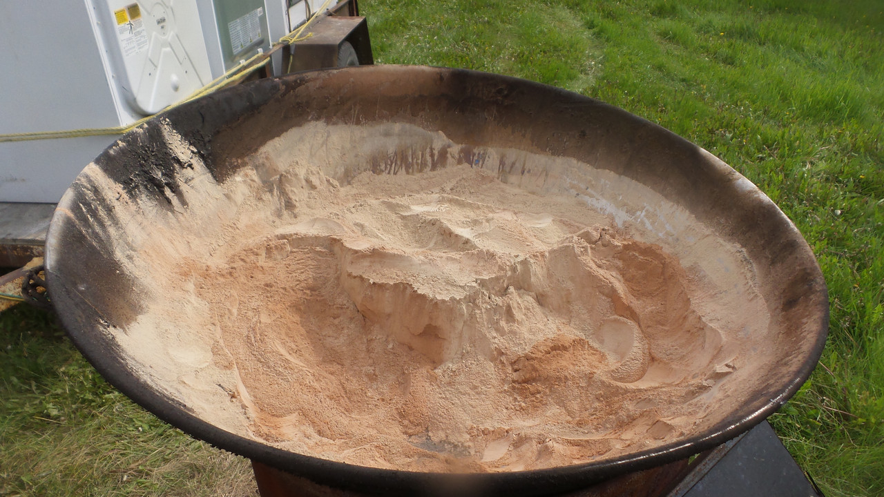

bc.gold 3,406 #128 Posted June 12, 2022 The quartz about 1000 pounds brought back from B.C., ball milled and roasted. An unexpected surprise as the volatilies were gassing off, small eruptions caused the heavies to settle out in layers. Top layer, tan in color then brick red then black on the very bottom. My first thought - magnetite. The deposited blacks turned out to be non magnetic, hopefully something precious. Not sure when I'll get around to refining this material as someone gave me the heads up on a house being sold for $5,000.00. Needs work upstairs a leaking roof damaged the plaster, seems lath and plaster repair is a lost art. The damage in minimal so I'll now have the opportunity to learn something new. I'd almost bet my last dollar that the strange growth around the base of the tree if sold could cover the purchase price of the house. It's a very large burl that I'm going to dig out. . Share this post Link to post Share on other sites

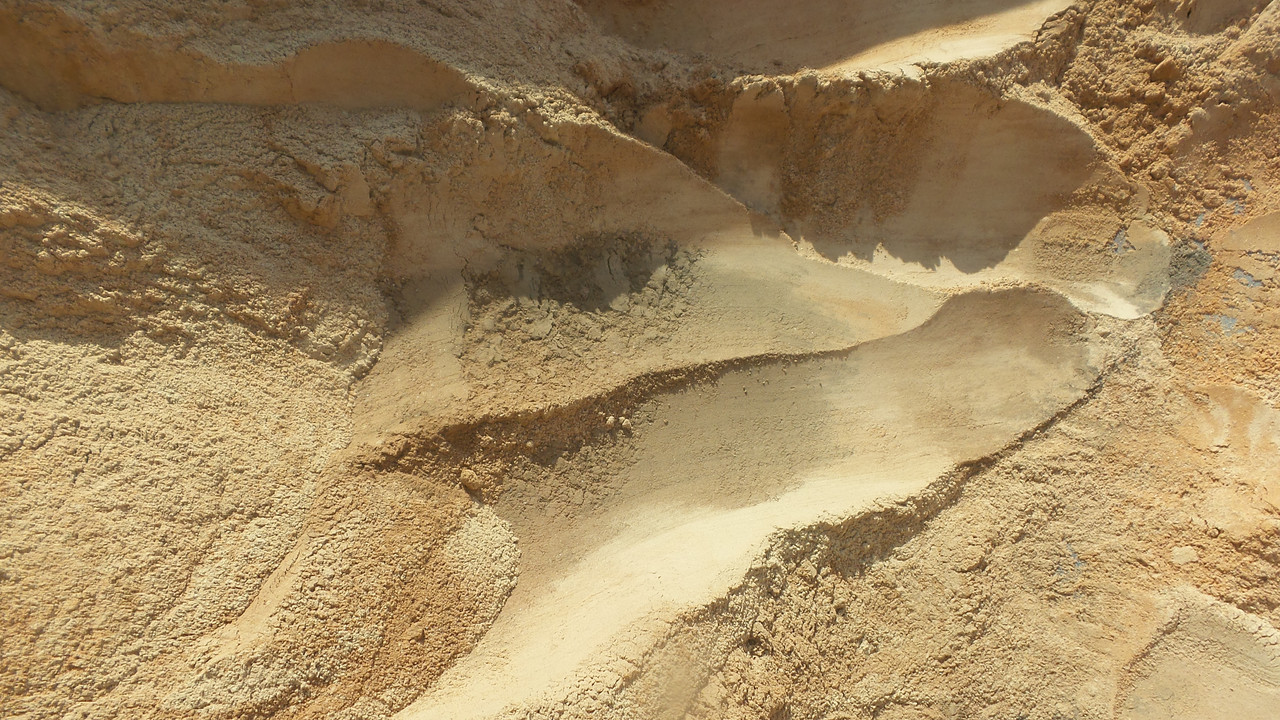

bc.gold 3,406 #131 Posted June 22, 2022 Finally have all of the quartz milled into powder, ready for gold extraction. Share this post Link to post Share on other sites

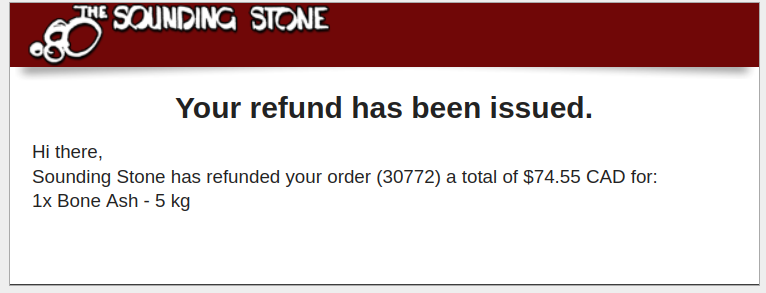

bc.gold 3,406 #133 Posted June 22, 2022 (edited) 35 minutes ago, Jeff-C175 said: That's amazing! What causes that? Gold would be Au, purple is a copper oxide and the blue most likely cobalt oxide. Cupelling the lead button went all wrong, the bone ash I had purchased from a pottery supply house was a synthetic product and it would not soak up the oxides. Once I brought this to their attention they refunded me in full for the purchase price and shipping, also changed their product identification to reflect the true nature of the product. Edited June 22, 2022 by bc.gold 1 Share this post Link to post Share on other sites
Handy Don 17,017 #134 Posted June 24, 2022 On 6/22/2022 at 12:45 AM, bc.gold said: Cupelling the lead button went all wrong, the bone ash I had purchased from a pottery supply house was a synthetic product and it would not soak up the oxides. What exactly is “ soak up the oxides”? Share this post Link to post Share on other sites
bc.gold 3,406 #135 Posted June 24, 2022 (edited) 38 minutes ago, Handy Don said: What exactly is “ soak up the oxides”? Base metals, ie: copper, cobalt ,lead iron and zinc will oxidize at high temperatures these oxides float on top of the molten lead then migrate into the bone ash cupel. Finally the lead will oxidize, leaving the noble metals behind as a precious metal button. The button will be a combination of noble metals contained within a particular ore sample, gold, silver and platinum. Lead is used in smelting as a collector mainly because it's cheap, copper and silver also work. The latter metals are processed via electrolysis. Metal oxides are also the basis for pottery glazes and used to add color to glass. Color can distinguish a glass container, shield its contents from unwanted ultraviolet rays or create variety within a brand category. Color can be obtained by simply adding small quantities of different oxides: Chromium (for green) Cobalt (for blue) Nickel (for violet/brown) Selenium metal (for red) Edited June 24, 2022 by bc.gold 1 Share this post Link to post Share on other sites

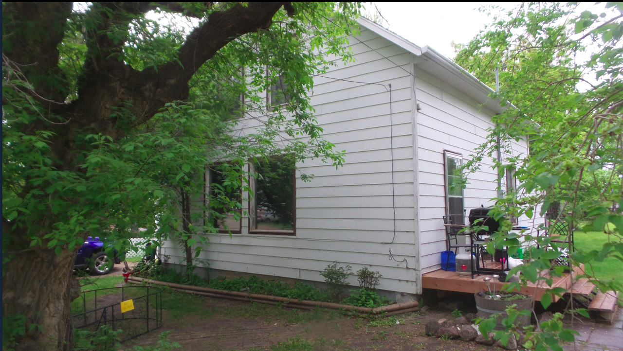

bc.gold 3,406 #137 Posted July 6, 2022 On 6/12/2022 at 2:21 AM, bc.gold said: The quartz about 1000 pounds brought back from B.C., ball milled and roasted. An unexpected surprise as the Not sure when I'll get around to refining this material as someone gave me the heads up on a house being sold for $5,000.00. Needs work upstairs a leaking roof damaged the plaster, seems lath and plaster repair is a lost art. The damage in minimal so I'll now have the opportunity to learn something new. I'd almost bet my last dollar that the strange growth around the base of the tree if sold could cover the purchase price of the house. It's a very large burl that I'm going to dig out. . Yesterday was the first time I had been in Strathclaire at noon, my house is located directly behind the municipal yards. I now know why the house sold cheap. This very loud siren sounds daily at 7 a.m., noon, 6 p.m. and 10 p.m. Yet as your entering town they have a sigh posted, prohibiting the use of Jake brakes within the town limits. A noise by-law. I'm on a mission, later today I'm going to take a decibel measurement of the siren then use whatever recourse is available to have this thing silenced. I believe if i were to advertise the house for rent arranging appointments for 12:00 noon my potential renter would run for the hills. A civil suit brought against the town for loss of revenue might possibly cut the power to the siren. Share this post Link to post Share on other sites
lynnmor 8,921 #138 Posted July 6, 2022 What would be the purpose of this siren besides annoying the neighbors? Share this post Link to post Share on other sites
Jeff-C175 7,209 #139 Posted July 6, 2022 2 hours ago, bc.gold said: sounds daily at 7 a.m., noon, 6 p.m. and 10 p.m. Why? Share this post Link to post Share on other sites
Jeff-C175 7,209 #140 Posted July 6, 2022 1 hour ago, lynnmor said: What would be the purpose of this siren besides annoying the neighbors? I think I know... It's to prevent alien robots from taking over the town. It's working so far! 1 1 Share this post Link to post Share on other sites

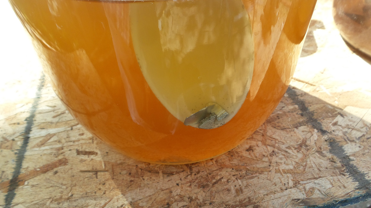

bc.gold 3,406 #144 Posted September 11, 2022 On 6/21/2022 at 11:05 PM, bc.gold said: Finally have all of the quartz milled into powder, ready for gold extraction. Small sample of ore, the amber solution is gold in cyanide, the darker one is gold being displaced with zinc. Share this post Link to post Share on other sites

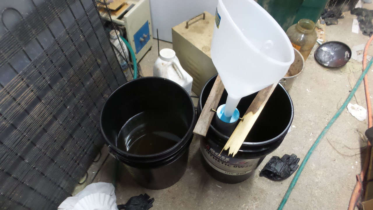

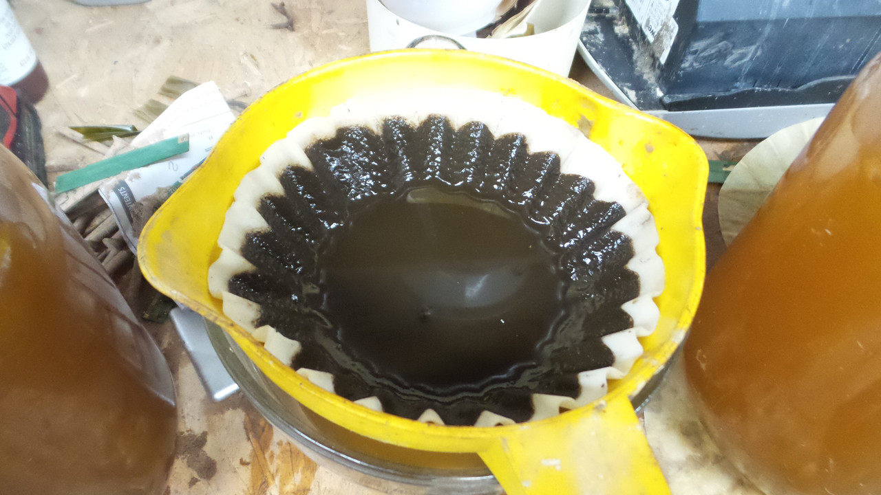

bc.gold 3,406 #145 Posted September 24, 2022 From four gallons of leach, the zinc cemented out plenty of gold. This will be further refined to separate the gold, silver and any platinum that maybe present. There was no visible gold in that quartz, it was hidden in the sulfides. The gold in the filter is from cementing the leach liquor with zinc, the somewhat baron leach was then passed through an actuated carbon filter. The liquid leaving the carbon filter came out crystal clear. When this project has been completed the carbon will be dried then burned, any precious metals will be in the ash to be further refined. Share this post Link to post Share on other sites

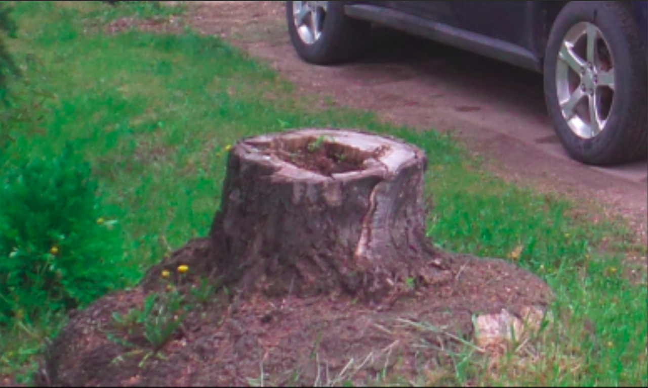

bc.gold 3,406 #146 Posted June 28, 2023 On 6/12/2022 at 10:15 AM, Handy Don said: Digging it out will be a bit of a job, and then cleaning. I agree, though, it is likely to bring a nice price at a mill that specializes in veneers of exotic woods. They'll want it whole, too! Stump was too rotten, amazingly was using the angle grinder nearby and some sparks set the stump smouldering like a Halloween punk. Gone on a week roots an all just a hole to fill in now. Share this post Link to post Share on other sites

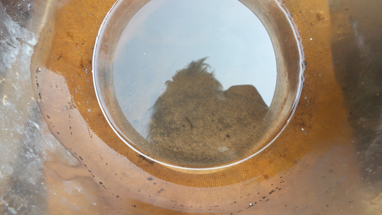

bc.gold 3,406 #147 Posted June 28, 2023 An update on the BC quartz, from six pails of ball milled ore I'm down to this. Share this post Link to post Share on other sites

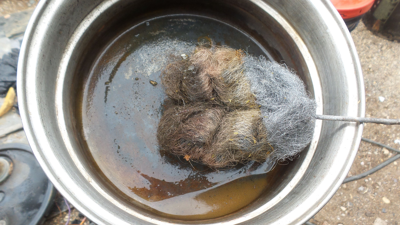

bc.gold 3,406 #148 Posted June 28, 2023 Gold from computer scrap being electroplated from the leach onto steel wool, later the wool gets dissolved to recover and further refine the gold into a higher purity. 1 Share this post Link to post Share on other sites

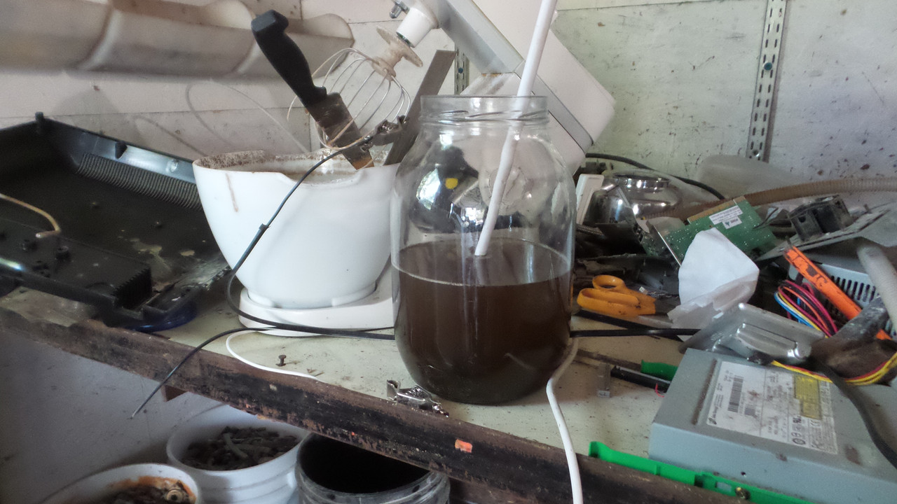

bc_gold 214 #150 Posted September 30, 2024 More gold from the quartz, the leach is so dark red needed a light behind the jar. Share this post Link to post Share on other sites
