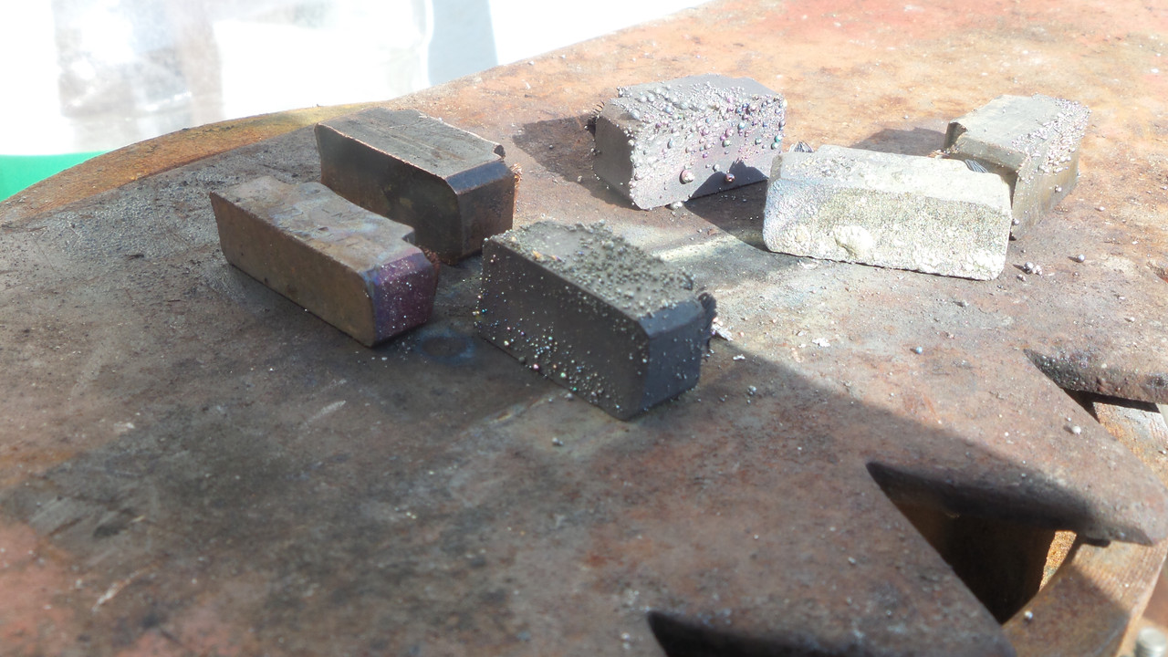

bc.gold
Testing some worn out starter brushes for silver, when the brush is heated the silver sweats out in little beads maybe while their good and hot a centrifuge would bring all the silver out.

Now have 161 grams of brushes, I don't thing the newer ones have as much silver in them as I could not get any to sweat out while burning off the oil and grease but did see some evidence of silver.

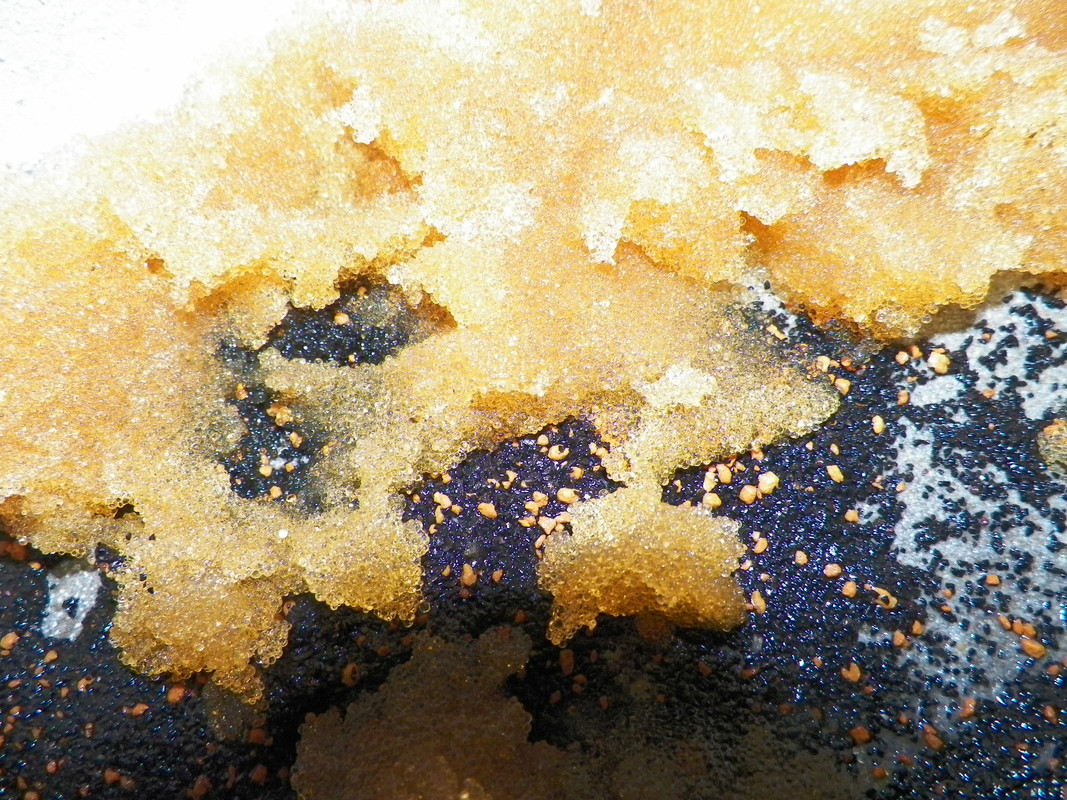

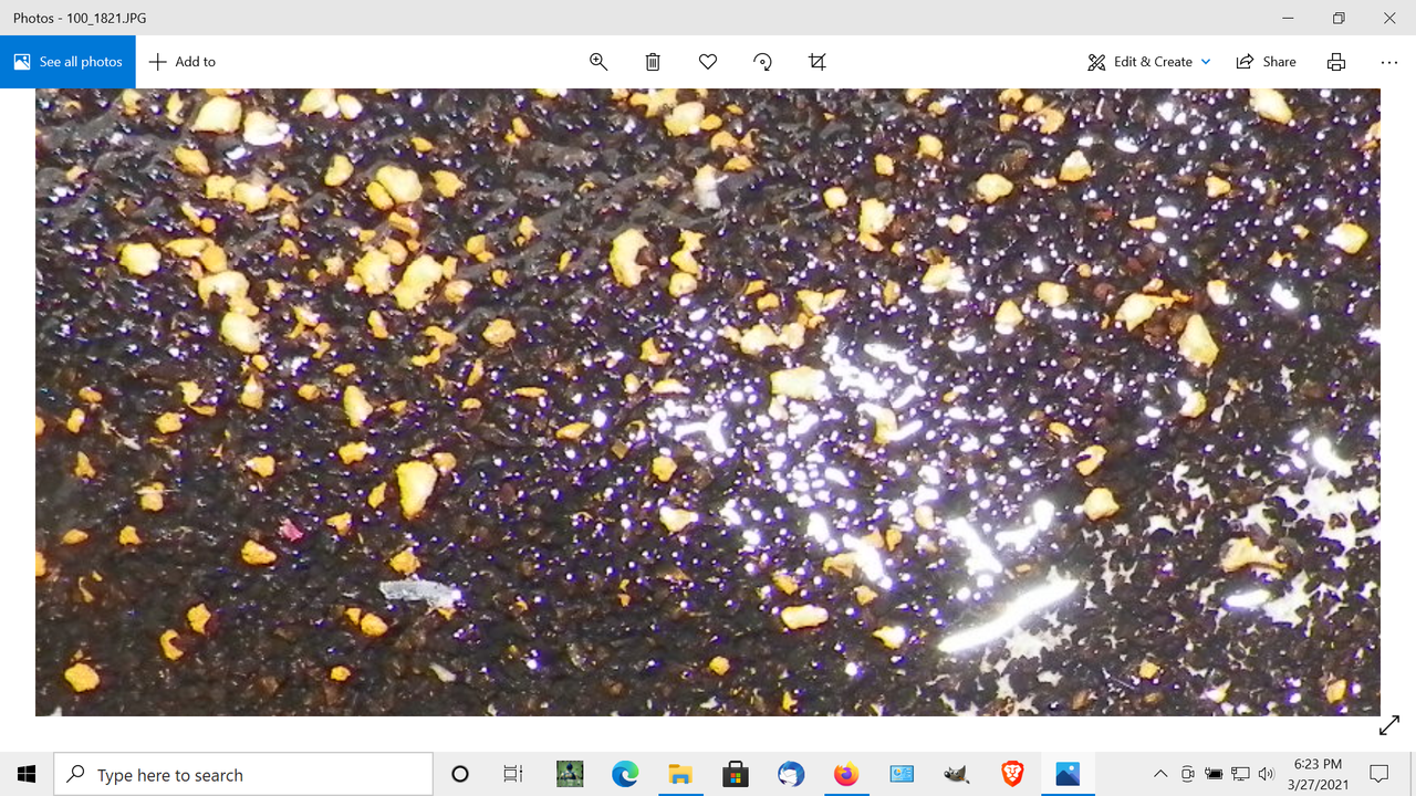

Made an interesting discovery, ion exchange filter from a water softener has gold in it.
I think the ion canisters get clogged beyond capacity when the home owner neglects to keep the brine tank filled with salt, the brine flushes the ion canister and rejuvenates the beads.

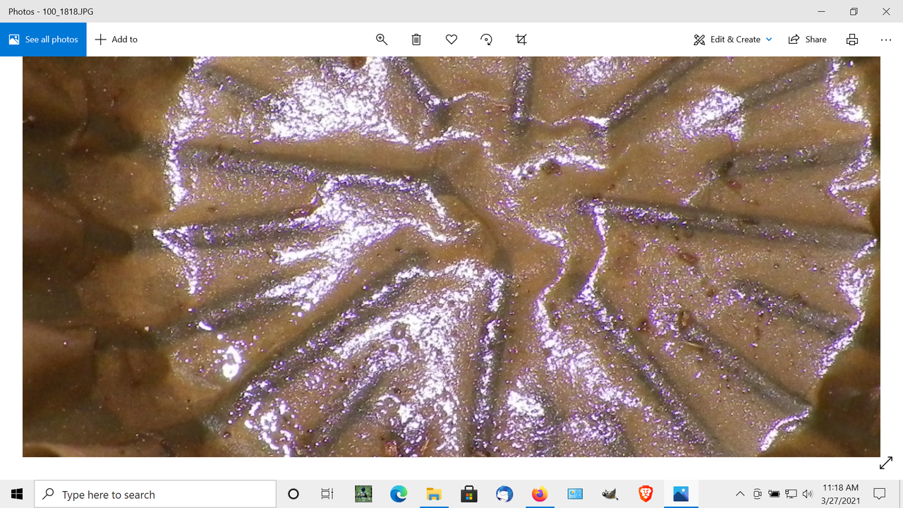

Out of curiosity tested about a quarter pound of beads and this is what I got from it.
Jeff-C175
Zeolite resin?  has gold in it?  Really?
bc.gold
No, the colloidal gold in the water was attracted to the beads.
The beads did not dissolve in aqua regia, just what was on the surface of the beads did. Plenty of iron oxides but have an idea how to separate the gold in a more economical way via electrolysis.

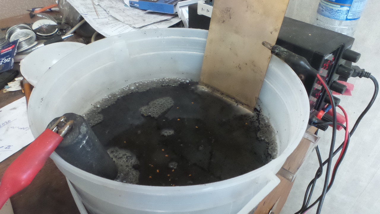

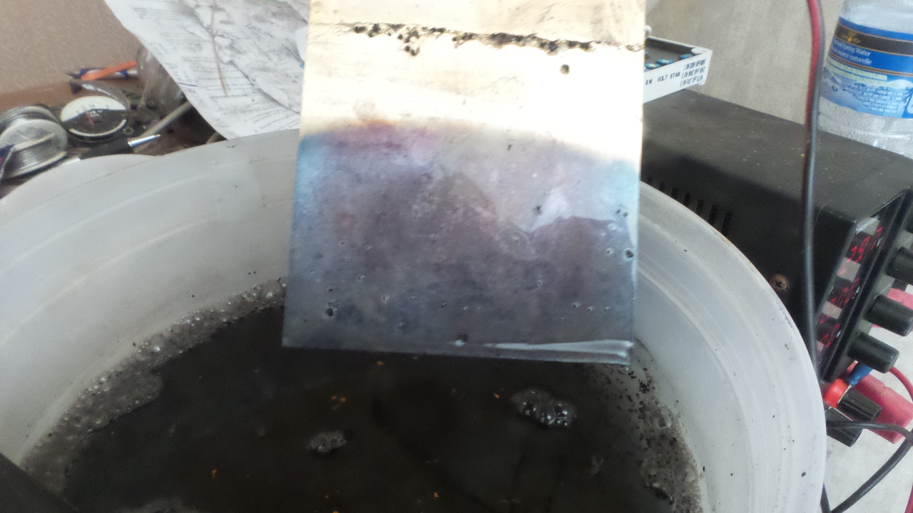

bc.gold
Went back to the landfill for more canisters, one is about 30 inches in diameter and 5 ft tall, needed help to get it loaded.
So far cut one open, this one has a lot of calcium and had lots of small rocks ( half inch minus ) on the bottom which must have played havoc with the pump impeller.
A test sample for the second canister the beads look clean and show no presence of gold.

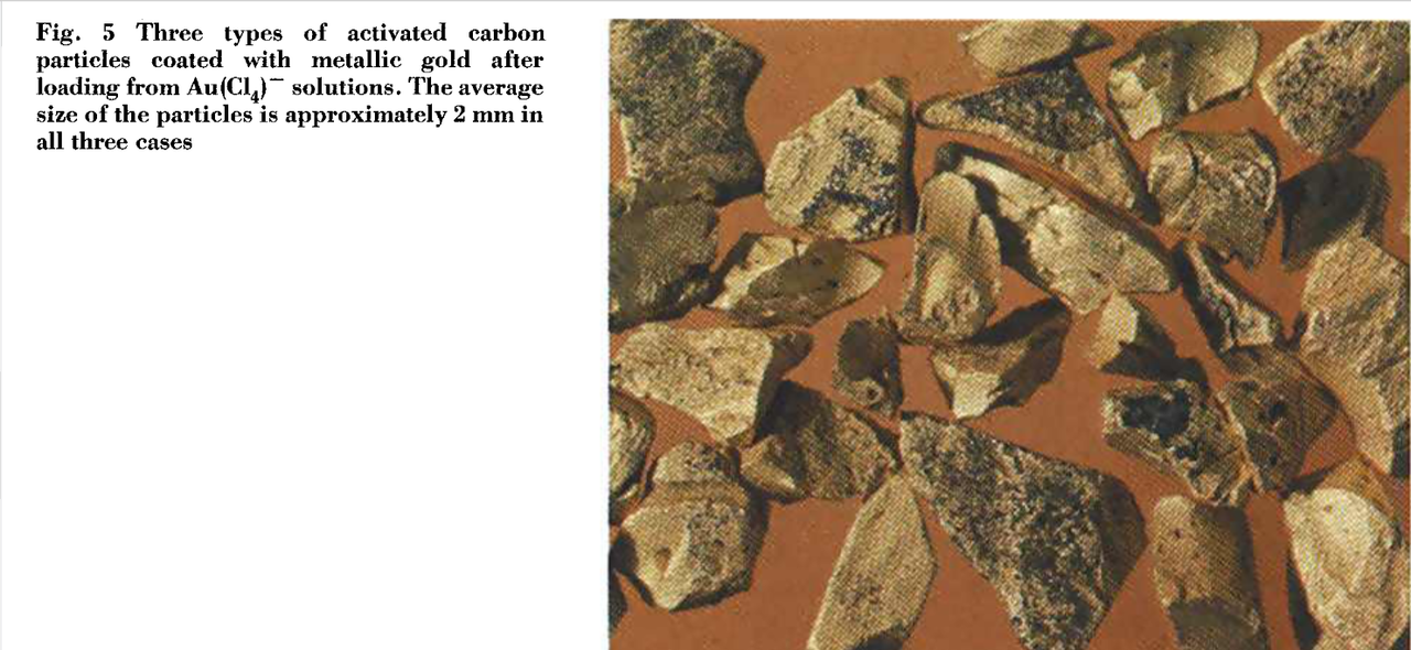

Two choices to recover the gold, stainless steel sheet used as an anode with another as cathode, this should strip the gold out, seconded option is activated carbon.
Read an article last night were the author claimed one ton of activated carbon is capable of absorbing 68 kilograms of gold. The easiest way to release the gold is to ash the carbon then refine the ash.
Last image gold impregnated carbon.

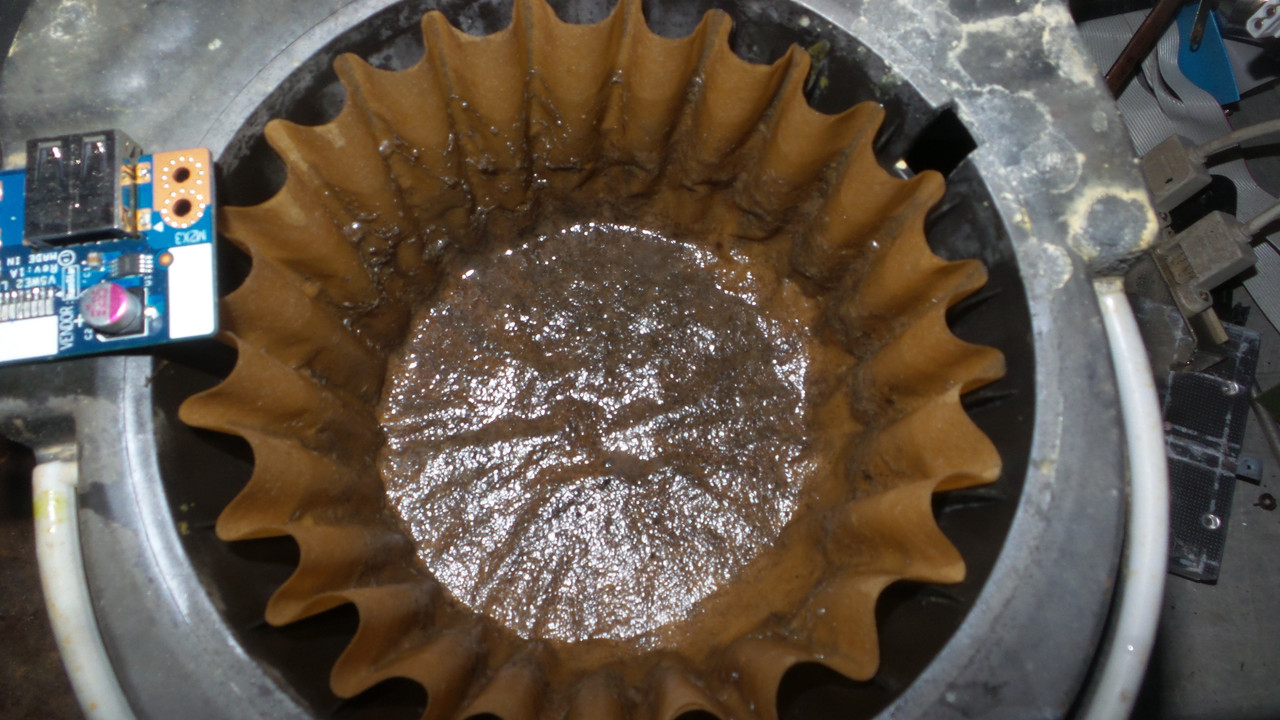

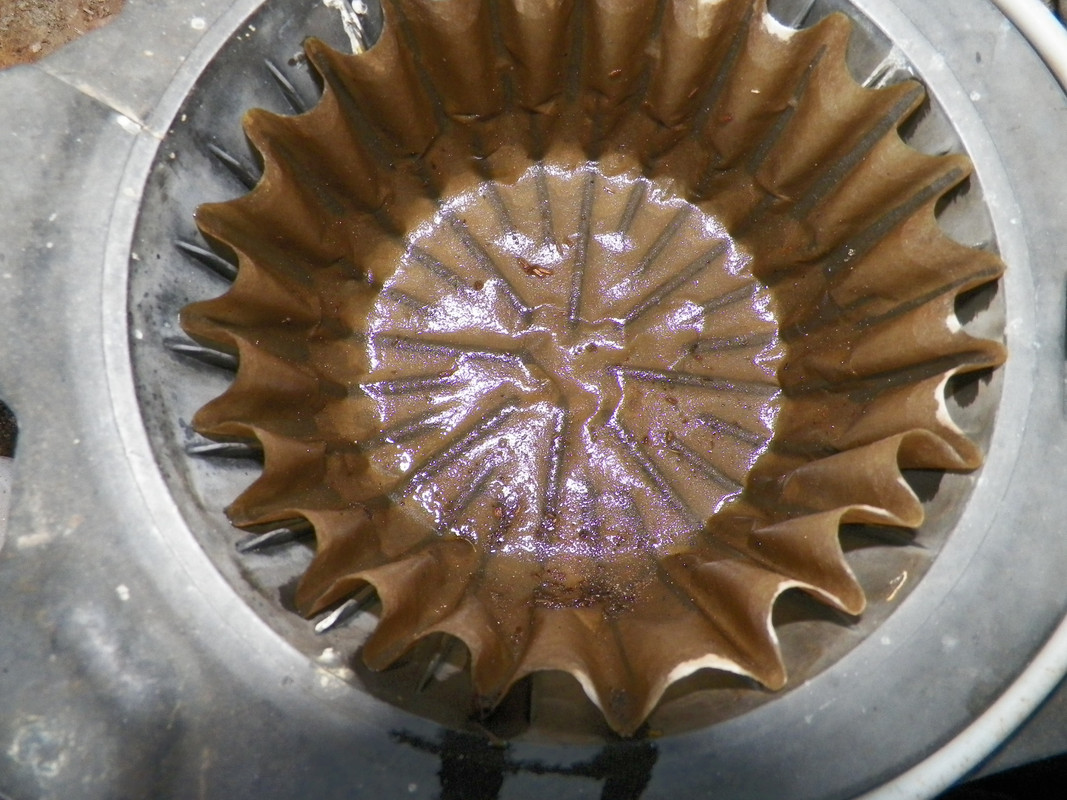

I stand corrected on that statement, the resin exchange beads used in a domestic water filter are not formulated to remove gold from ground water, the gold attached itself to the iron. Judging from my experiments these filters are rich.
Contacted one of the refinery's I deal with asking if they have processed water filters for the gold and they replied in the affirmative , so its obvious others are in the know.
Its often been said among prospectors that gold wears an iron hat and the Spanish claimed gold rode an iron horse. If your looking at filters for the gold you want ones filled with rust,
Two different experiment's each with different results, top filter processed with aqua regia and the bottom one just a simple dilute muriatic wash to remove the iron

Some success.

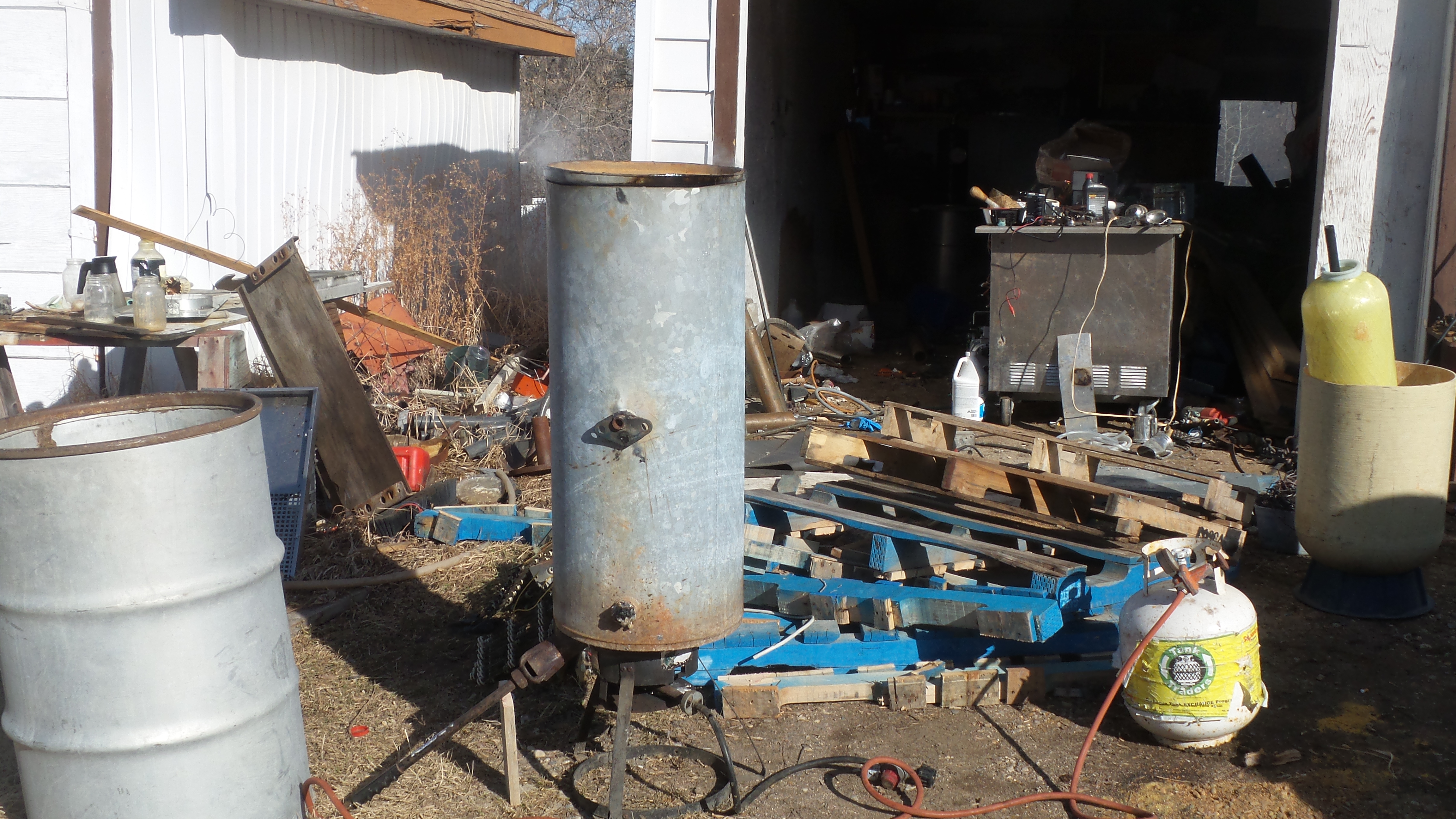

The chamber of commerce, making carbon.

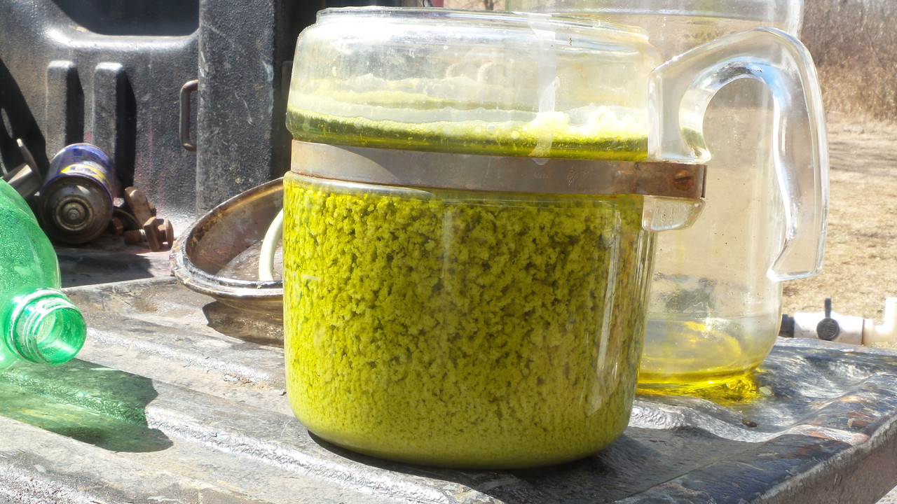

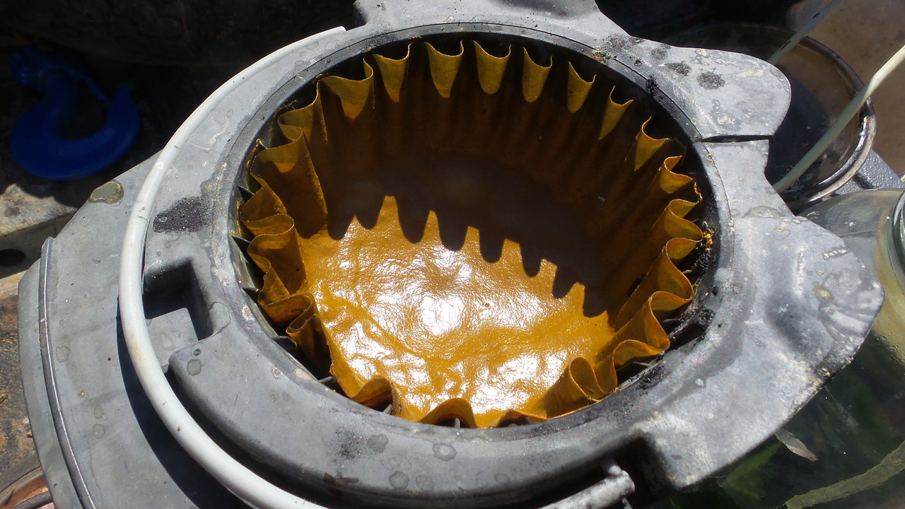

Palladium salts precipitated with DMG, the precipitate is canary yellow and contains about 33% palladium by weight.
Jeff-C175
45 minutes ago, bc.gold said:
canary yellow
What's that worth?  and what was the source material?
bc.gold
Source material catalytic converters from scrap vehicles. Value depends on how pure I'm able to refine it, as it is now there's some nickle in there.
The nickle came from the converters using metal foils instead of ceramic comb, I have yet to learn how to refine rhodium which is currently going nuts price wise and i expect it to worsen as things heat up with Russia a major producer.

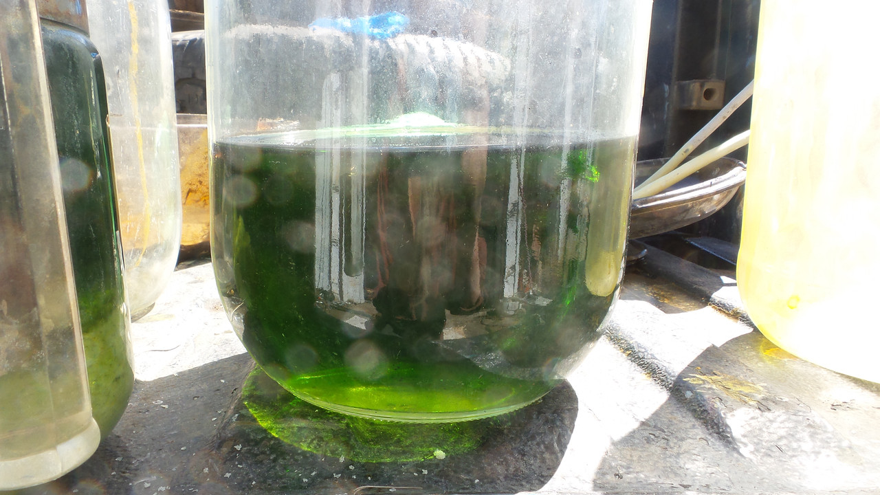

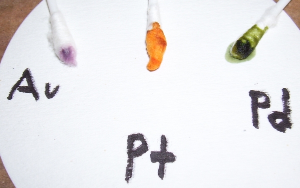

The ammonium chloride that I made was used to precipitate platinum as a brick red salt, the green liqueur still has be be processed for pt.
Stannous chloride is used as your eyes, each precious metal present has a specific color.
Just remember I'm a hobby refiner, started much to late in life to be a professional.
