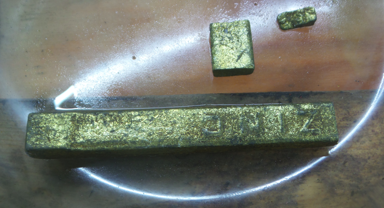

bc.gold 3,406 #28 Posted April 2, 2019 (edited) Small sample of the ball milled black sand digested in an acid has released more values. The early Spanish had it right gold rides an iron horse Edited April 2, 2019 by bcgold 1 Share this post Link to post Share on other sites

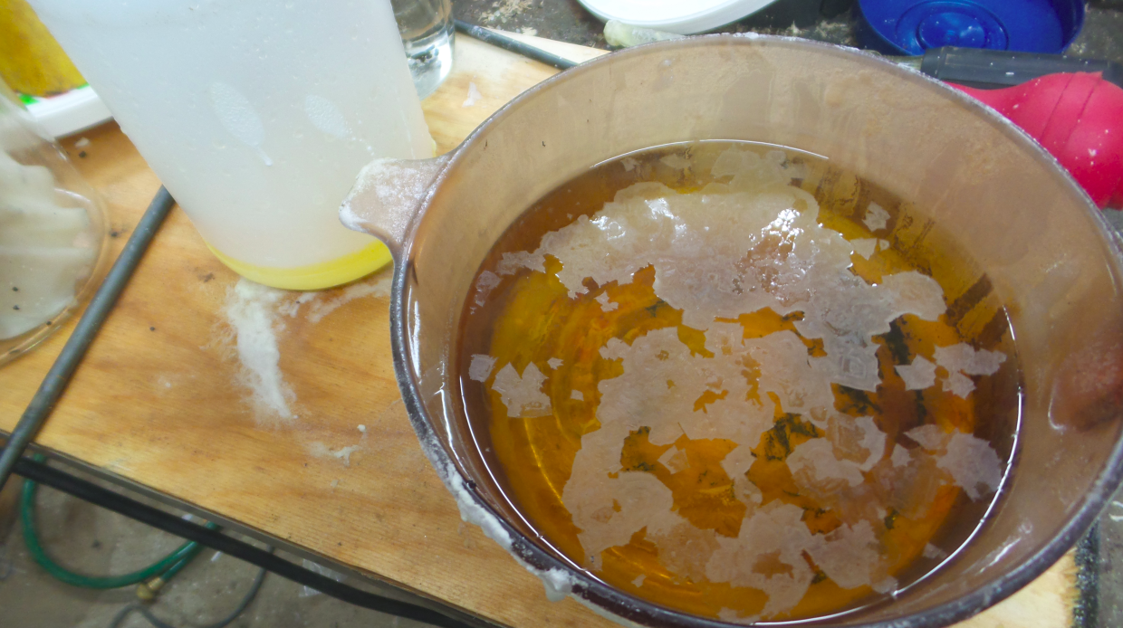

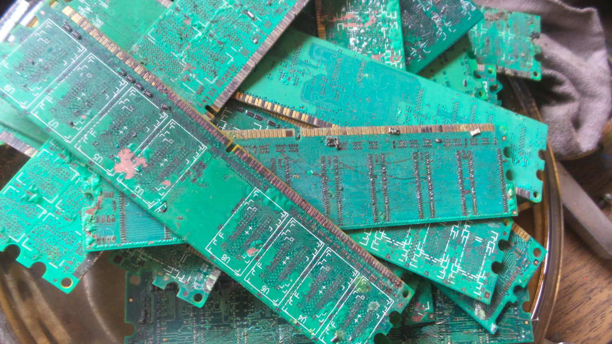

bc.gold 3,406 #30 Posted April 27, 2019 If this experiment is a success I'll post the results I'm hoping to achieve. Lead free solder is mainly tin with perhaps a small percentage of silver, the leach is saturated with enough tin that needle crystals have formed during the night as the hot pregnant leach cooled down. Share this post Link to post Share on other sites

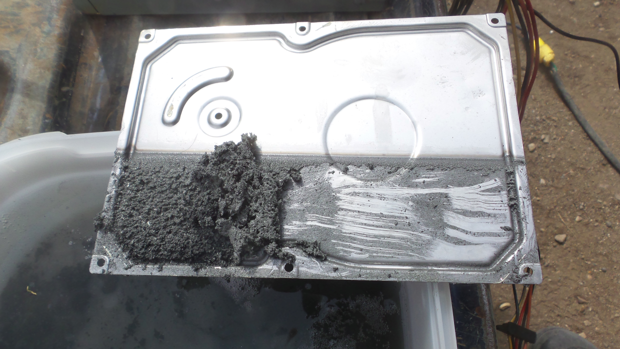

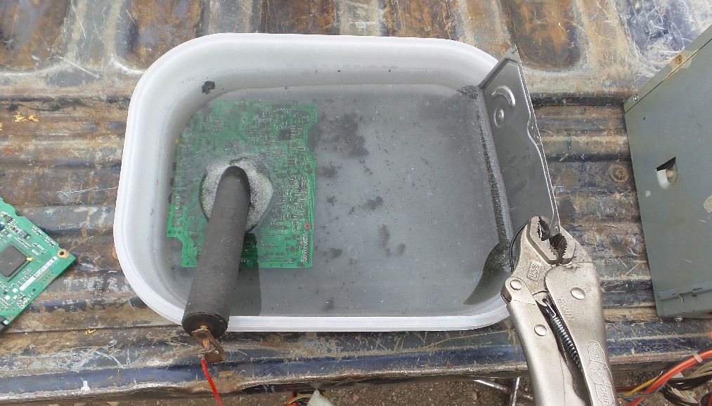

bc.gold 3,406 #31 Posted April 27, 2019 (edited) Follow up on the experiment, what your looking at on the stainless steel plate repurposed from a computer hard drive is the tin from the solder used on the ram sticks. The tin scraps off from the stainless steel surface effortlessly, this is called sponge. In the real world this sponge would get melted into anodes then re-refined. A unique property that tin metal has is that it cries when you bend it. https://en.wikipedia.org/wiki/Tin_cry Stannious Chloride a compound made from tin metal is used to detect precious metals in a leach, the bottom image show the telltale color's of each metal detected. Edited April 27, 2019 by bcgold Share this post Link to post Share on other sites
bc.gold 3,406 #32 Posted April 28, 2019 Part two of the experiment, tin will dissolve in a weak soloution of HCL whereas the silver alloyed with the tin solder will not, the black fluffy material laying on the bottom of the plastic container is silver oxide. Using an old power supply from a donor computer I've plated out the tin ions from the pregnant leach onto the stainless steel sheet and the silver which as now been converted to an oxide stays behind waiting to be harvested. Along with the silver it's quite possible there will be a small percentage of gold, when they manufacture the mother boards they use a process called wave soldering. As the molten solder passes over parts of the board that have been gold plated some of that gold is leached into the solder. Every so often they have to replace the solder with fresh as it has become much to contaminated with gold to do a proper soldering job. Share this post Link to post Share on other sites

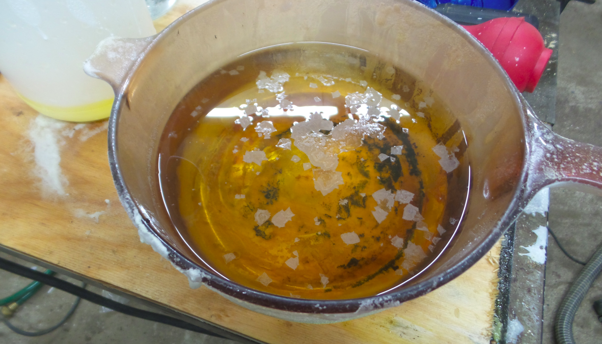

bc.gold 3,406 #37 Posted June 26, 2019 As the pregnant liquor cools down the crystals form the ammonium chloride crystals were made from household ammonia cleaner with hydrochloric acid added. Evaporating the water off causes the salts to fall out by morning there will be a thick layer of ammonium crystals laying on the bottom any impurity's will be left in the remaining liquor. This will be used to precipitate platinum. Share this post Link to post Share on other sites

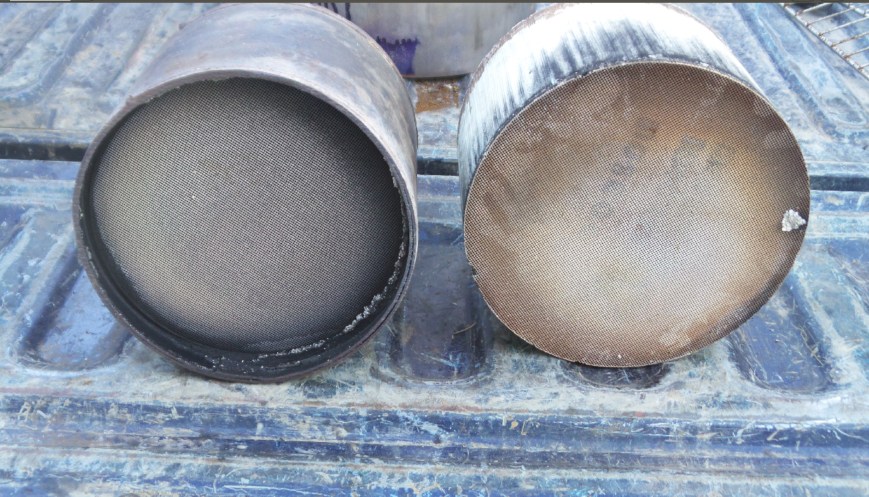

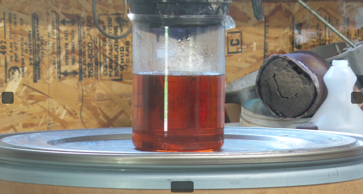

bc.gold 3,406 #38 Posted June 27, 2019 (edited) This pair of catalytic converters came from two different diesel trucks, the cat buyers pay around $600.00 us each. I'm going to attempt to get the precious metals from these and a few others that I have saved up for the occasion, this is why I needed the various types of precipitants for platinum. I delivered the diesel engines that I had sold into the big city and had a chance to purchase a few other chemicals and have a chat with the chemist. He thinks that my procedure will work at recovering the metals but in no way viable as a commercial operation where time and money needs a quick turn around to keep the flow happening. Anyhow here's what your diesel cat looks like inside. Edited June 27, 2019 by bcgold 2 Share this post Link to post Share on other sites

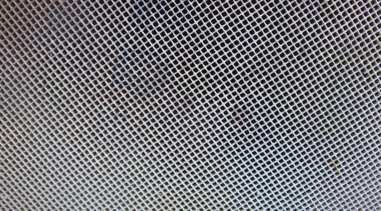

bc.gold 3,406 #41 Posted June 28, 2019 I have the large comb sitting in hydrogen peroxide which reacts with the platinum sisters to make small bubbles which in turn release the metals from the comb. This is in the experimental stages, I know it works but not sure what the recovery rate is yet. On my list of to do is build a fairly large ultrasonic tank using 25MHZ transducers which are pretty aggressive. The object is to have precious metals as concentrates for further refining. Share this post Link to post Share on other sites

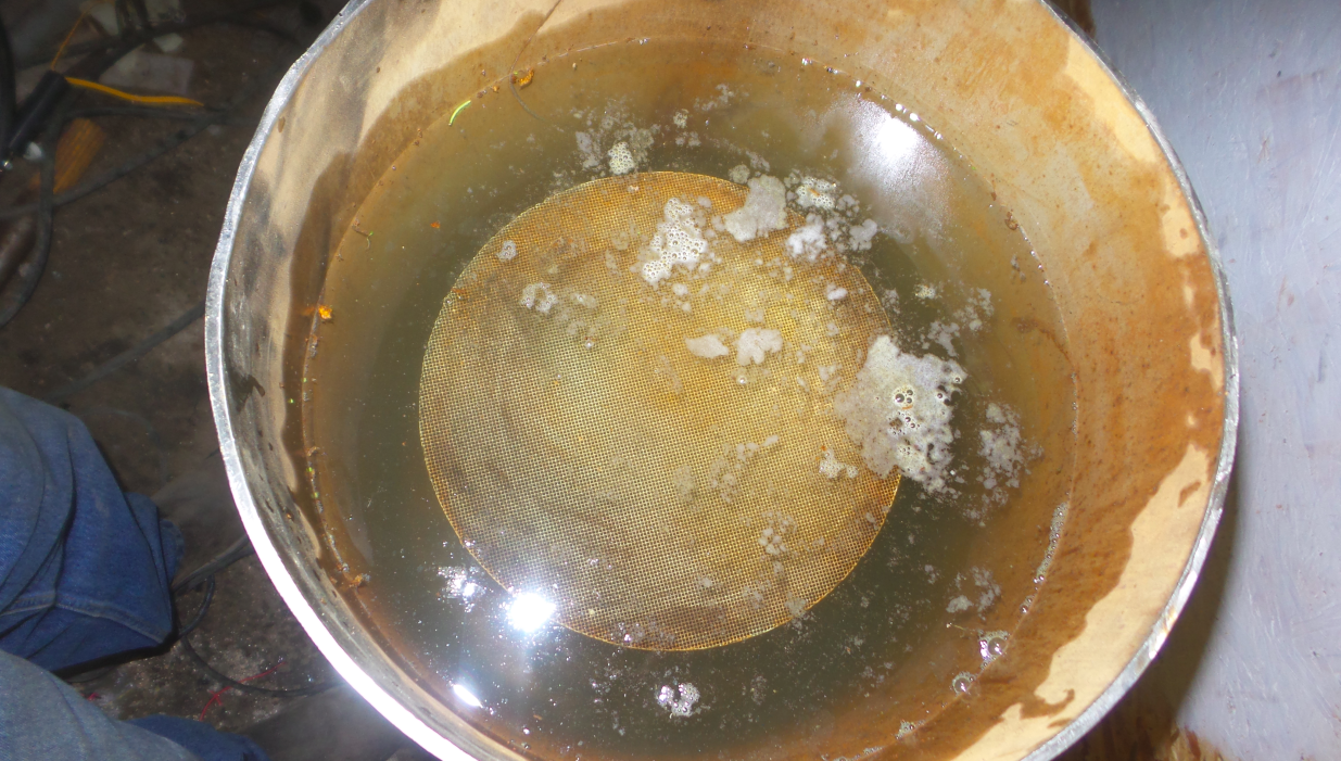

bc.gold 3,406 #43 Posted June 28, 2019 large comb looking good on the recovery, peroxide reacting with filtrate. The filtered solution goes back into the pot to do more work. Share this post Link to post Share on other sites

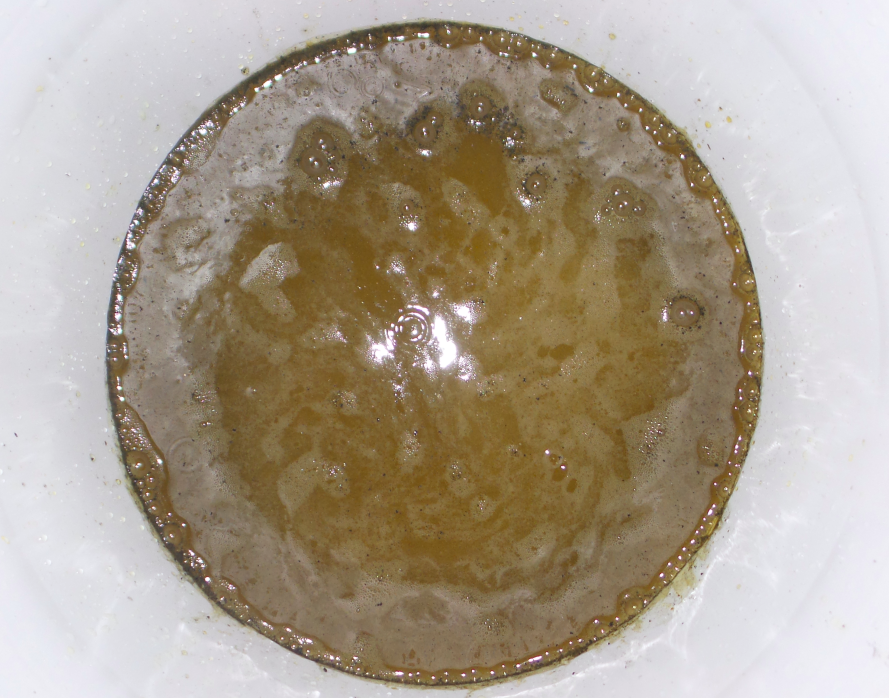

bc.gold 3,406 #44 Posted June 29, 2019 (edited) I've been using rain water from one of two barrels that Pat set out under the eve-troughs, never had any problems using it to refine gold and silver but this new process to recover platinum sisters from cats has produced unexpected results. There's enough sulfuric acid in the rain water that with the addition of a 10 percent hydrogen peroxide the combination makes a weak piranha solution but strong enough to take up the palladium sister into solution. https://en.wikipedia.org/wiki/Piranha_solution Of the six platinum sisters palladium is the weakest and she will giver herself up to a number of weak acids now we can add piranha to the list. For those of you that prefer a natural patina those unpainted areas are going to react to acid rain. The amber color of the solution was the give away, the palladium is easily recovered nothing is lost. Edited June 29, 2019 by bcgold Share this post Link to post Share on other sites

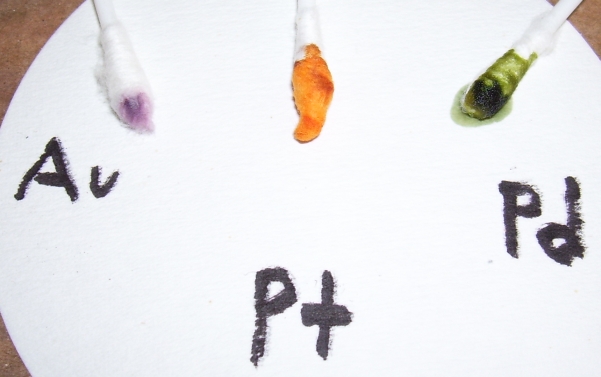

bc.gold 3,406 #48 Posted July 2, 2019 89.4 grams recovered. Palladium in solution. 1 Share this post Link to post Share on other sites

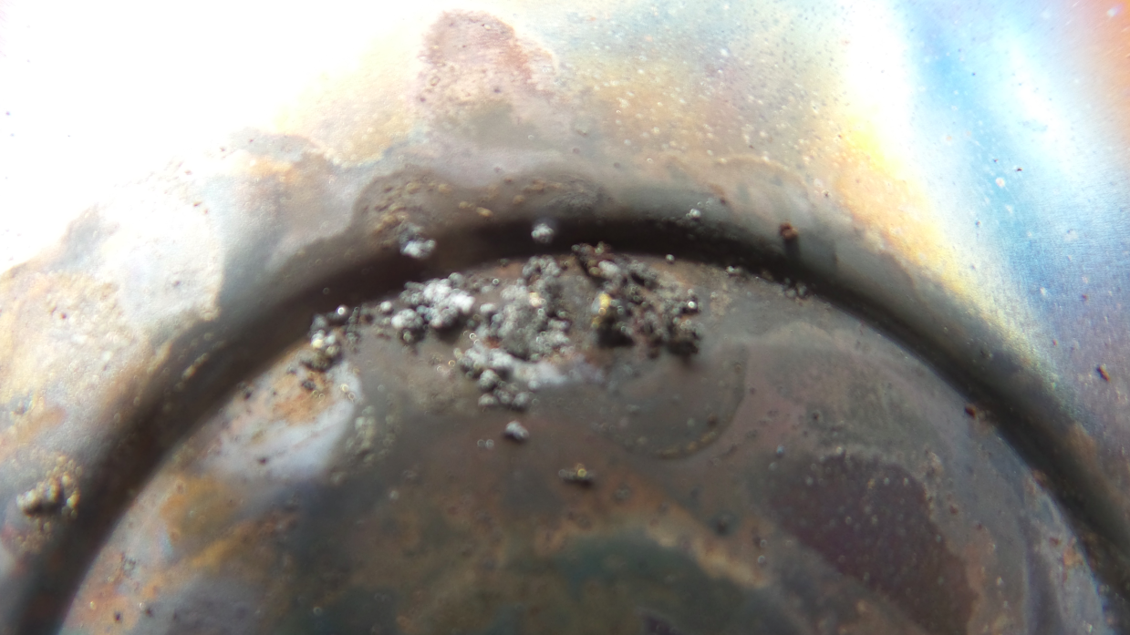

bc.gold 3,406 #49 Posted July 2, 2019 Found some gold, probably from the diesel cats. https://en.wikipedia.org/wiki/Catalytic_converter Definition - What does Immersion Plating mean? Immersion plating is the process of applying adhering layers of nobler metals to another metal's surface by dipping in a nobler metal solution ions to produce a replacement reaction. It causes the deposition of a metallic coating on a base metal from solutions that contain coating metal. In this, one metal is typically displaced by metal ions that have lower levels of oxidation potential, relative to the metal ion being displaced 2 Share this post Link to post Share on other sites

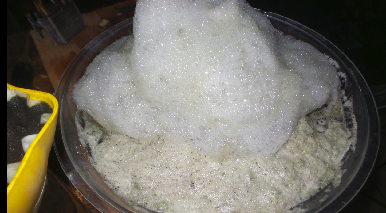

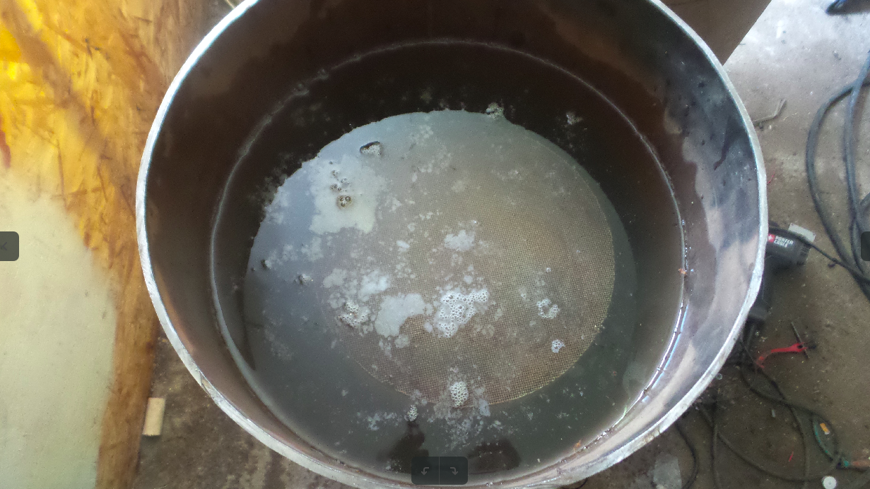

bc.gold 3,406 #50 Posted July 4, 2019 I added a few drops of dish soap into the water I used on the ultrasonic cell when something unexpected happened. A huge lot of foam started to form, so much that I had to physically remove it, placed it into my large bowl quickly ran out of room to accommodate the ever growing amount of foam being produced. The monster had taken on a life of its own, to make room for more foam had passed a flame over the foam forcing the bubbles to collapse. It immediately became apparent that precious metals had attached to this foam. I've heard and read about flotation cells used to recover precious metals but was lead to believe the chemistry of the liquids used in these cells to attached the metals to the bubbles was rather complex. The magic starts with the ultrasonic cell that I built and what it did to the soap. Ultrasonic cavitation is used to disperse nano-size particles into liquids, such as water, oil, solvents or resins. The application of ultrasonics to nanomaterials has manifold effects. The most obvious is the dispersing of materials in liquids in order to break particle agglomerates. In this image you can clearly see scum on the foam where I have passed the flame in comparison to the fresh foam added which appears more white. Share this post Link to post Share on other sites
