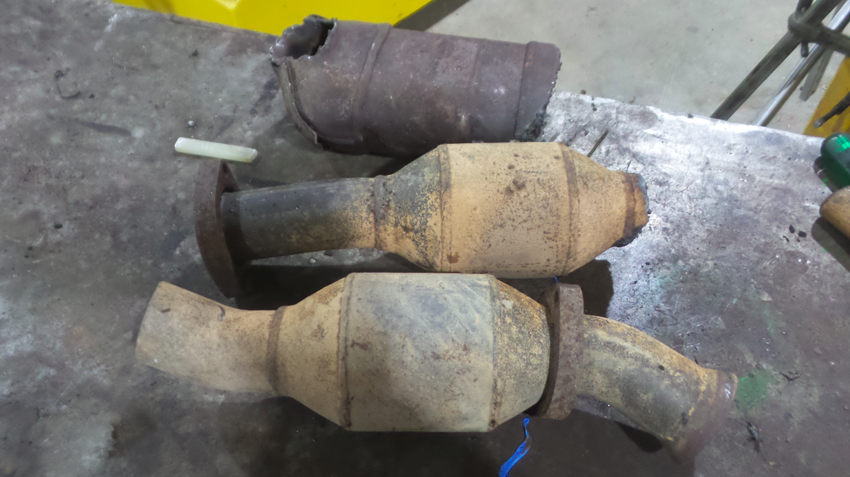

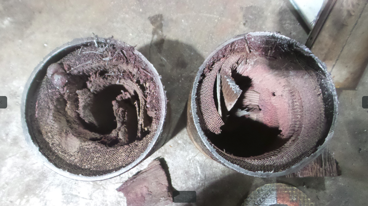

Yesterday I picked up a few cats. those below are foils.

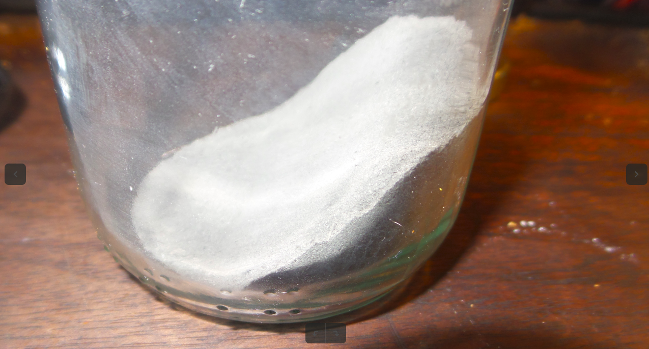

Fifty grams of wash coat, much better looking than my last attempt.

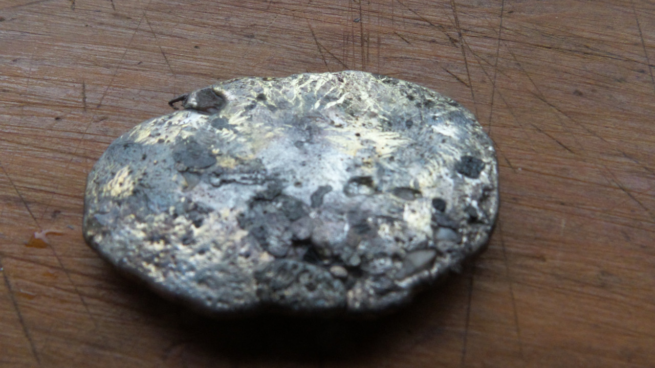

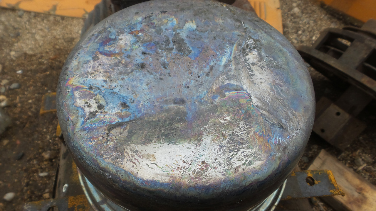

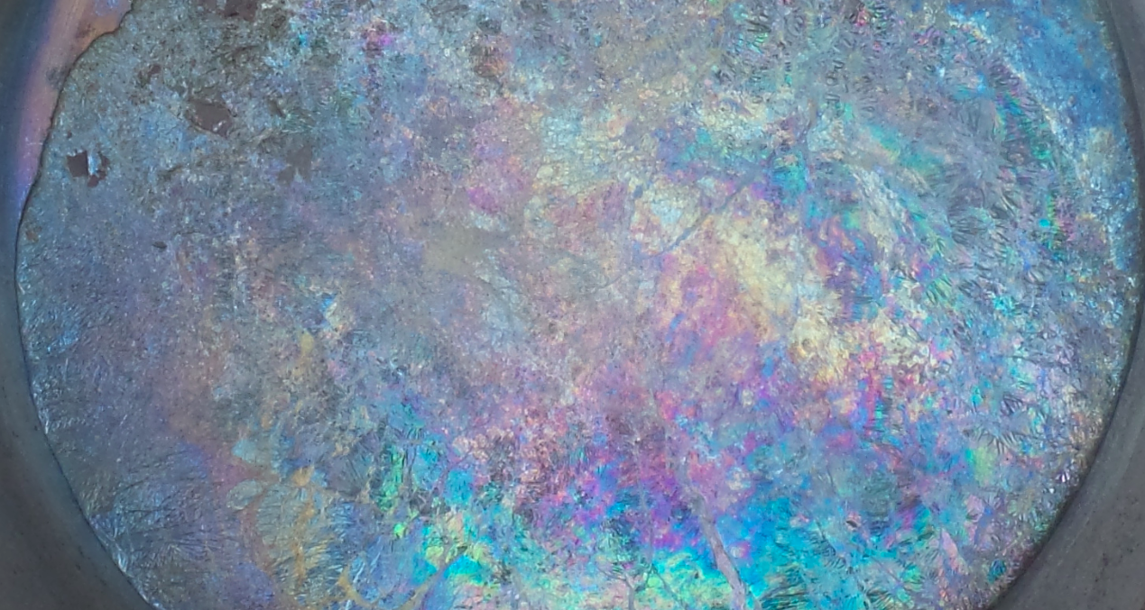

The precious metals powders previously recovered from catalytic converters was today smelted into lead as the molten lead cooled these awesome colors began to show up.
I believe the colors are from the iridium which is often used in catalytic converters.
In the smelting process any metals that have oxidized are not absorbed by the lead, the next step is to cupal the lead to recover the precious metals.

bc.gold
looking at the bottom side, the silver areas would be the heavier platinum that settled out while the collector metal was still in  the molten stage.

Local guy took a bunch of converters to the yard in the big city, they told him this one had no value. Probably hoping he would tell them to dispose of it rather than pack it back home.
I've added about 1/2 of a cc of 35% hydrogen peroxide which you can clearly see is reacting with the catalyst, that is not smoke coming off the hydrogen peroxide is being broken down into water and oxygen.
My next step is to test the cat to see which precious metal was used for a catalyst, hopefully it's not zeolite.

Scrap yard was right this cat has no value. The piece I broke off for testing was very soft and easy to crush into powder. it's probably made from zeolite.

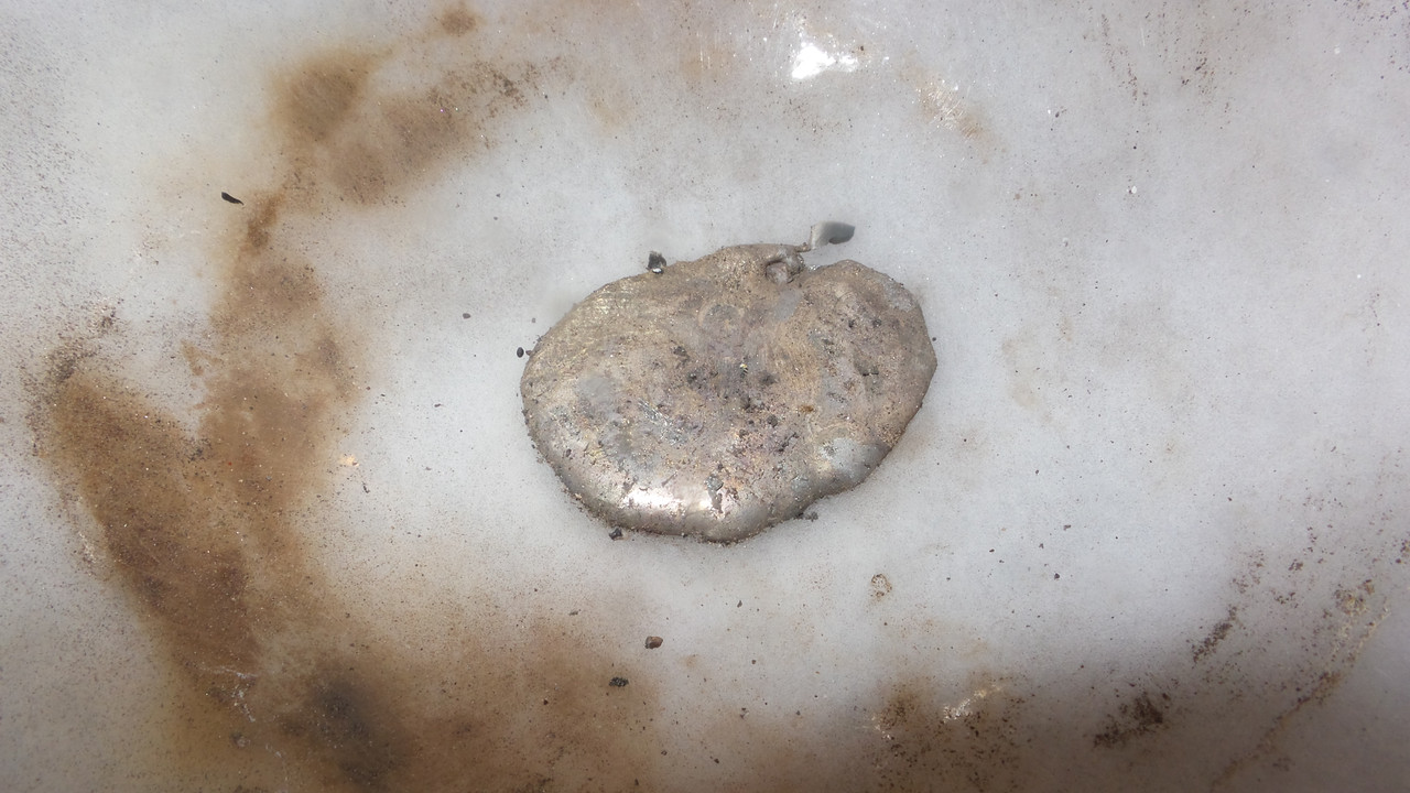

Rhodium infused with a lead button.

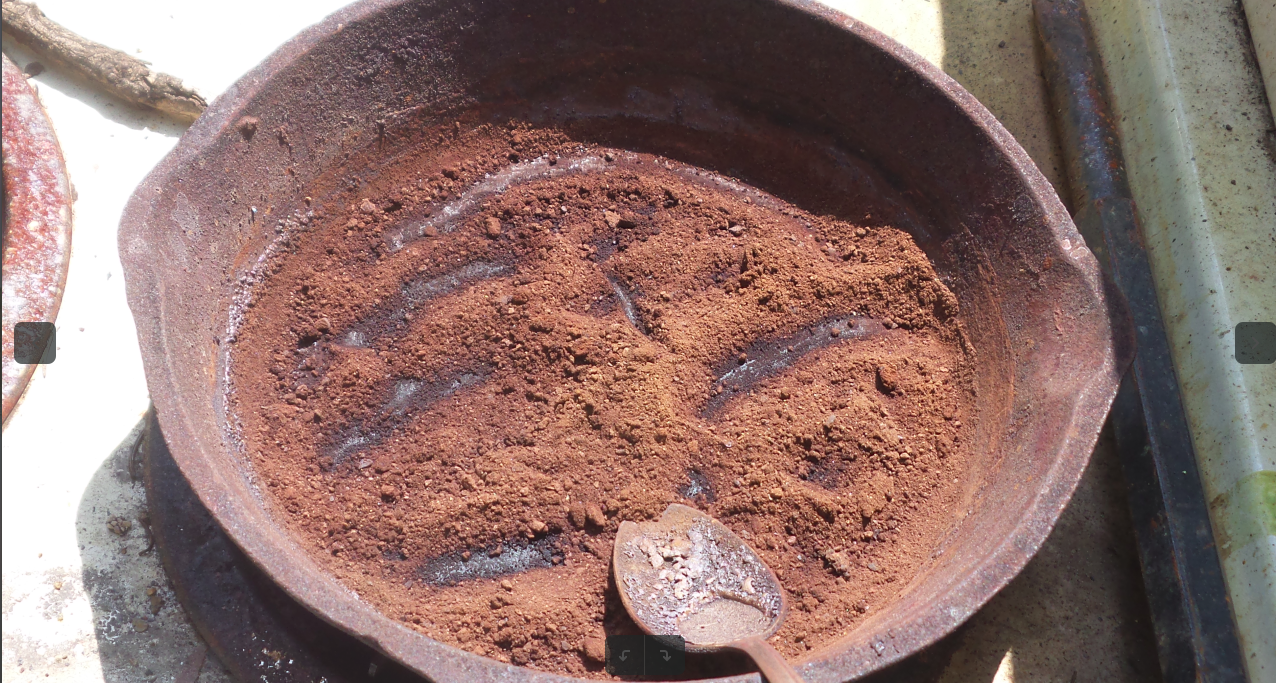

Palladium the colour of coffee.

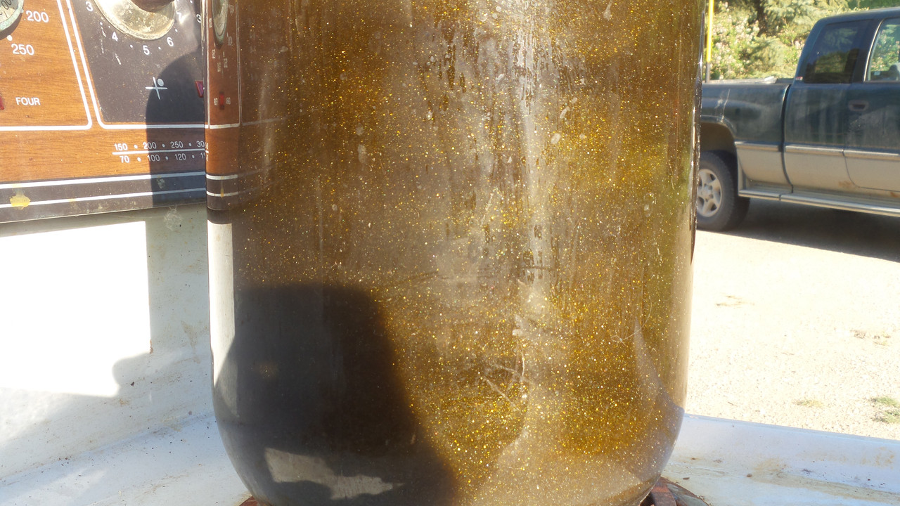

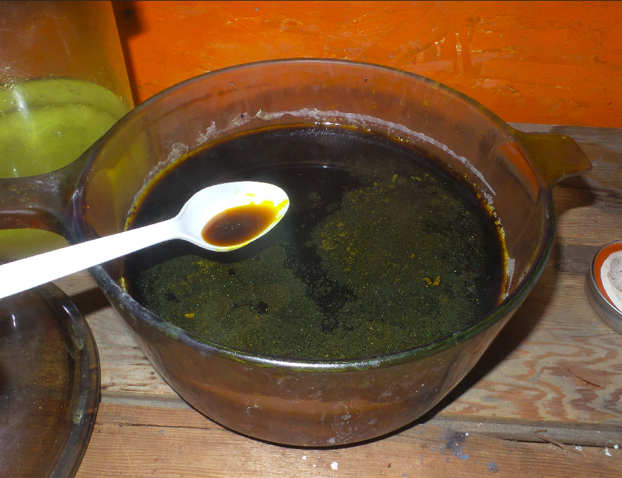

Platinum leach after adding zinc, the platinum salts have now converted to metallic particles. I stirred the heavies up into solution for he video, the sunlight reflects off the platinum.

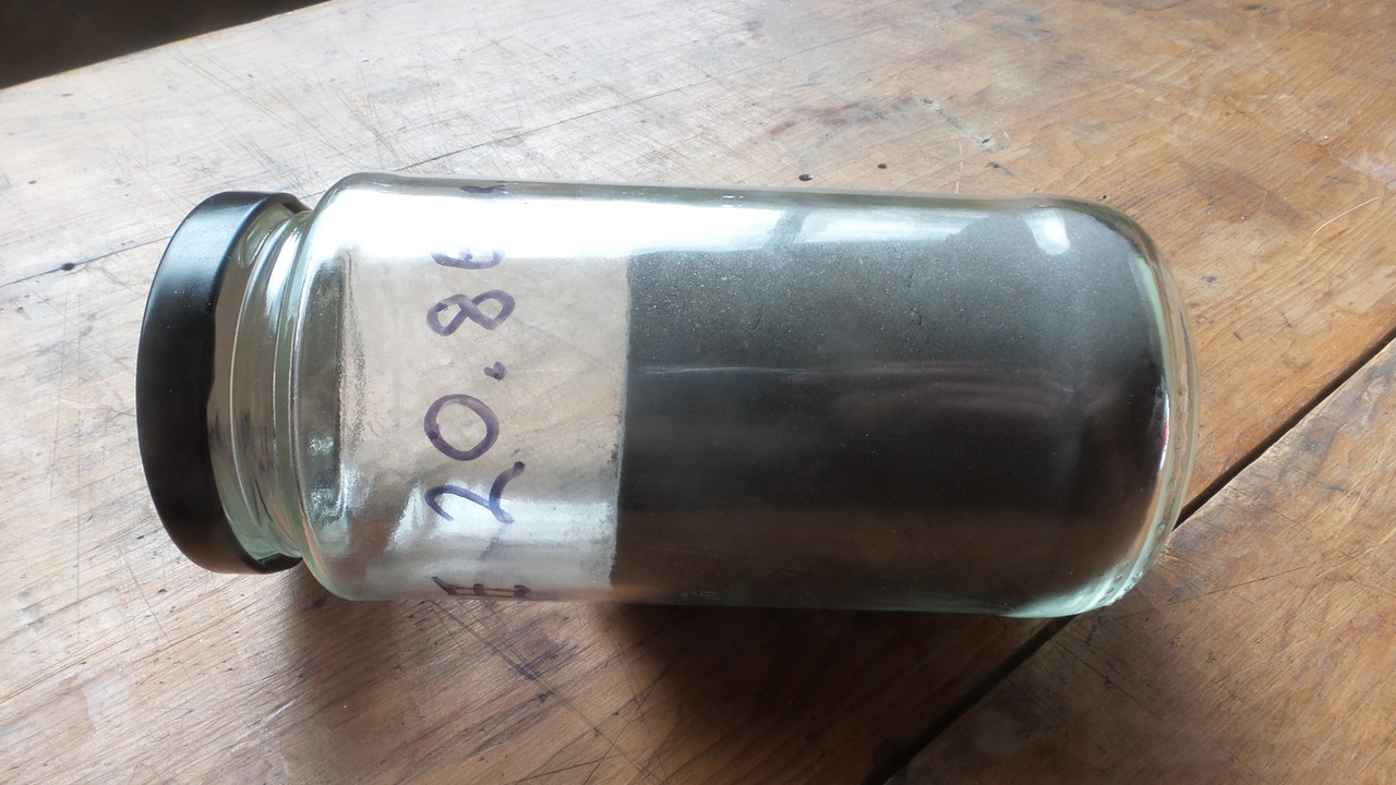

This is from the jar above, 300 grams of high grade concentrates.

Zinc sacrificial anode at work, platinum, palladium and rhodium is being cemented out of solution as a black powder which at sometime in the near future will be further refined to separate the metals in their pure form.
The jar to the right has almost had all the precious metals cemented out, the liquor has turn black once the powders settle the liquor will be clear of any colours.
The zinc I'm using is from wheel weights marked Zn.

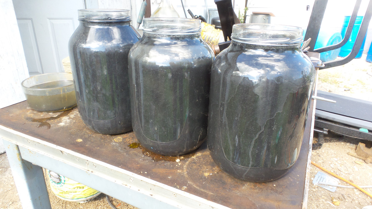

Three jars, one of my largest drops., one everything settles out to the bottom I'll siphon off the clear liquor. Turn the zinc into a hydroxide.

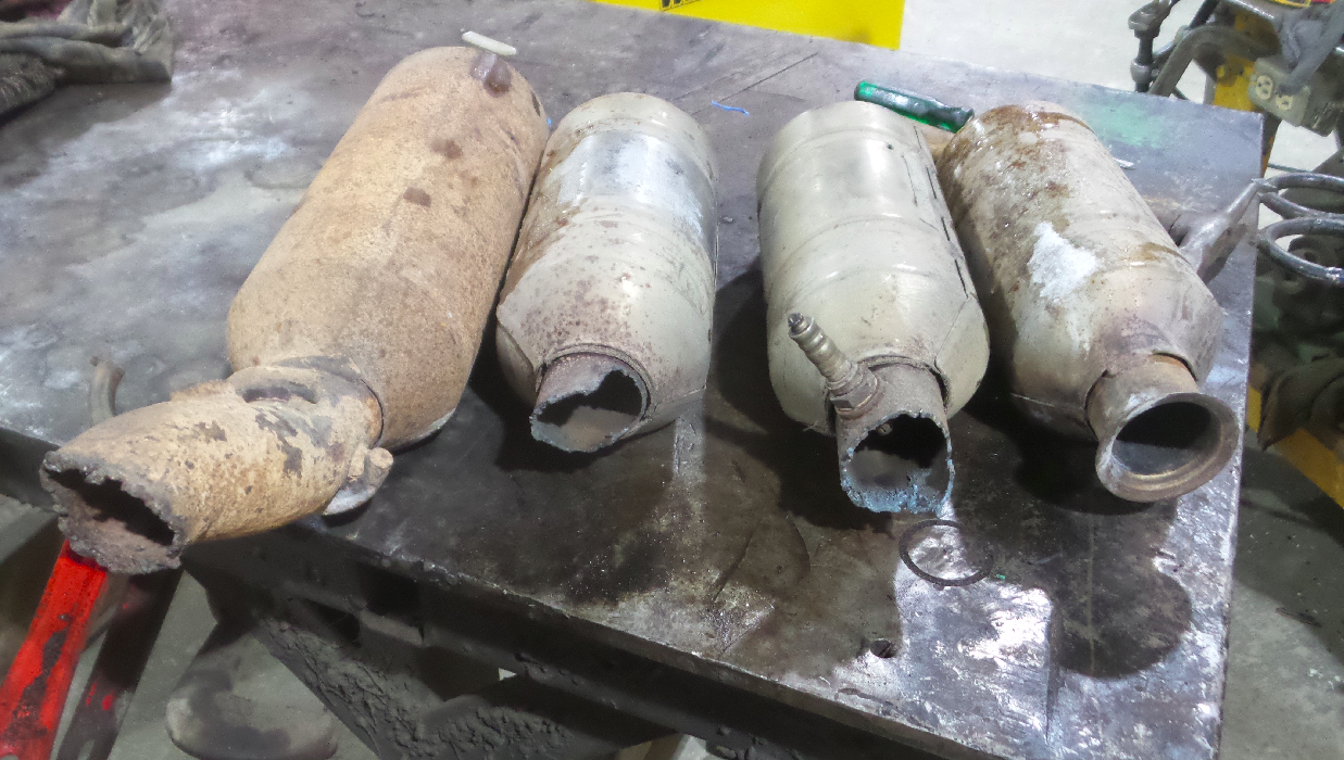

From four cats, later when its dried I'll weigh up the metallic filtrate to get an average.

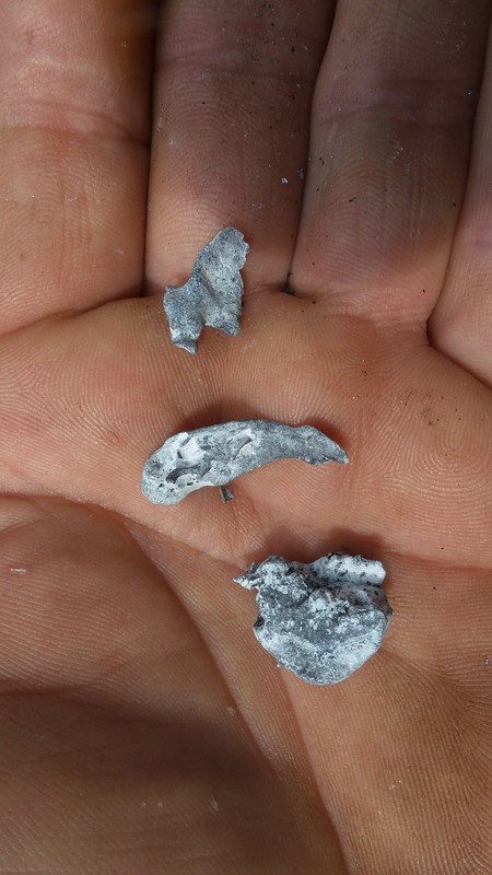

I ran out of zinc and had to sacrifice that old Briggs Zenith carburetor which is made from die cast zinc to cement some values, now have another 110 grams of high grade concentrates.

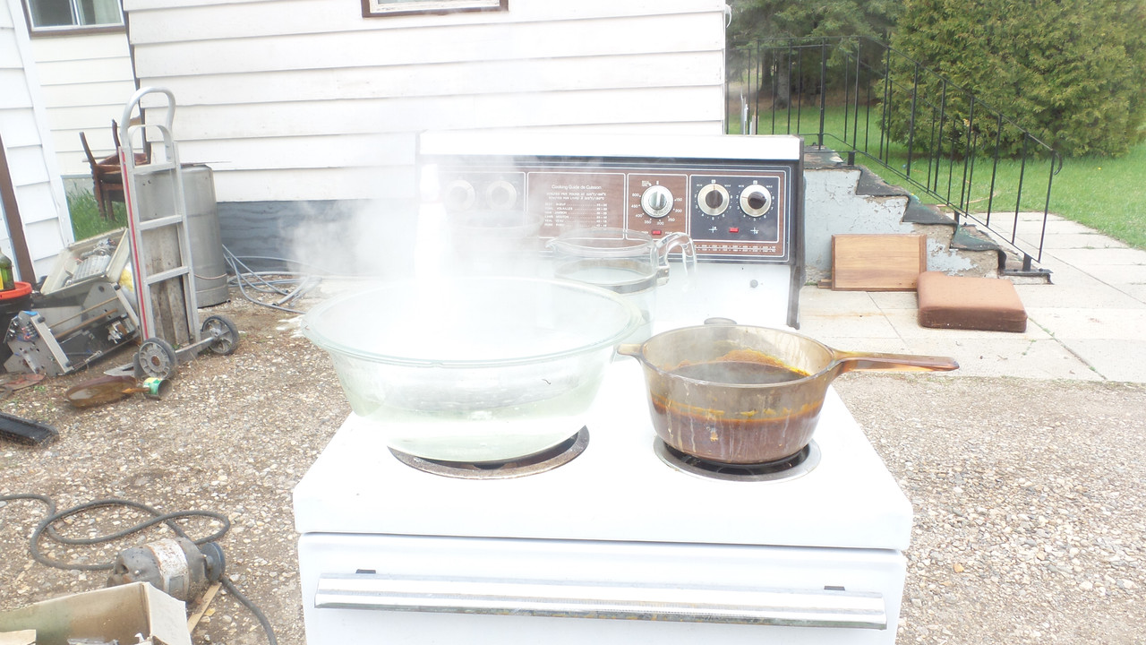

From catalytic converter comb to the contents in jar which has in-turn been turned into a liquid containing double salts from which palladium and platinum will be separated and once again become metal.
My metals are currently in the liquid stage.

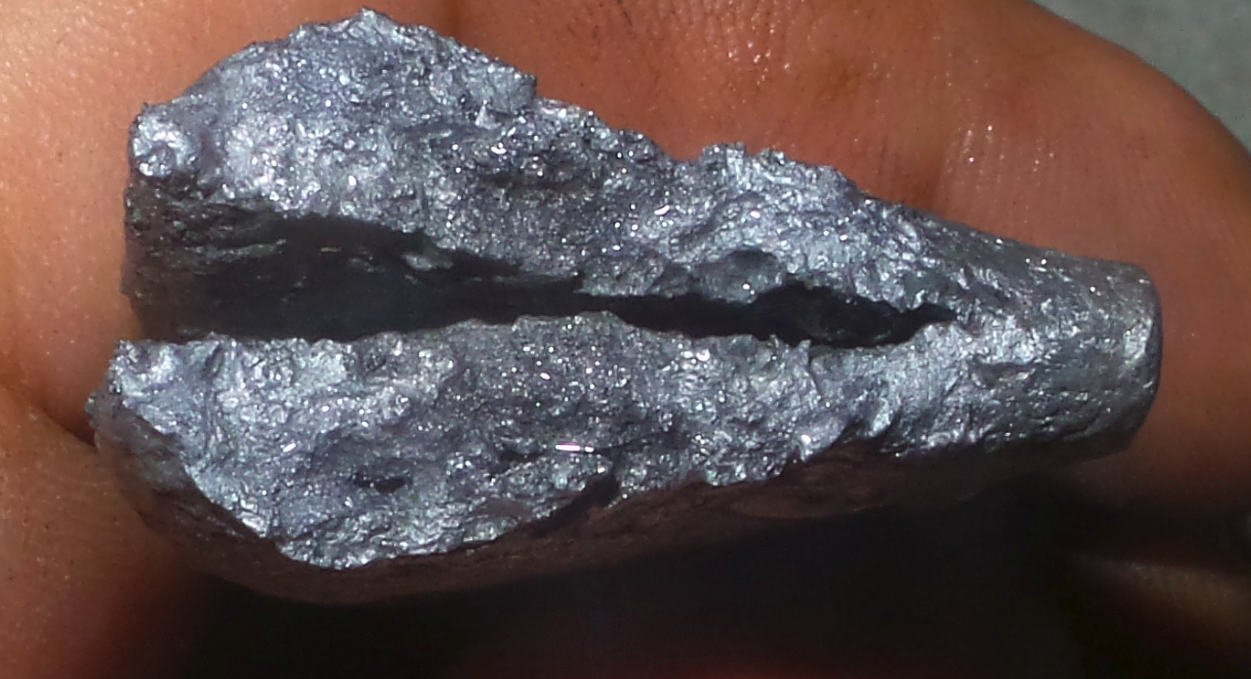

I have about a ton of gold bearing quartz, this gold button was recovered from a 20 gram sample, there's enough gold in the sample to even give the topside of the button color.

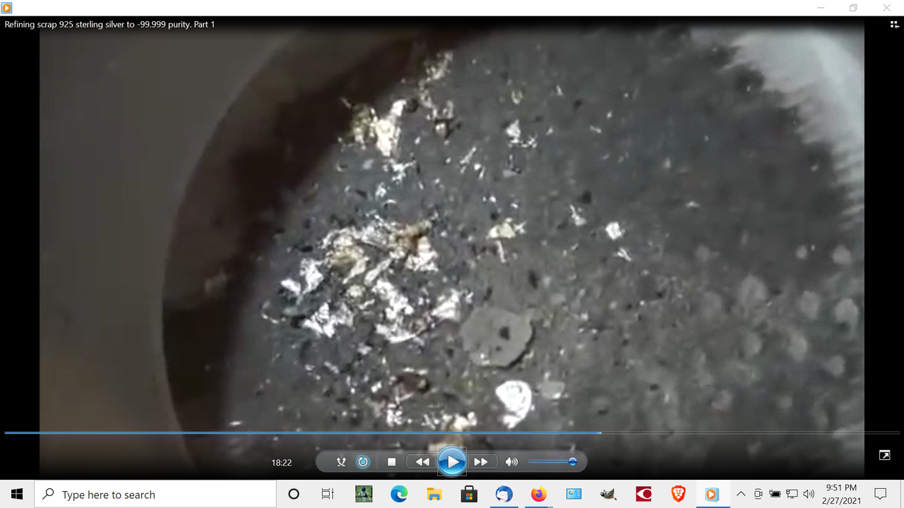

I used table salt dissolved in water to remove silver plate from flat wear  the more expensive silver plate is over plated with rhodium and these small bits are causing the sun to reflect off of them.
Rhodium is currently at USD per troy ounce,
Rhodium $19,300.00
Another thing occurred to me, table salt via electrolysis your creating two other chemicals, sodium hydroxide and sodium chlorinate. The chlorite is an oxidizer capable of spontaneous combustion when coming into contact with organic materials and possibly even react with petrochemicals.
Sodium chlorite | NaClO2 - PubChem
SODIUM CHLORITE is self-reactive. The trihydrate crystals of sodium chlorite explode on percussion. Sodium chlorite reacts with acids to form spontaneously explosive chlorine dioxide gas (ClO2). If heated above 347°F, the reaction yields enough heat to become self-sustaining, [Mellor 2 Supp. 1:573 1956].
