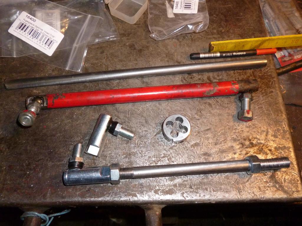

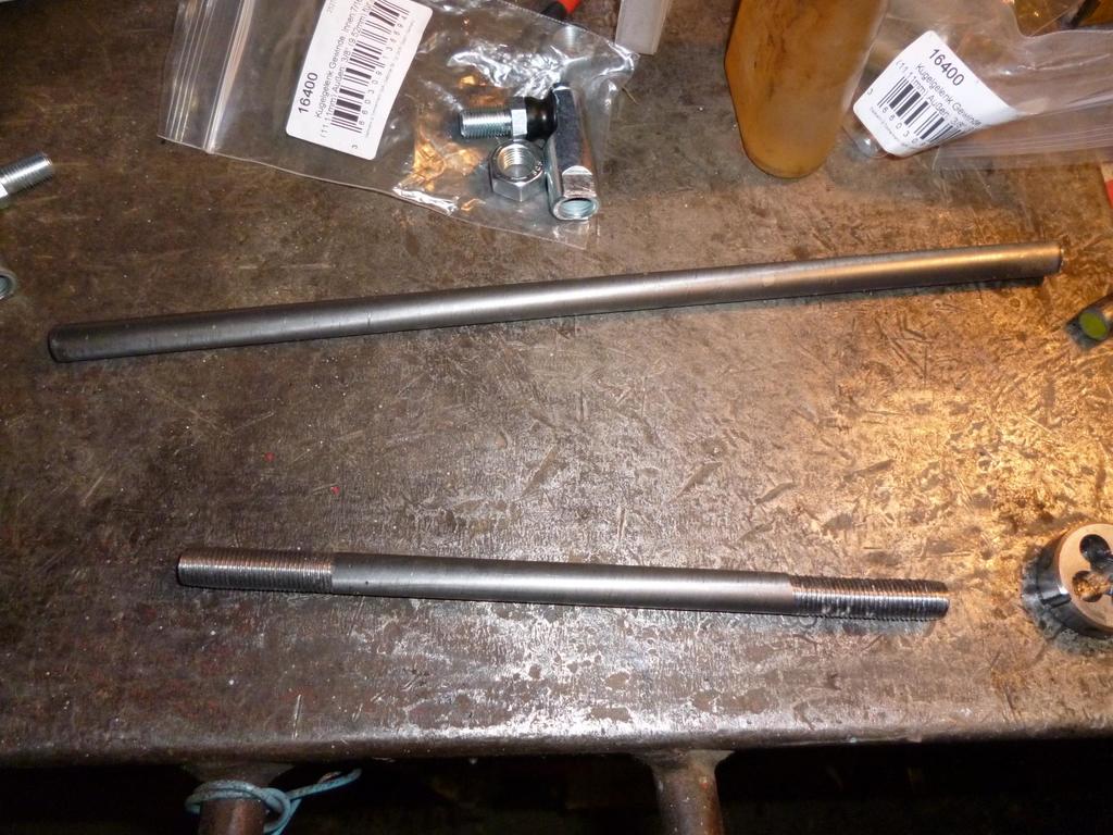

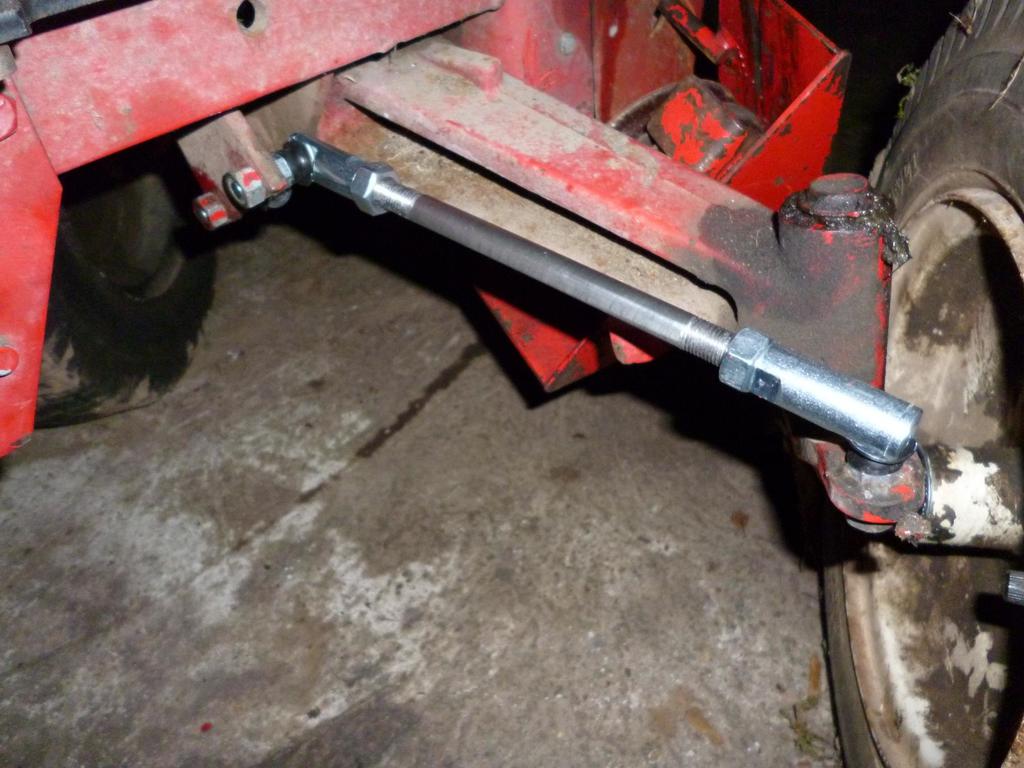

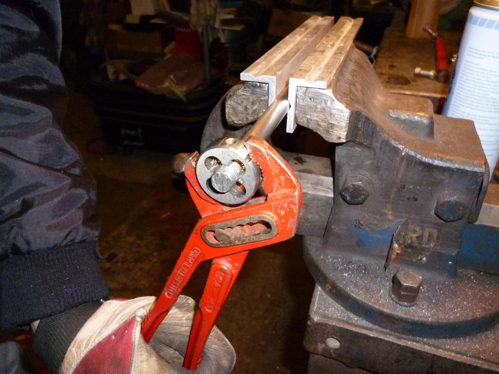

wheeliepower 141 #1 Posted March 11, 2019 Hi, today I built selfmade tie rods for my tractor. I used cromo steel iron bars. advantage: Use of tie rod ends => thus optimal attitude of the trace and favorable exchange of parts in case of defect. Unfortunately, the cutting head did not fit on my German cutting tool. That's why I had to turn the cutting head with a pincer, but it was okay ;-) Now everything is grown again and works great. 7 17 Share this post Link to post Share on other sites

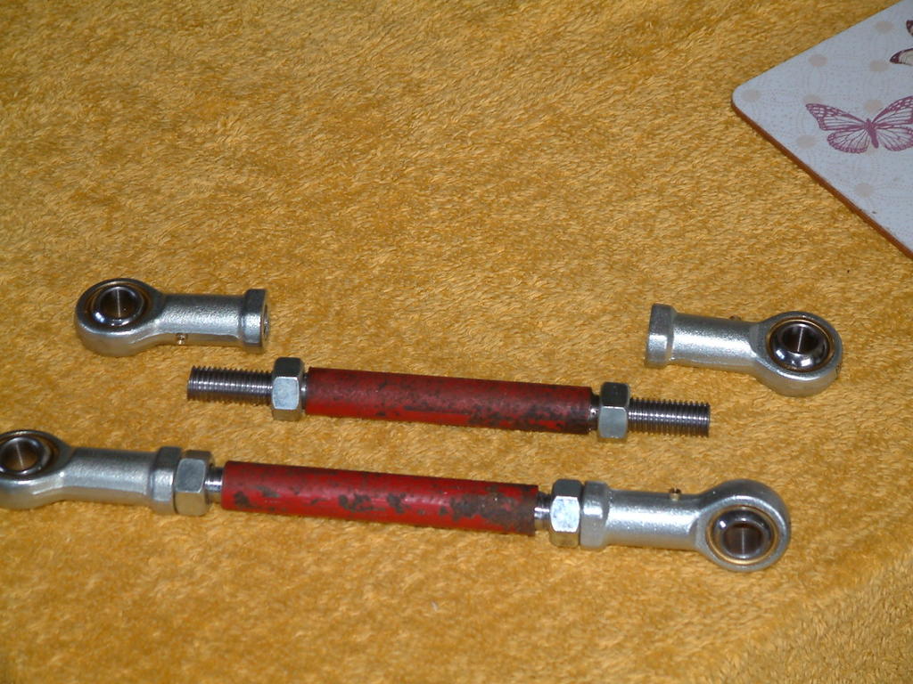

Stormin 9,988 #6 Posted March 12, 2019 I did the same on my C-121.(The Black Horse). Only I used a pair of worn out tie rods and altered to take adjustable track rod ends. A very worth while modification. 3 Share this post Link to post Share on other sites
Lee1977 7,807 #7 Posted March 13, 2019 2 hours ago, Stormin said: I did the same on my C-121.(The Black Horse). Only I used a pair of worn out tie rods and altered to take adjustable track rod ends. A very worth while modification. I fix my tie rods like that back around 1990 have not had any more trouble with them. 1 Share this post Link to post Share on other sites
bellevillerod 836 #8 Posted March 25, 2019 Helm joints make strong tie rods they last long time. 1 Share this post Link to post Share on other sites
tarcoleo 120 #9 Posted April 1, 2019 wheeliepower- Did the same as you but used threaded rod. Share this post Link to post Share on other sites
