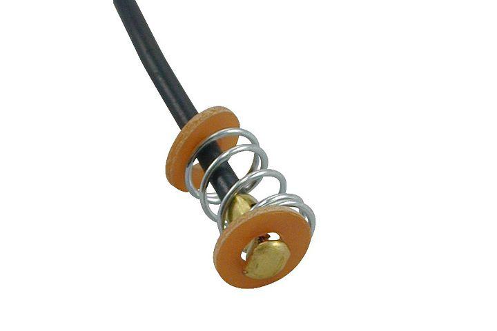

boovuc 1,090 #1 Posted March 10, 2019 Here is one for the ages................I'm looking for the crimp connector to crimp or solder the little contact button on the bottom of a front light socket for a circa 1975 Wheelhorse tractor. I have the washer/insulator and the spring. The wire is there but the wire lost the little button connector that the bulb contacts via the + wire to make a connection. I have nothing in my bag of 12v goodies and I don't have an old C series in a bone yard anymore to scavenge a part off of. Shoot me a PM or post a link f you have an alternative or an actual part that will work for this. I have a new lens and everything but the contact for the bulb to complete this particular fix on the basket-case C-160 saga! (More in the works). Thanks in Advance! (As always)! Share this post Link to post Share on other sites

gwest_ca-(File Mod) 12,489 #3 Posted March 10, 2019 Available from your local auto supplier called a lamp pigtail similar to this one Garry 5 1 Share this post Link to post Share on other sites
squonk 48,161 #4 Posted March 10, 2019 Napa # LS6226 1 1 Share this post Link to post Share on other sites
peter lena 10,076 #5 Posted March 10, 2019 you might luck out at your local hardware store, today they usually have a slide out bin section for lots of fittings. take a picture and match it up, Pete Share this post Link to post Share on other sites
Racinbob 13,200 #6 Posted March 10, 2019 NAPA has them. https://www.napaonline.com/en/p/ECHLS6226 1 Share this post Link to post Share on other sites
WHX?? 58,226 #7 Posted March 10, 2019 I've seen them at other auto parts stores also Boo. Share this post Link to post Share on other sites
roadapples 6,987 #8 Posted March 10, 2019 In a pinch, I've put a drop of solder on the wire end, and filed it flat... Share this post Link to post Share on other sites
