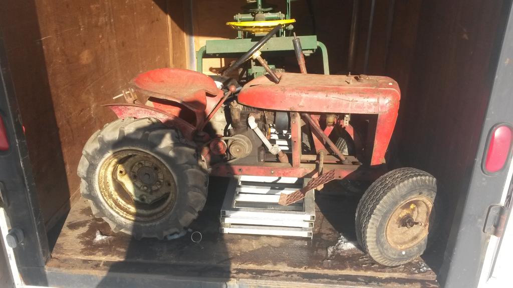

Nice find! Now I’ll say it ....
WHY can’t I find a deal like this?!
Are you going restore it or patina it?

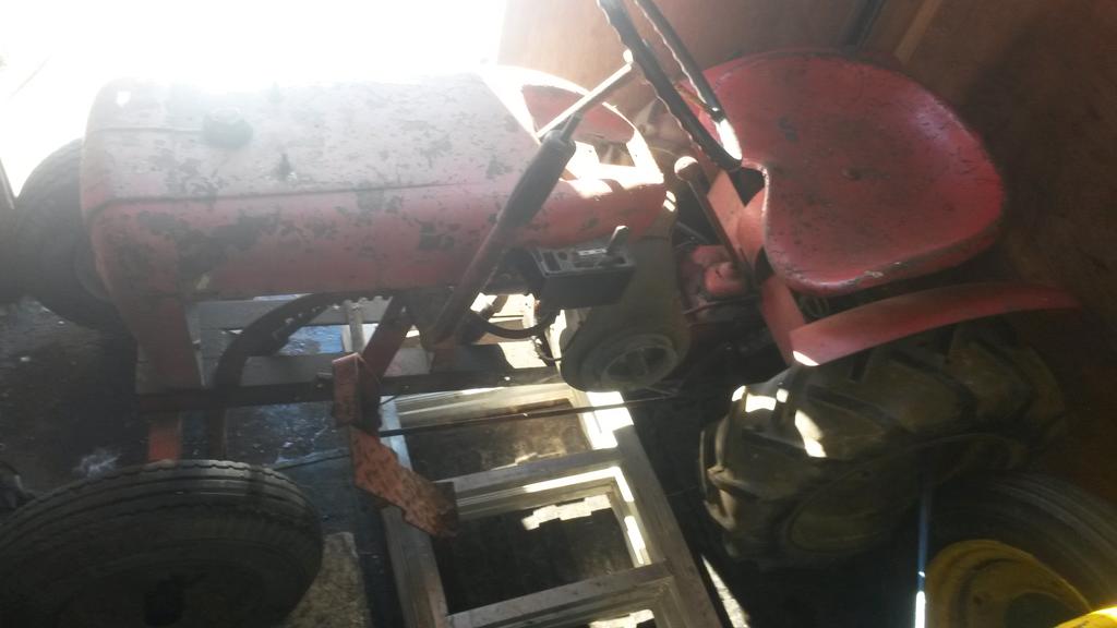

I'm probably gonna do a full restore on it. It's missing a few things, but I'm not gonna complain.

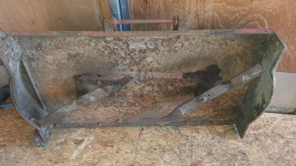

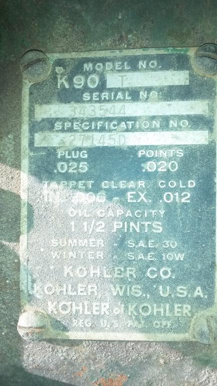

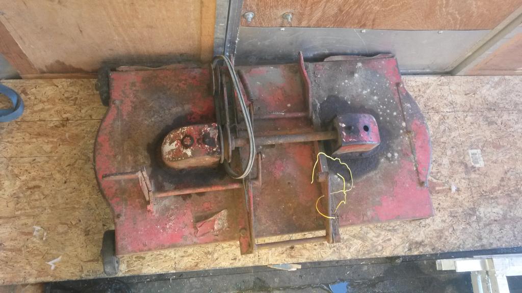

Well I went to pick up my bolens ride master today and we'll I was there I got this little gem for $150. Wasnt planning on getting anything else. But the gentlemen said he felt it needed to go with me and i was not gonna disagree. Came with a solid deck and it's got a k-90 and solid seat pan!
Dang that was a nice score

Nice Chris... real nice :handgestures-thumbupright: Perfect example of how they fall out of the sky when you're going on another score and not even looking!
Solid seat pan & K90 might suggest an early 400??? If you can date the motor as being earlier than '60 that might confirm it?
Too bad the dash plate/serial  is missing.
@Racinbob has got the skinny on how to repro it tho.

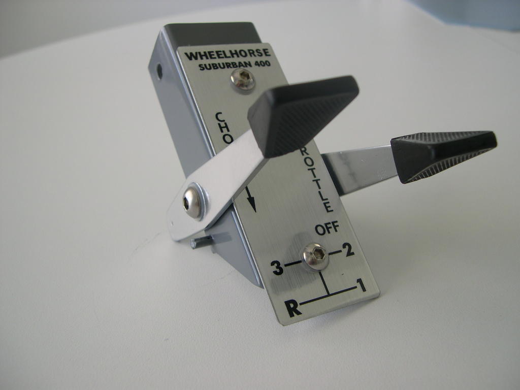

Que the picture again.
I made the levers from a piece of flat stock using the one old one I had as a template. Knobs from Glen, decal from Terry. I was fortunate to have the part underneath and was able to flip the plate to get rid of the pitting. I didn't have a serial # and you don't either so I asked him to put 'Suburban 400' where the serial # would be at. I didn't think about it at the time or I would have asked him to remove the 'OFF' since I'm not using the throttle to ground the magneto. I mounted the original kill button that was on the K-91 shroud in the hole to the right of the steering column. :)

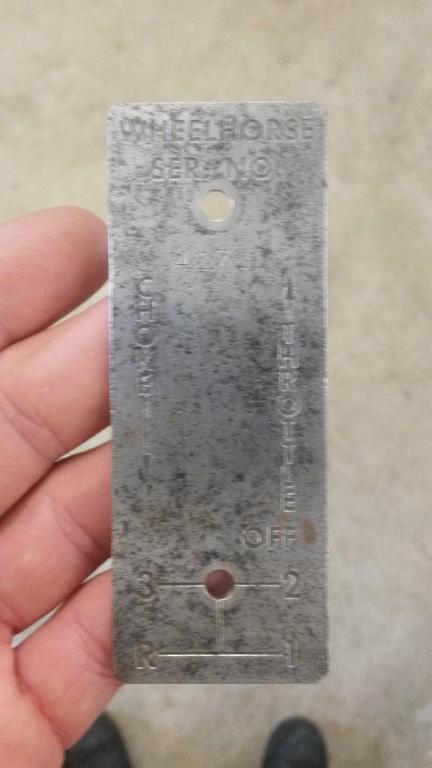

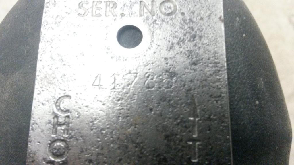

@WHX22 @Racinbob I do have a serial number plate. I'm just missing the throttle and choke levers and the bracket they attach to. It came from another suburban 400. I bought a roller for parts at a steam show and the serial plate was zip tied to the shifter lever. Been hanging on to it for awhile now. But the serial number is 41785.
