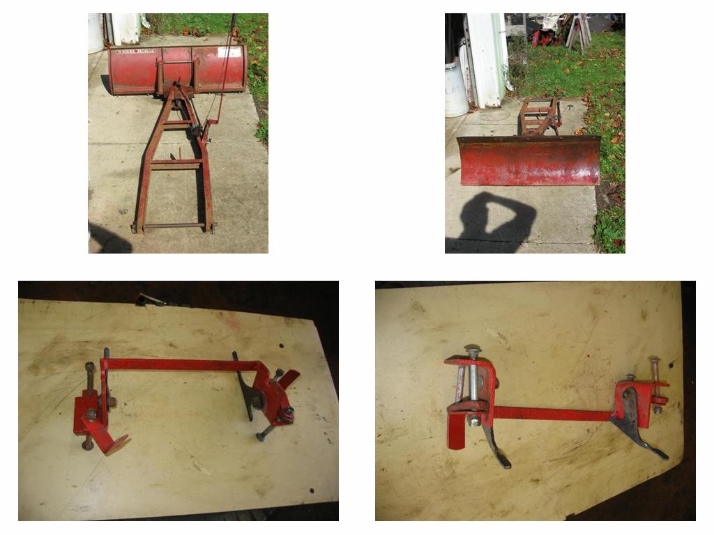

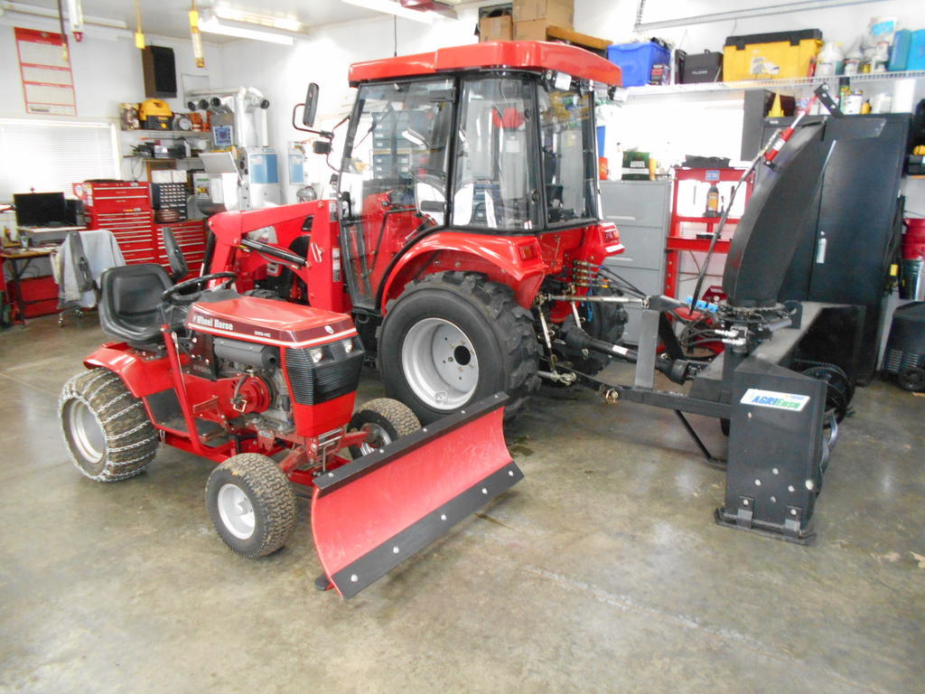

daveoman1966 3,884 #5 Posted March 8, 2019 (edited) If only need a blower a couple of times, why not mount a DOZER BLADE instead. The blowers have lots of high RPM moving parts prone to breakdowns / repairs. A dozer blade (42 or 48") has virtually no such parts and require little maintenance. Whats more, the dozer blade will come in useful in so many ways...especially in the woods, grading driveway, and they are awesome for snow clearing as well. IMHO...get a dozer blade and leave it on permanently. Very easy mounting too. Will require a rear axle mounting bracket which is also used for a roto-tiller. What's in this pic is exactly what you need for the dozer blade. I HAVE THIS AXLE BRACKET.... send me an email if wanted. my email is: daveoman@windstream.net Edited March 8, 2019 by daveoman1966 2 Share this post Link to post Share on other sites

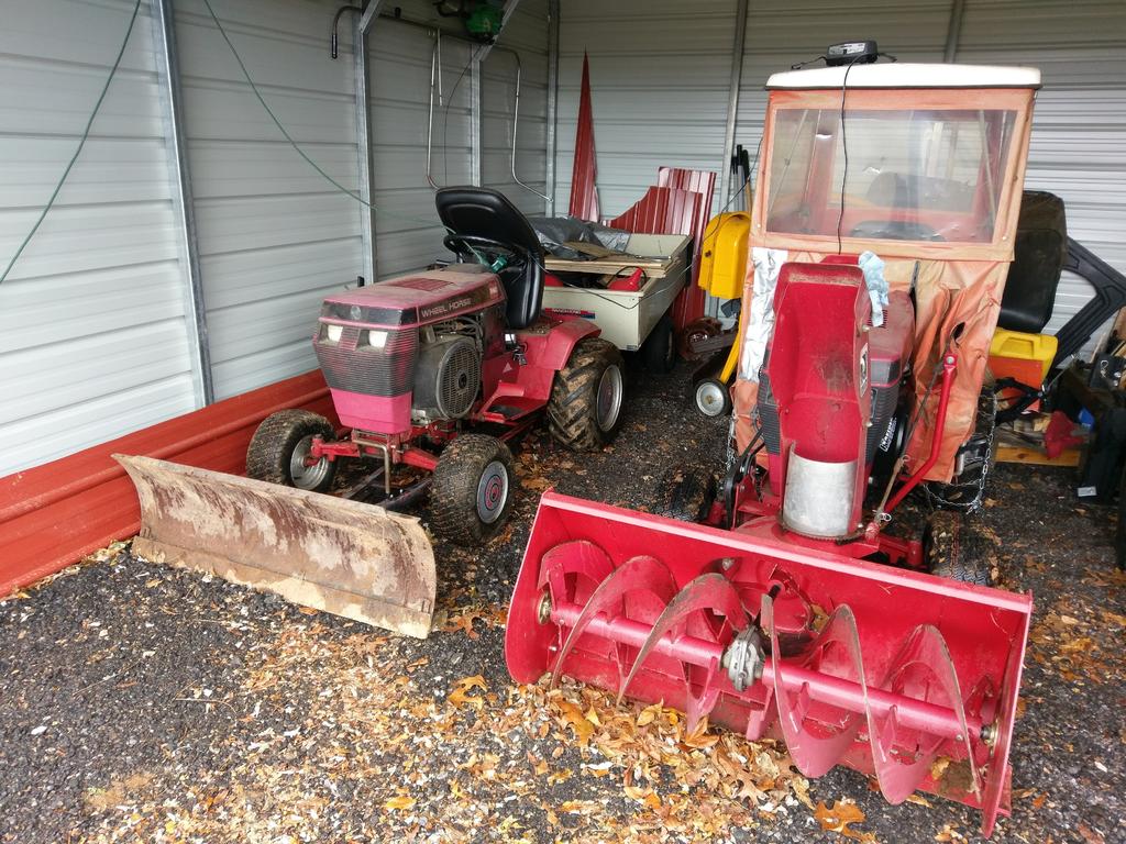

midpack 1,148 #8 Posted March 8, 2019 it's pretty easy to mount/dismount a single stage. that being said, I have 2 machines set up for snow removal. one with a plow, one with a blower. I love the blower on my 417-8 (electric lift) but when it's wet and heavy I usually grab the plow machine. I think the bigger engine works better with the blower, my plow machine is powered my a Magnum 12. I've had the blower on that machine but you could tell it was working harder 1 Share this post Link to post Share on other sites

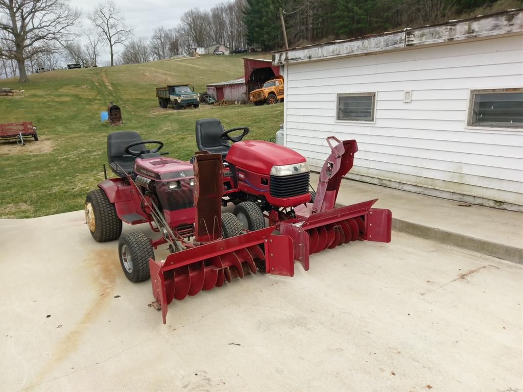

WVHillbilly520H 10,379 #9 Posted March 8, 2019 Ok my take on the situation, the single stage thrower will lift rather high 8-10" vs the 3-5" a dozer blade does, so with that being said why couldn't you leave it attached from fall to spring even fetching wood from the woods. 3 Share this post Link to post Share on other sites
pfrederi 21,225 #10 Posted March 8, 2019 33 minutes ago, WVHillbilly520H said: Ok my take on the situation, the single stage thrower will lift rather high 8-10" vs the 3-5" a dozer blade does, so with that being said why couldn't you leave it attached from fall to spring even fetching wood from the woods. Maybe if power steering was involved... also you would need a lot of room to make a turn 1 Share this post Link to post Share on other sites
WVHillbilly520H 10,379 #11 Posted March 8, 2019 24 minutes ago, pfrederi said: Maybe if power steering was involved... also you would need a lot of room to make a turn I'm sure I wasn't thinking about the steering issue on anything less than a 520H or an xi with power steering. Thanks for reminding me. VIDEO0012.3gp Share this post Link to post Share on other sites

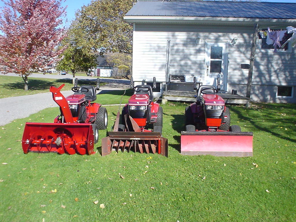

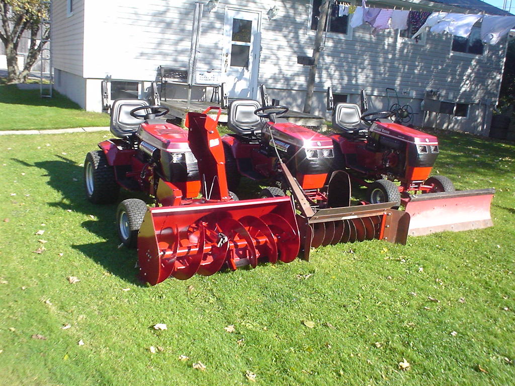

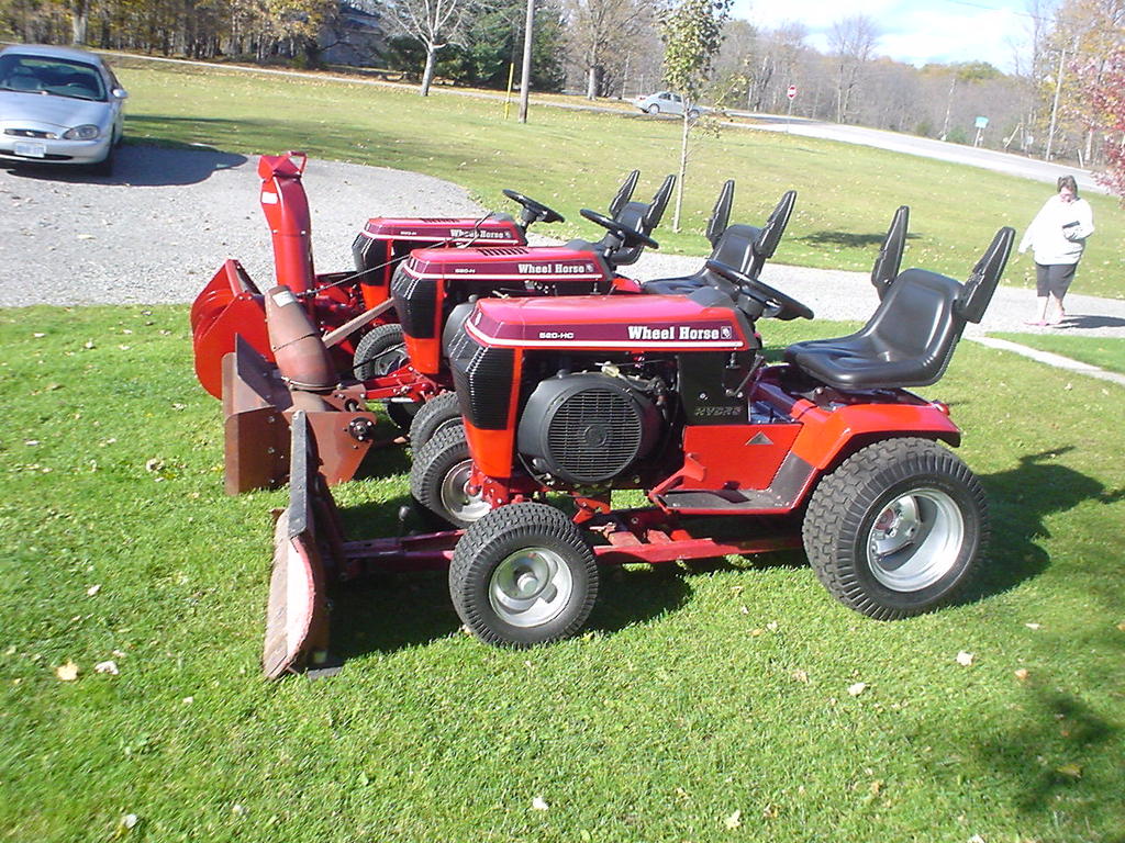

cleat 9,380 #12 Posted March 8, 2019 (edited) I have both blowers, blades, front end loader etc and they all have their place. For a light snow under 8" or so the blade does it well and quickly. For a very deep snowfall the little wheel horse would have trouble pushing a blade so the blower works better. For the odd time we get wet sloppy snow sometimes it ends up being a bit of both. Always best to have multiple tractors, Wheel Horses in particular love to travel in herds. Here is my lineup from 2015 Cleat Edited March 8, 2019 by cleat 6 2 1 Share this post Link to post Share on other sites
