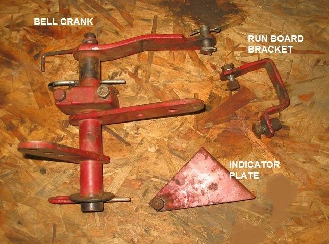

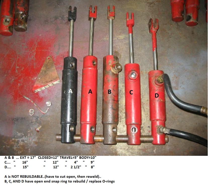

daveoman1966 3,884 #3 Posted March 8, 2019 To add Hyd LIFT to the Charger 9, you need LIFT KIT # 8-4111. Here is a schematic of that kit with parts listed...most are no longer available. However, I have those parts marked in RED. I don't have the Hyd Cylinder 6618 (item # 3) or the Bell Crank (item # 1) but the others...yes. Myu direct email is: daveoman@windstream.net. The cylinder 6618 is in this pic as A and B is the replacement for it, which is rebuildable...A is not unless to cut it open. HYD KIT 8-4111.xlsx 2 Share this post Link to post Share on other sites
