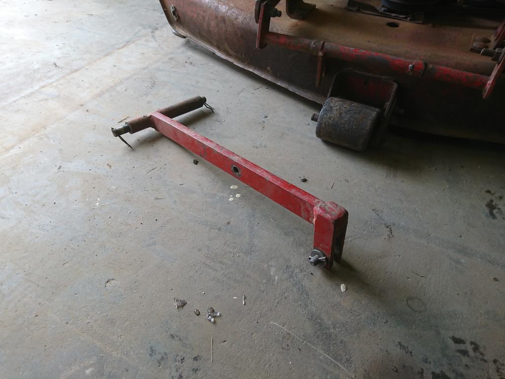

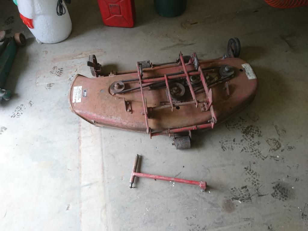

Thomas L 1 #1 Posted March 7, 2019 Hi, just bought me a WH Raider 10 with 48" deck and a snow blade. In a box full of different articles I have not managed to figure out what the T-bar shall be used for, Thanks in advance/Thomas L 1 Share this post Link to post Share on other sites
The Tuul Crib 7,354 #2 Posted March 7, 2019 to that is a lmplement lift arm . I myself have not seen one like that maybe homemade? 1 Share this post Link to post Share on other sites

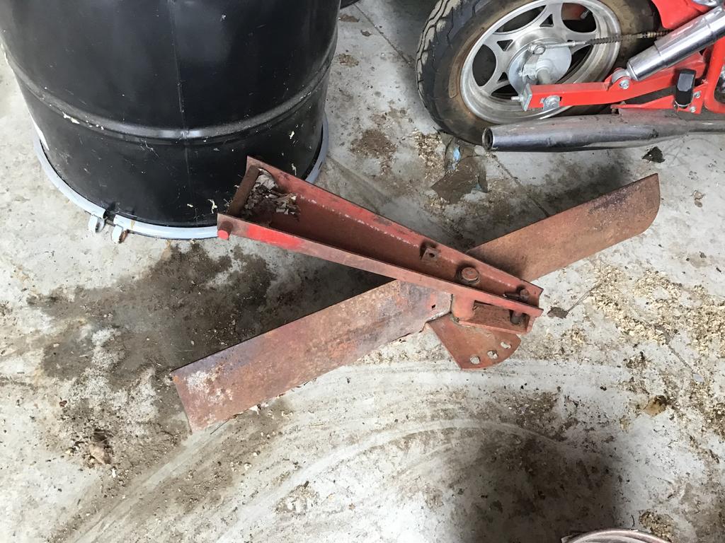

Pullstart 71,520 #3 Posted March 7, 2019 @Thomas L! It looks to me like a custom arm for a mid mount grader blade. It looks like the mount is too narrow to fit your plow brackets under the rear axle, but it would fit in the mid mount attach-a-matic behind the front tires. Kind of like this: Share this post Link to post Share on other sites

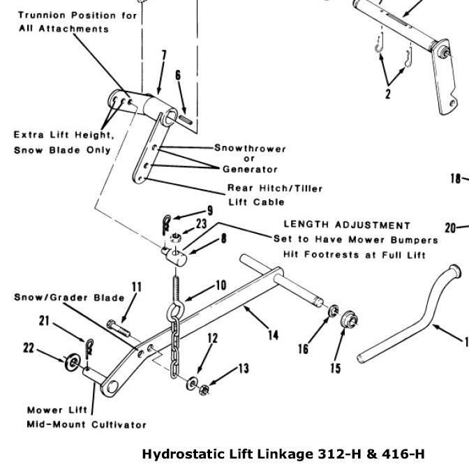

gwest_ca-(File Mod) 12,535 #4 Posted March 7, 2019 Looks like a home-made version of item #14. The original tractor did not have this but has been upgraded to a newer style of deck which requires it Garry. 2 Share this post Link to post Share on other sites
Stepney 2,356 #5 Posted March 7, 2019 (edited) Looks to me like he was trying to make his own lift bar for the mower deck. He was copying one off a C series. That deck mounting hardware is newer then your machine. Edit: Gary and I were typing at the same time I guess haha. He's got it covered. Edited March 7, 2019 by Stepney Share this post Link to post Share on other sites
Pullstart 71,520 #6 Posted March 7, 2019 Yep, I see what they mean. I retract my previous statement, all but the That can stay! Share this post Link to post Share on other sites

Thomas L 1 #8 Posted March 7, 2019 Thank you all for prompt reply/help. This explains why I haven´t found any info/picture covering it.//Thomas L Share this post Link to post Share on other sites
Lee1977 7,809 #9 Posted March 7, 2019 He built it to fit in the bottom holes for the for sickle bar mower. He should have angled it up at the back so the it came level with the tractor frame when it was up. I don't thing it would lift the deck much the way it's made. Share this post Link to post Share on other sites
Chris G 3,401 #10 Posted March 9, 2019 I'd agree with it being a home made version of part 14. Maybe made to use with a solid lift link and possibly get a little more lift and down pressure with the snow blade. Share this post Link to post Share on other sites
