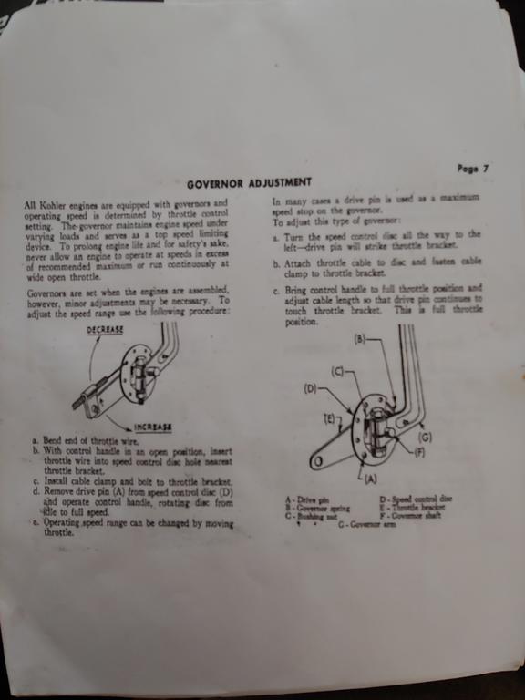

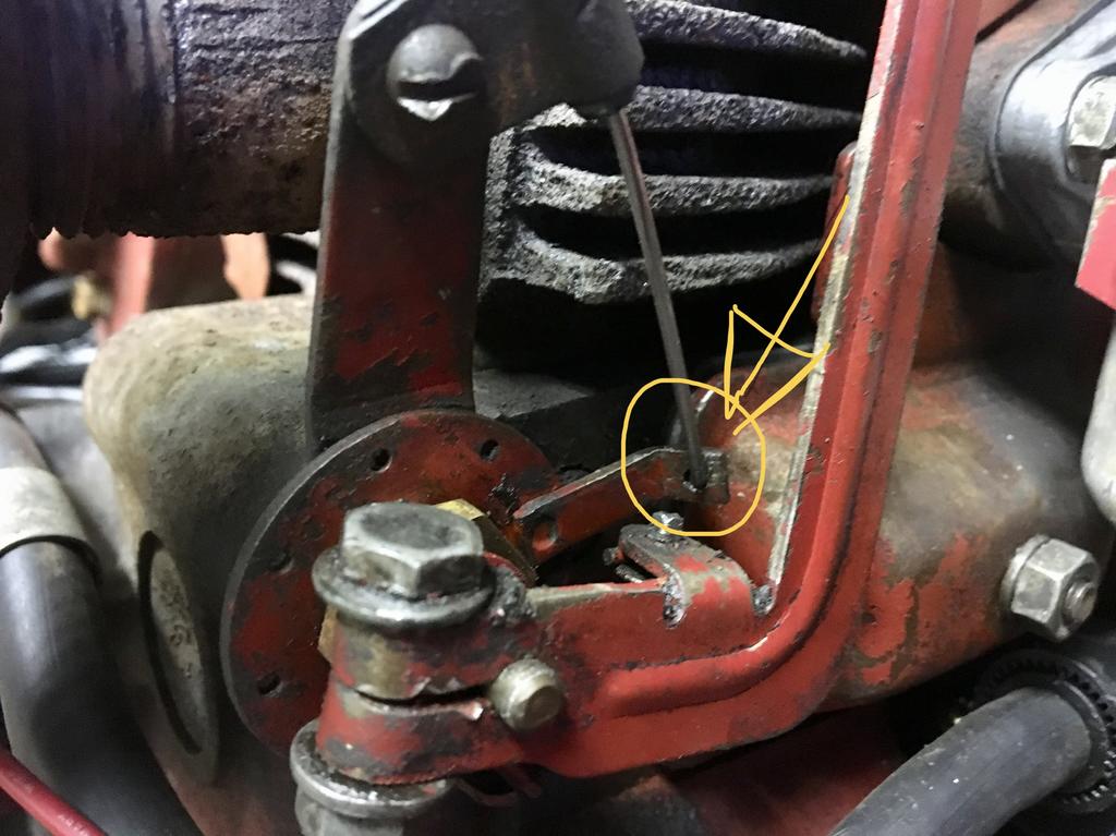

gt14rider 1,278 #9 Posted March 10, 2019 (edited) So once you adjust the governor, throttle cable wire through that little arm on speed control disc, (D) the cable is attached to the throttle bracket, throttle bracket at 12 o clock, loosen brass nut slightly, enough to move bracket,. Very slowly move bracket clockwise to decrease, counter clockwise to increase. Move bracket very little at a time, k181 max rpm is 3600 don't over rev. It would be a good idea to get a hand held tachometer to get proper rpm. Hope that helps. Also look up k181 throttle linkage adjustment, there are some good posts on here o I almost forgot this adjustment can be a pita. Edited March 10, 2019 by gt14rider Remember how much of a pita it can be Share this post Link to post Share on other sites
