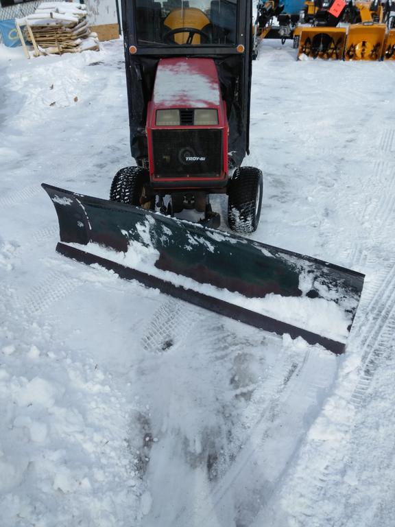

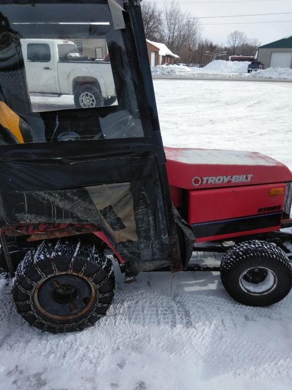

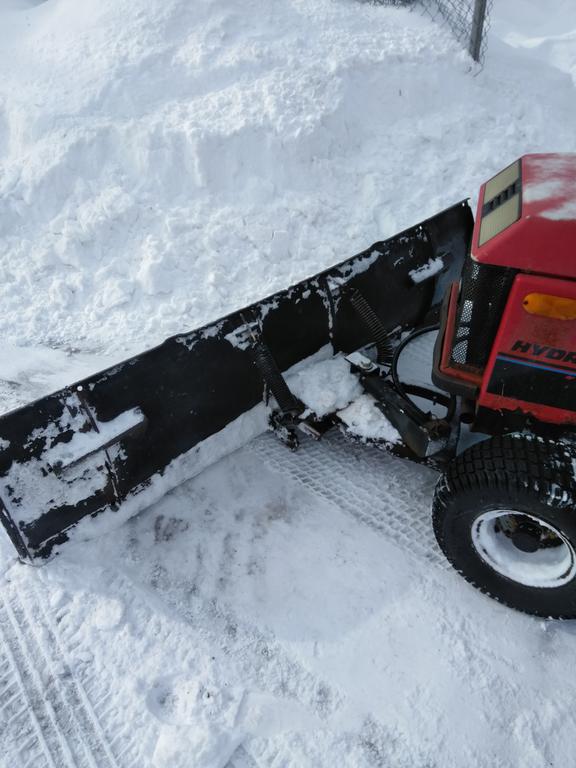

mr biggs 187 #1 Posted March 6, 2019 Good morning guys so I tried to replace a chain on my wheel horse snowblower because the link pop loose, if that's not the most difficult thing in the world just to get that one back in .... I don't know what it is ! Is there a secret tool or what ? I gave up , grabbing another tractor see pics when I got this tractor I honestly thought this was a wheel horse , is a baser with the 72" blade ( homemade ) Share this post Link to post Share on other sites

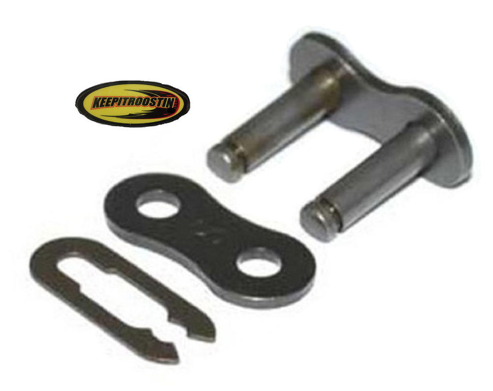

gwest_ca-(File Mod) 12,511 #6 Posted March 6, 2019 This tool makes installing a chain real easy https://www.princessauto.com/en/detail/-40-to-50-roller-chain-puller/A-p8105827e One of the pictures shows how it is used. The horseshoe shaped retaining clip that secures the master link should have the rounded end facing the direction of chain travel. A chunk of ice can push the clip off if it is on the other way around. Garry 2 Share this post Link to post Share on other sites
