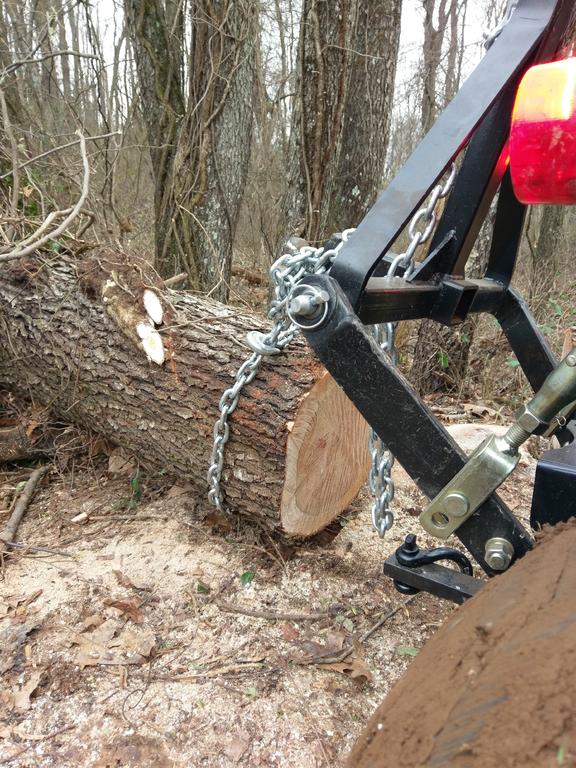

Mows4three 833 #11 Posted March 6, 2019 You could always build a frame like mine and just back up over the log. Built for my quad but usable on a Wheel Horse. It’s a tremendous force multiplier when towing large logs. Weight of log is directed onto rear axle resulting in increased down pressure onto rear wheels. This equates to more traction. Cheers! Dave EC899CFD-32FD-4D41-BC66-F7D60201BBD7.mov 2 2 Share this post Link to post Share on other sites
Pullstart 71,374 #12 Posted March 6, 2019 1 minute ago, Mows4three said: You could always build a frame like mine and just back up over the log. Built for my quad but usable on a Wheel Horse. It’s a tremendous force multiplier when towing large logs. Weight of log is directed onto rear axle resulting in increased down pressure onto rear wheels. This equates to more traction. Cheers! Dave EC899CFD-32FD-4D41-BC66-F7D60201BBD7.mov I’ve thought about building a log arch, but I like the idea of a grapple for cutting logs too. It gets them out of the dirt and all... 1 Share this post Link to post Share on other sites

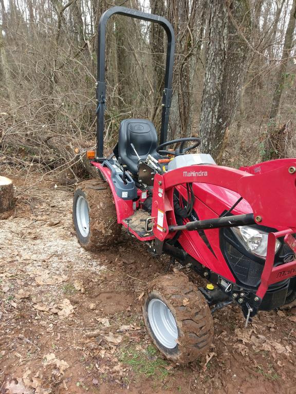

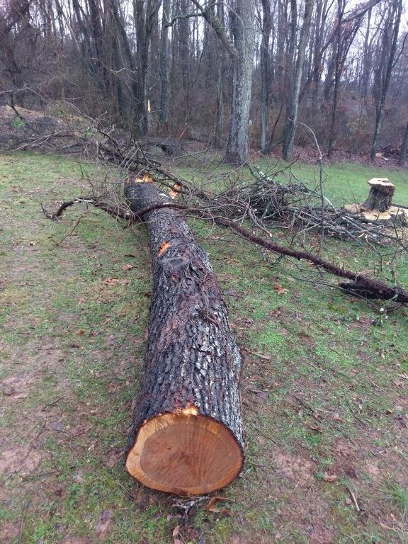

WVHillbilly520H 10,379 #13 Posted March 6, 2019 I don't think any of the green garden tractors would have been able to drag the big wild cherry tree I cut back in December, the eMax diff locked and 4wd barely drug it out to where I cut it up. 1 Share this post Link to post Share on other sites
