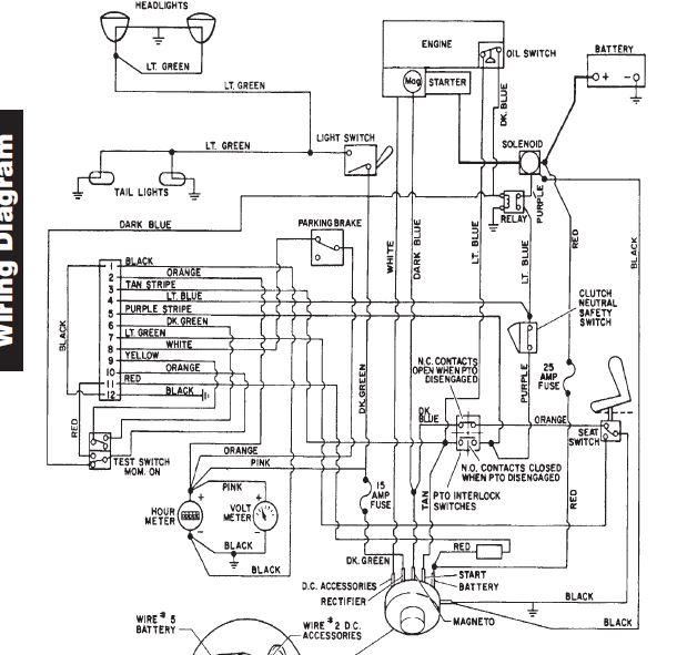

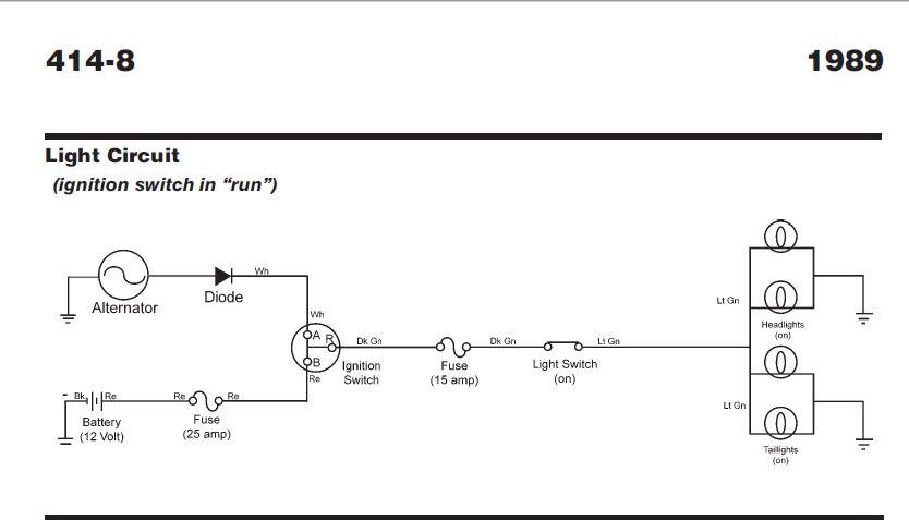

pfrederi 21,183 #2 Posted March 5, 2019 Welcome to red square. Wiring diagrams for you r 414-8 are here click on the tractor picture Share this post Link to post Share on other sites

953 nut 69,557 #4 Posted March 5, 2019 3 hours ago, Roym said: I am thinking (not being experienced at this) that the ignition switch may be next in line If your volt meter and/or hour meter are working with the key in the "ON/RUN" position then the ignition switch and 15 amp fuse are OK. Is there power to and from the light switch? Share this post Link to post Share on other sites
