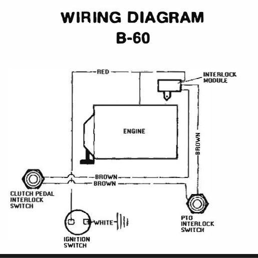

Wheelhorseking 0 #1 Posted March 3, 2019 (edited) I have a wheel horse b60 and I’m repairing it on the ignition switch there is an orange wire and I don’t know where it goes can some one help me please by the way it’s a pull start Edited March 3, 2019 by Wheelhorseking Share this post Link to post Share on other sites
953 nut 66,100 #2 Posted March 3, 2019 The orange wire runs from the ignition switch to the voltage regulator mounted on your engine. Download this manual for your future needs. Please feel free to ask any questions you may have. Share this post Link to post Share on other sites
pfrederi 20,544 #3 Posted March 3, 2019 Not sure a B60 pull start would have a voltage regultor... You sure the wire isn't red??? 2 Share this post Link to post Share on other sites
buckrancher 2,696 #4 Posted March 3, 2019 there is no voltage regulator on a B60 the wiring diagram above is correct brian Share this post Link to post Share on other sites
953 nut 66,100 #5 Posted March 3, 2019 3 hours ago, Wheelhorseking said: it’s a pull start My bad, when I see orange wire I just automatically think charging. Share this post Link to post Share on other sites
