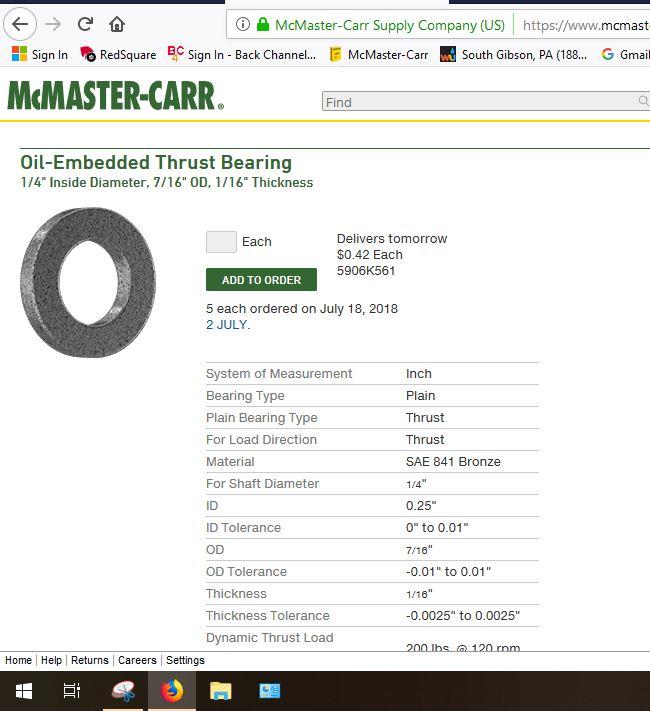

pfrederi 21,300 #16 Posted February 28, 2019 3 hours ago, HappyHillbilly said: Thank you! I’ve got the Kohler service manual but this seems to have some better details. Rebuild parts & a new carb have been ordered. The throttle body has a fair amount of slop. It will wiggle approximately .050” at base of carb. Might be a challenge to find a bushing here in my small town but I think I can find one that’ll work. Thanks, folks! 3 Share this post Link to post Share on other sites
HappyHillbilly 86 #17 Posted March 2, 2019 (edited) Thanks, folks, for the thrust washer/bearing info, tips & video link. i found the Hillman washers in another nearby town’s Ace Hardware & waiting on the float & rebuild kit. Meantime - the replacement carb I ordered came in yesterday & it’s an exact physical match - even the correct choke lever orientation. For $21.99 off Amazon, with free 1-day shipping (Prime membership), tickled pink, so far.... Question - Do I need to wrap or coat the “L” shaped fuel connector’s threads with anything to ensure no leakage? Thanks! HH Edited March 2, 2019 by HappyHillbilly Share this post Link to post Share on other sites
