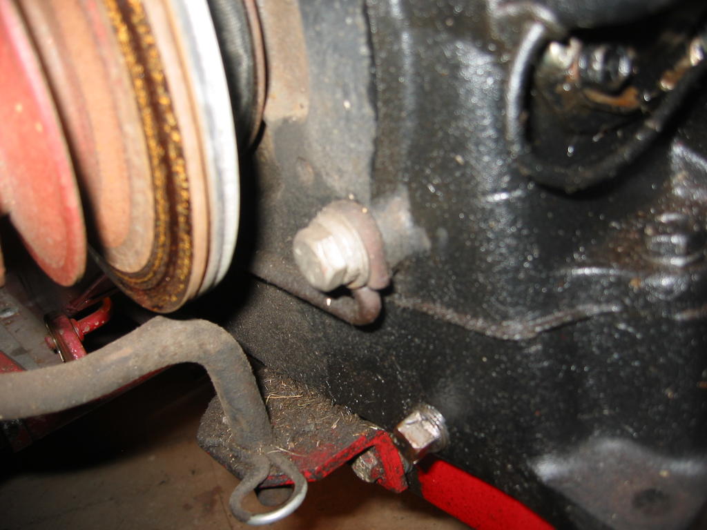

pfrederi 21,274 #8 Posted February 27, 2019 OK First look at the bent wire bolted to the engine block in the picture. The other end (Which I can't get a clear shot of) should be very close to the drive belt. 1/8" or so. When you step on the clutch the belt should get loose on the engine pulley and move forward a bit. It should not turn when clutch is depressed. Also look under the right side foot plate there is a flange bolted on the bottom the belt should be sitting on top of it. Incidental the clutch pedal positioning is adjustable to bring it closer to the operator for vertically challenges operators. Share this post Link to post Share on other sites

Vintner 17 #10 Posted February 27, 2019 OK, that checks out fine. the other end of that metal rod is about 3/16" from the drive belt, & the belt slacks off & kisses it when I push the clutch petal. Also, the belt is on top of that flange you mentioned under the right foot plate. Thanks for the tip about the adjustable clutch pedal. I'll look @ that if I ever let my wife use the machine again. She has a habit of breaking something or running over something whenever she's on it LOL. I suspect it runs along the same line as me when I mess up the dish or cloths washer anytime I use them LOL! 2 Share this post Link to post Share on other sites

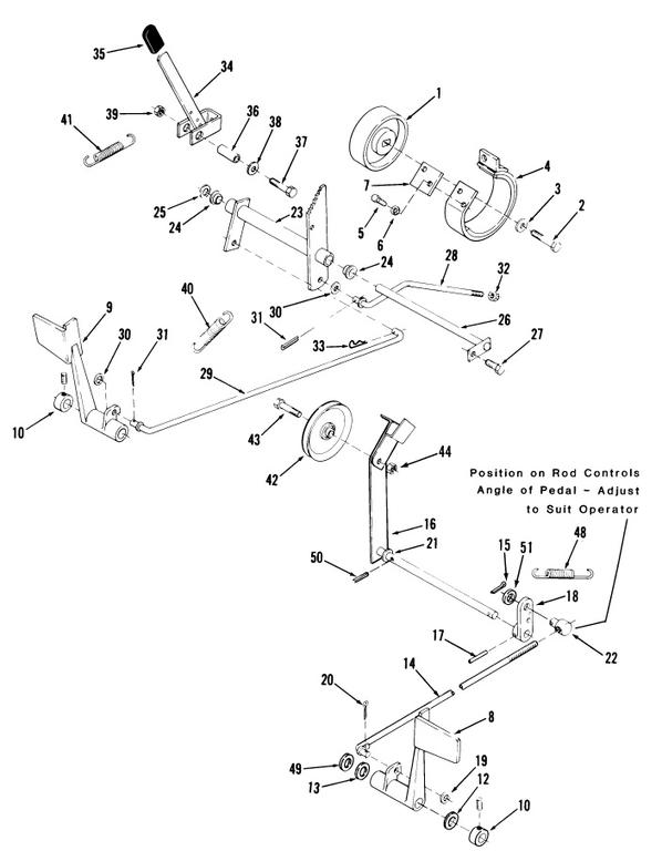

Ed Kennell 47,750 #15 Posted February 28, 2019 14 hours ago, gwest_ca said: Clutch pedal rod #14 is threaded into a #22 trunnion at the rear. Take the cotter pin out at the padel and you should be able to shorten the rod for a shorter driver. Garry It is possible the #17 pin is sheared and not releasing the belt properly. With the pedal up, put a line across the lever #18 and the shaft #21. Then push the pedal down. If the line is disconnected, the pin is sheared and must be removed and replaced Share this post Link to post Share on other sites
Vintner 17 #16 Posted February 28, 2019 6 hours ago, Ed Kennell said: It is possible the #11 pin is sheared and not releasing the belt properly. With the pedal up, put a line across the lever #18 and the shaft #21. Then push the pedal down. If the line is disconnected, the pin is sheared and must be removed and replaced I'm sorry, but I can not locate a # 11 on that diagram. Is it the fuzzy thing under the number 12? Or did you mean 17 instead of 11? In which case it could be 17 or 50. I will check them. I will look into adjusting the break as well. Thanks guys! Share this post Link to post Share on other sites
gwest_ca-(File Mod) 12,519 #17 Posted February 28, 2019 It is #17 pin. 3/16" x 1-1/4" spirol pin Much like a split pin but the metal has multiple rolls making it much stronger. The fuzzy thing under the #12 is an Allen set screw to secure the collar to the round bar. Item #50 is a 5/32" x 1-1/4" spirol pin and goes just through the rod to keep it positioned endwise in the chassis. Garry 1 Share this post Link to post Share on other sites
953 nut 70,057 #18 Posted February 28, 2019 9 hours ago, The Tool Crib said: What about the break adjustment. I know it sounds odd but my 855 did the same thing and that helped me from the gear grinding. There is a balance between each other. On the 300 series the clutch and break each have their own pedal and linkages. 1 Share this post Link to post Share on other sites
Ed Kennell 47,750 #19 Posted February 28, 2019 2 hours ago, Vintner said: I'm sorry, but I can not locate a # 11 on that diagram. Is it the fuzzy thing under the number 12? Or did you mean 17 instead of 11? In which case it could be 17 or 50. I will check them. I will look into adjusting the break as well. Thanks guys! Sorry, It is the #17 pin that I was referring to. Dang tired old eyes. I have bought several tractors that were probably parked because they would not go in gear and I discovered the #17 pin was sheared. I found it is easier to install the new pin if I drill and tap the lever for a set screw to keep the lever and shaft in alignment. I use a small pin punch to align the holes, then tighten the set screw, then drive in the new pin. 1 Share this post Link to post Share on other sites
