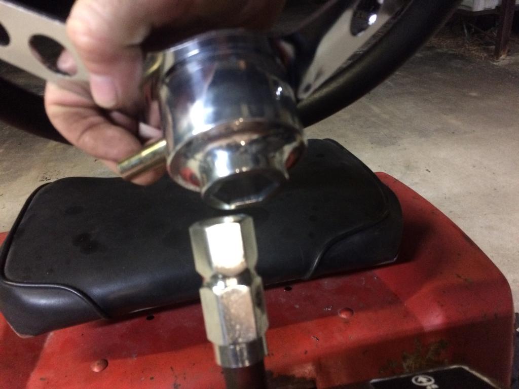

Hacksawhero123 351 #8 Posted April 25, 2019 I split mine with a grinder. The wheel was in bad shape, anyway. I replaced it with a generic Grant wheel using a dune buggy quick connect. Good luck. Mark 1 Share this post Link to post Share on other sites
