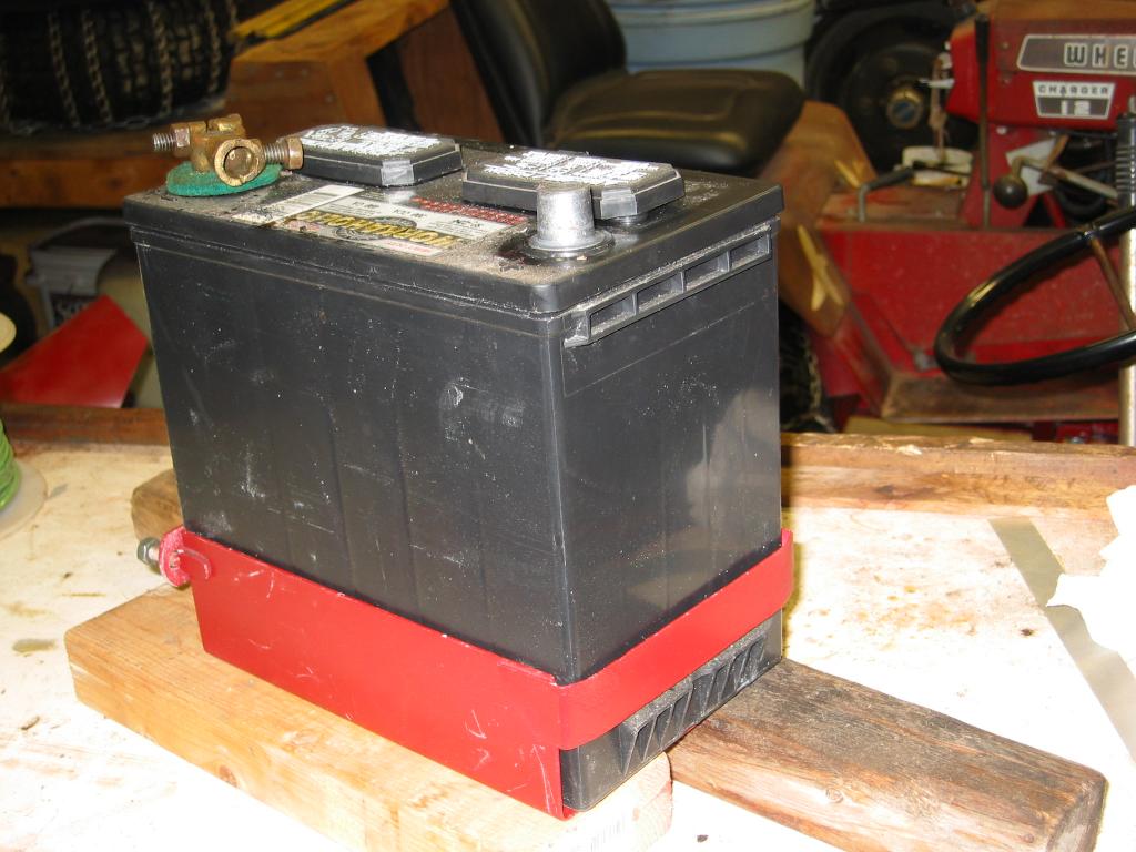

ZXT 2,402 #27 Posted December 1, 2019 6 hours ago, ebinmaine said: If appreciate that. Yes please. Here's what I have on the C-120. Exide Classic #51RC. Fits well with a little less than 1/2 inch of space on one side. Length is perfect on it. Doesn't move around much even though the retaining plate nuts vibrated off and dropped the plate somewhere. Apparently it is only 450CCA, though I thought it was 550. Cranks it well and has great reserve regardless. 1 Share this post Link to post Share on other sites

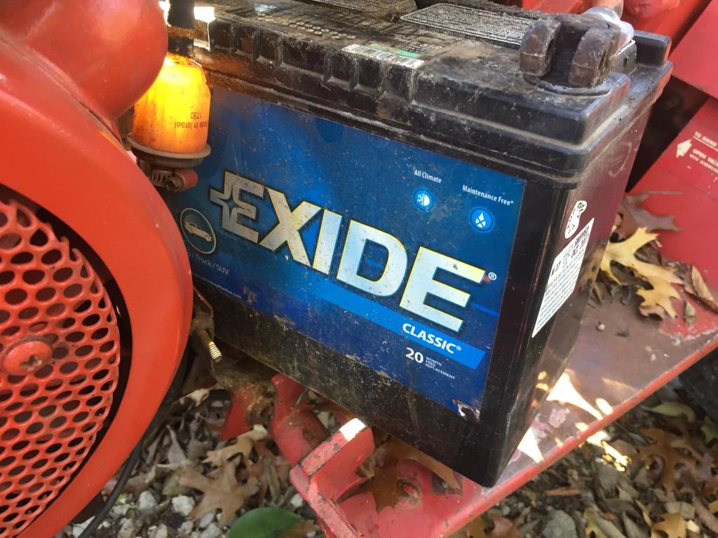

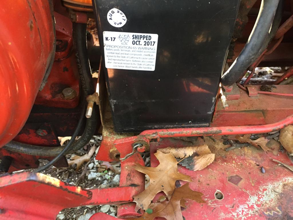

peter lena 9,942 #34 Posted July 14, 2021 @seven , couple of pictures , 1st one and last one , note, first note the " battery ground rail " next to the battery , last picture note the battery tender wire attached to choke cable , for easy battery plug in , also note the battery cable attached from engine block corner / frame area , that connects to the upper battery ground rail next to battery , those 2 improvements , have eliminated my ignition problems . easy to do , also use rough service light bulb in a reflector under engine in winter , keeps it just warm enough to easily start , pete 1 Share this post Link to post Share on other sites

peter lena 9,942 #37 Posted July 19, 2021 @paul414-8 , note first and last pictures , 1st picture , looking down on battery ground rail ,that battery grounds to , add another battery cable from that point , to the last picture , see the battery cable bolted to the corner of the engine ? that is increased grounding , it works , also note the battery tender plug in attached to the choke cable , makes charging very easy , personally think you are very close to quick starting , good luck with it , pete Share this post Link to post Share on other sites
