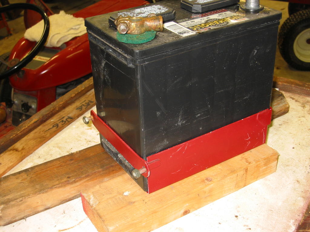

ebinmaine 79,685 #21 Posted December 1, 2019 On 2/23/2019 at 7:52 PM, seven said: Okay here is what I did I put in the biggest car battery I could find 20 bucks at the salvage yard its not pretty but it works Curious to know how you're doing with this battery. I need to buy something for the Cinnamon horse.... Any pics or group number information would be greatly appreciated. Share this post Link to post Share on other sites
Lee1977 7,709 #22 Posted December 1, 2019 (edited) Here you go. Huskee 420 cca in the C-120/180 from TSC it's mounted reversed because of how tight for room with the Vanguard. The 312-8 also has a 420 cca.The 520 has A Smart Start 350 cca that was in it when I bought it . Don't know where it came from. Edited December 1, 2019 by Lee1977 1 1 Share this post Link to post Share on other sites
ZXT 2,402 #23 Posted December 1, 2019 (edited) 5 hours ago, ebinmaine said: Curious to know how you're doing with this battery. I need to buy something for the Cinnamon horse.... Any pics or group number information would be greatly appreciated. My C-120 has a car battery on it. If I remember to tomorrow I'll get the group size if you're interested. Edited December 1, 2019 by ZXT 1 1 Share this post Link to post Share on other sites
ebinmaine 79,685 #24 Posted December 1, 2019 6 hours ago, ZXT said: My C-120 has a car battery on it. If I remember to tomorrow I'll get the group size if you're interested. If appreciate that. Yes please. Share this post Link to post Share on other sites
pfrederi 20,869 #25 Posted December 1, 2019 4 hours ago, ebinmaine said: If appreciate that. Yes please. See my earlier posting 22NF in the older WH larger battery box. Share this post Link to post Share on other sites
